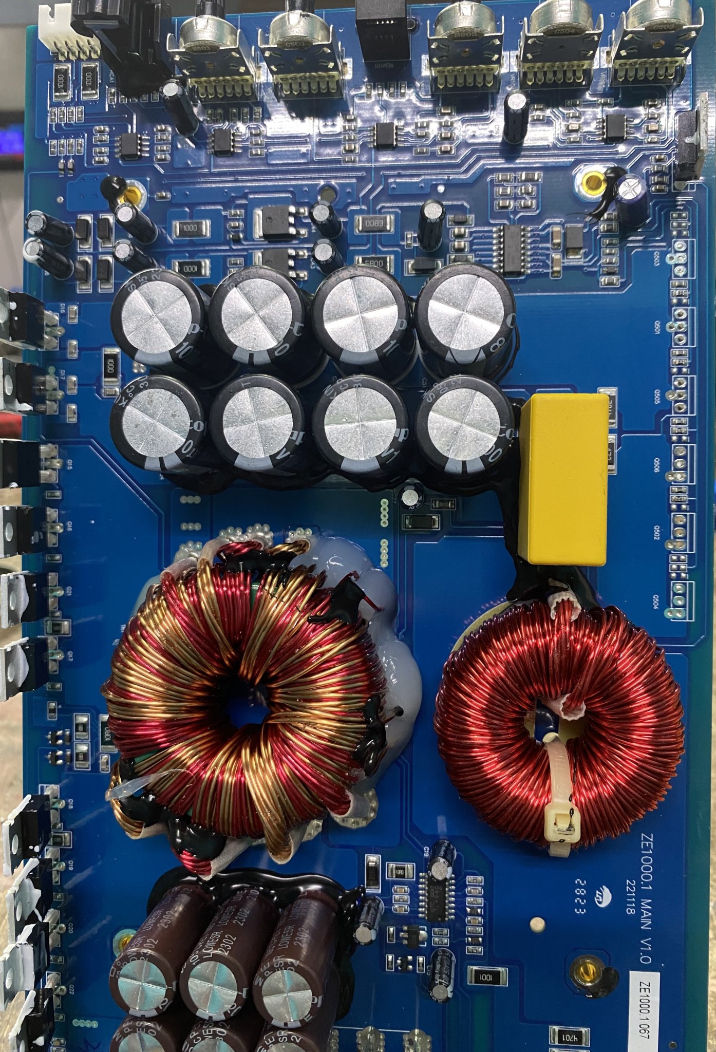

What are they using for gate resistors?

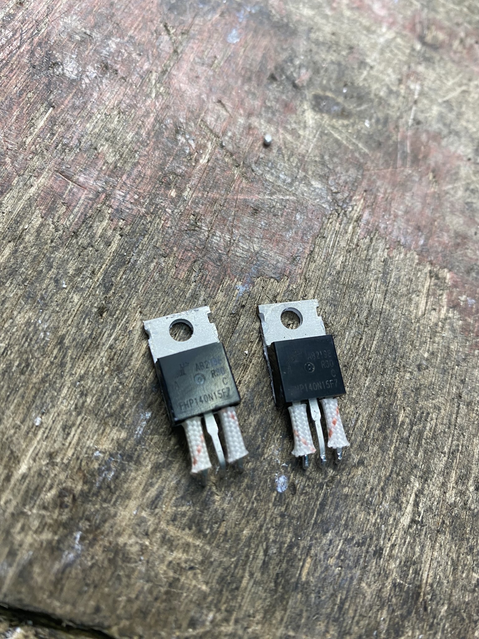

The first letter looks like a P to me but there even fewer returns for that.
$86 new for this amp?
I don't see anything that's similar. Maybe someone will have experience with a clone. If not, rail voltage (total across rails) may help find something that will work.
Ironically I'm trying to repair the same amp just to try my hand at amp repair. I'm looking for the same mosfet. (fhp140n15f7) Found it on a couple thai sites but can't figure out how to buy from them.
