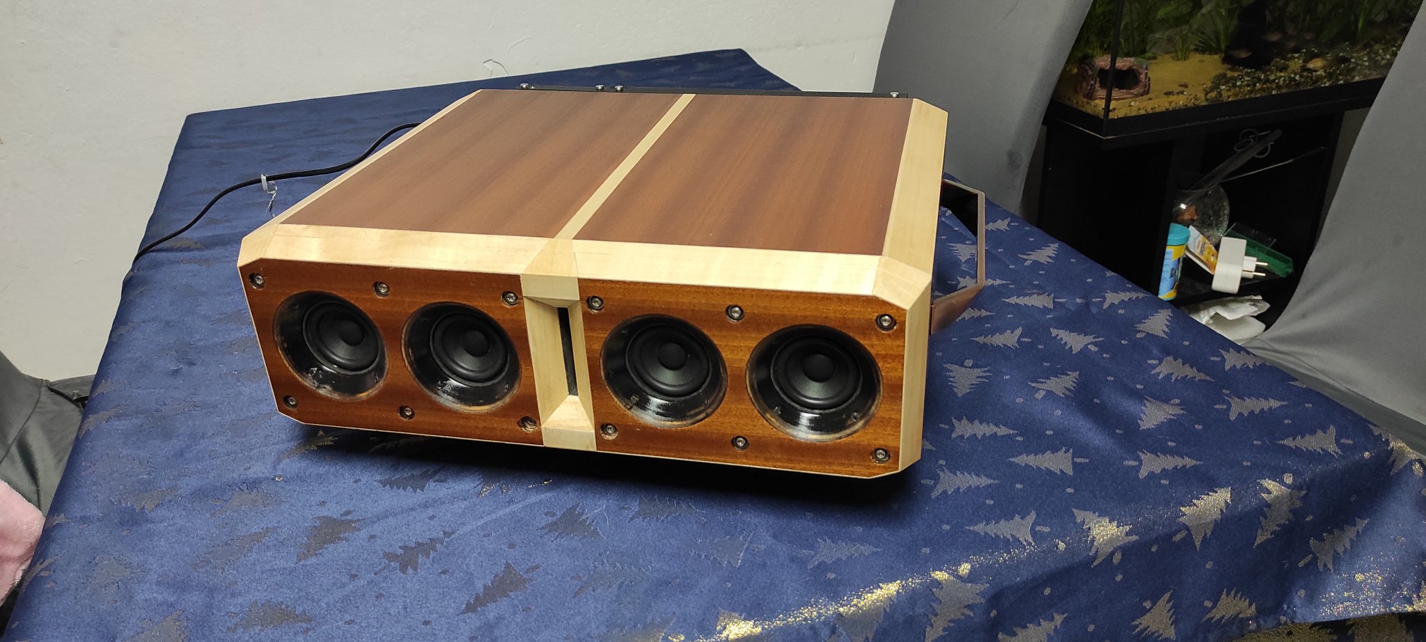

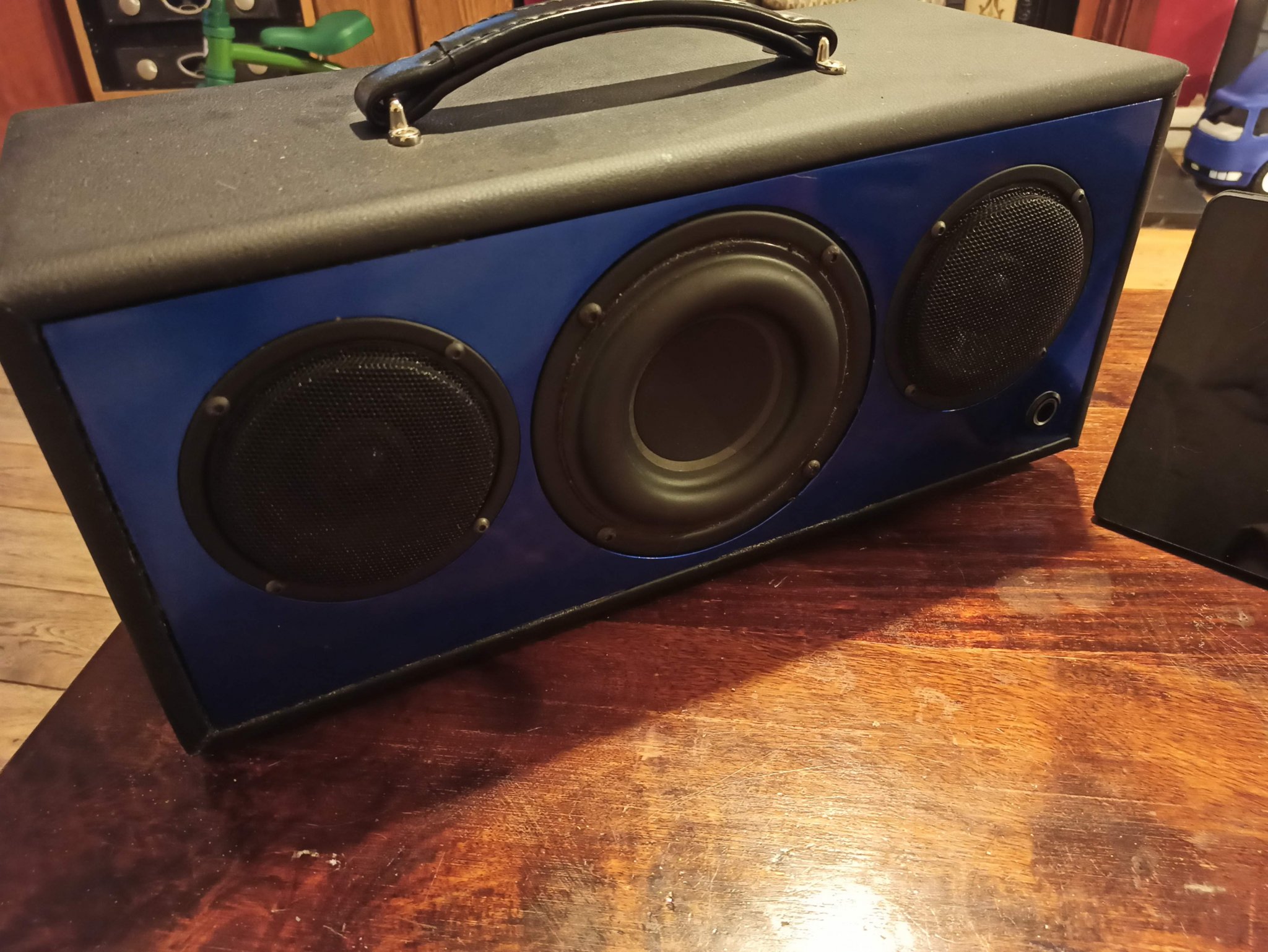

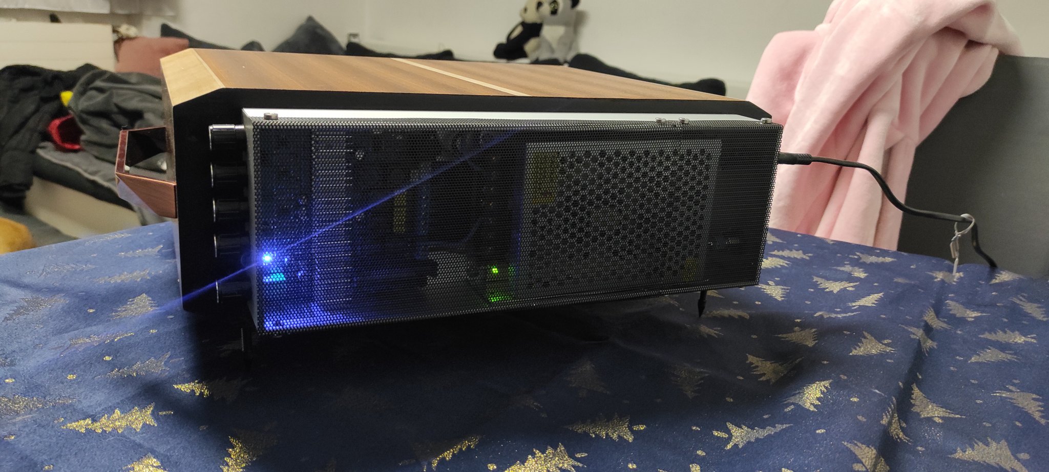

I built this one to keep me company at work
Altho theres 4x 2" Ayima fullrangers and a 4" down firing GHXAmp "sub" in 8 liter enclosure tuned to about 50Hz. The port is 32/36mm aluminium tube 100mm long. Full rangers have about 0.6 liter compatments per pair and the box is built with 15mm birch ply. The amp is 2x TPA3116 and 76W smps power supply.

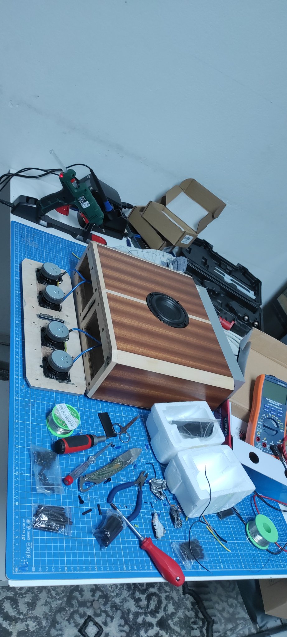

I'm building another similar one but with the W5-1138SMF and 2x Peerles 830986 full range drivers
