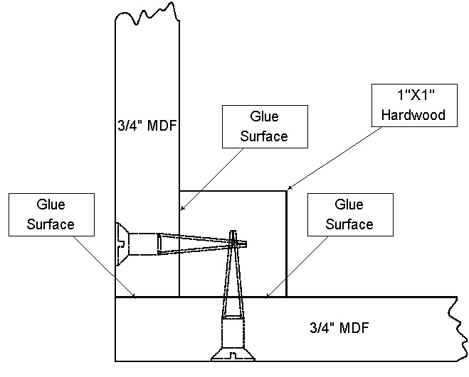

Hi Andre,
Good to see you're still at it.:up:
If you are using MDF and plan on covering it, you can make the joint like below.
