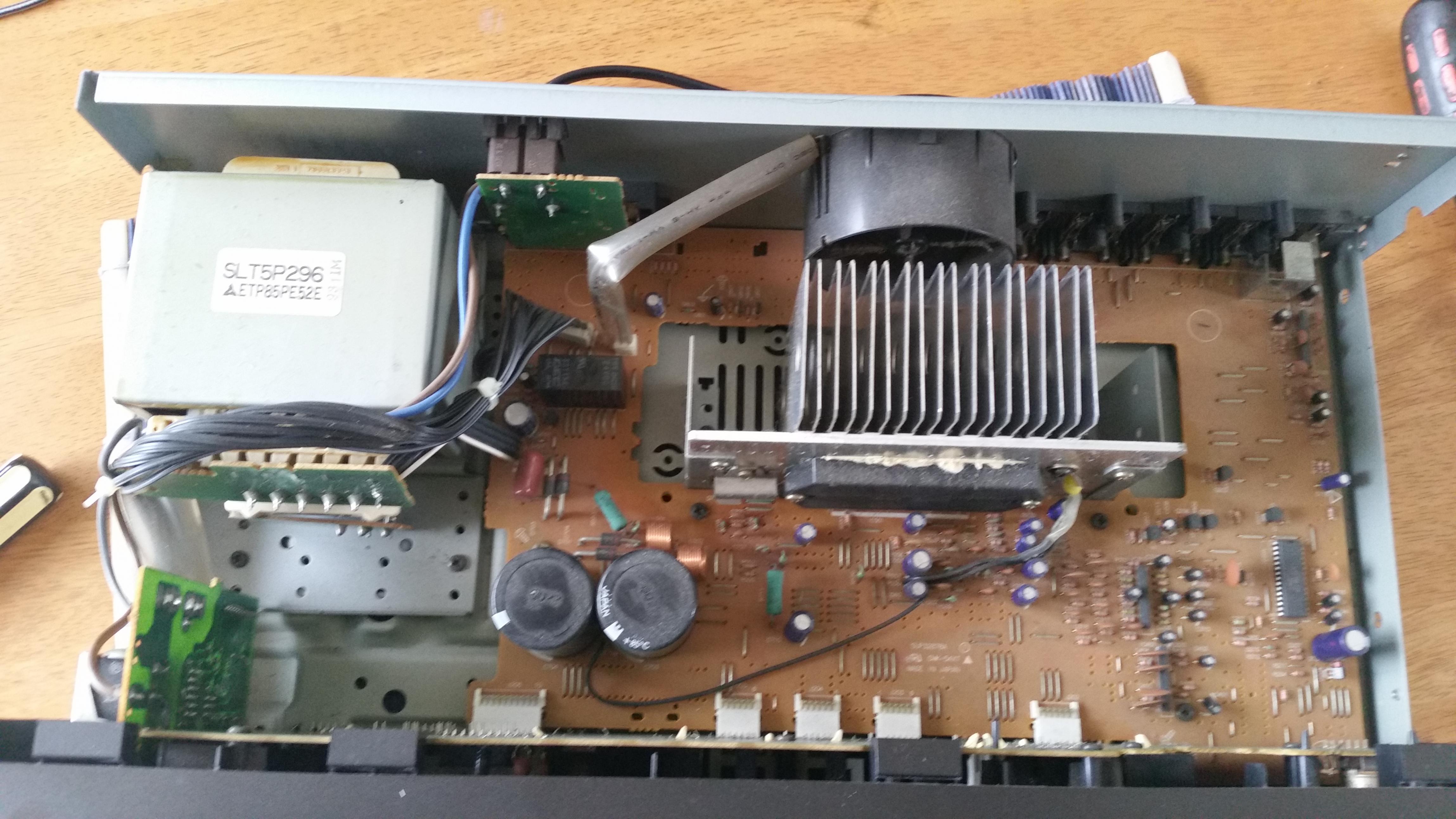

Hi All,
I have had this amp since new in the 90s.
whilst playing some music it stopped suddenly and the VU lights stopped working along with the sound to the speakers.
I turned the unit off. unplugged every thing except the power cord.

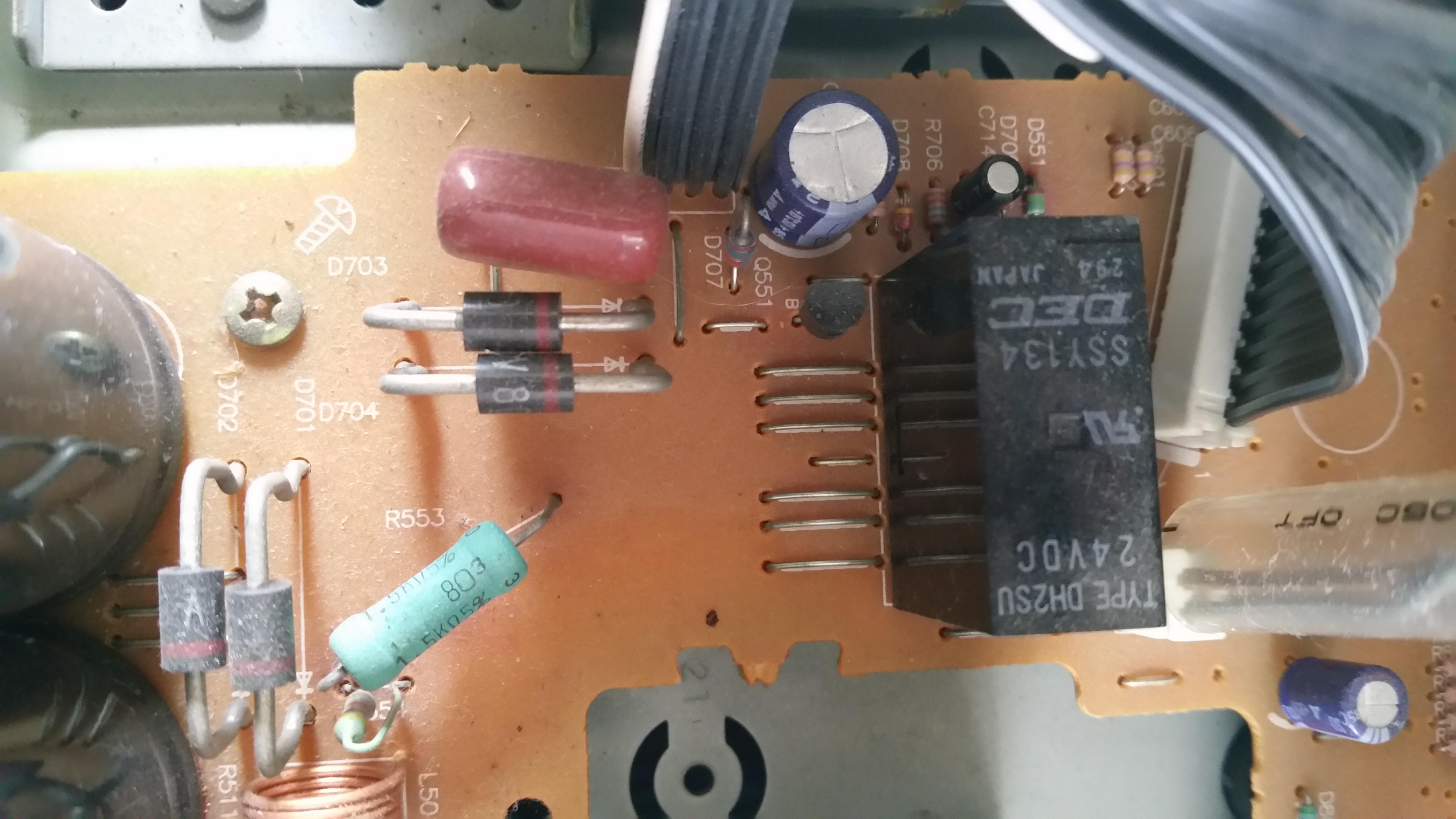

I turned it on again and all the lights came on, however the speaker relay has not clicked like it normally does a few secs after pressing the power button.
I took the cover off the unit and looked and smelled for anything burnt but nothing. The main fuse is of course fine as the power is on. There's a large chip(~50mm) and another 15mm connected to the one mammoth heat sink and a Fan off that. I can see the speaker relay ...well the only one there.
Apparently(from the user instructions) there is a protection circuit that resets itself after a speaker short or overload, but that's not helping as I've got every thing disconnected and I cannot see it anyway.
I tried connecting a CD source to the RCAs but nothing.
I tried the headphones jack, but also nothing.
I've read on this forum that the speaker relay might need replacing.
I've ensured that only one of the 2 speaker circuits is turned on.
I've checked that the VCR switch that diverts the input monitor is off.
there is no schematic on the operating instuctions so I am flying blind here.
are there any internal checks that I can make to help identify the components to replace ? like perhaps bypassing the speaker relay ?

thanks for the quick response Tom.
is the chip amp the huge one in the centre ?
so basically I'm checking for 24vdc to trigger the relay ?
I'm presuming I get at that from underneath...so removing the board from the casing ?
Not really. You'll probably find 0 V at the relay. That's why it doesn't go click. Your task is now to figure out why it doesn't go click. Reasons include:

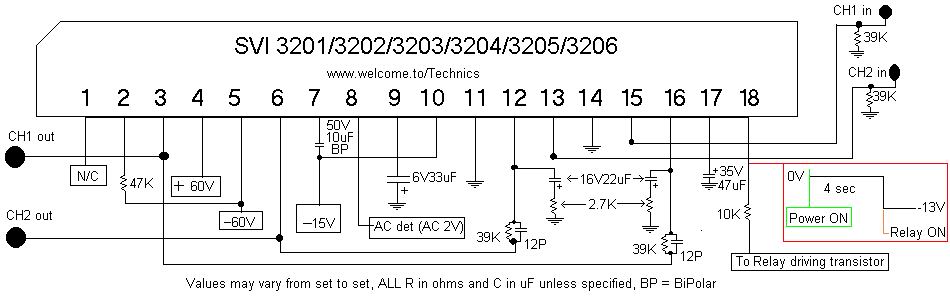

I googled "SVI3205 datasheet" and found this schematic (click for larger view). That's probably how your amp is built.
Note the relay driver signal on pin 18. Measure to see if you get the waveform shown (0 V at power-on and -13 V after a 4-second delay).
Also measure the power supply voltages on Pin 4 and Pin 5. You should see a symmetrical voltage, so, say ±60 V as shown above or ±45 V. If you see, say, +45 and -0 V, there's a fault in the power supply.
If the power supply looks good, measure the output of each channel on pins 3 and 6. Should be 0 V.
Measure the voltage on Pin 10 (-15 V -- I wonder where this comes from).
Measure the AC voltage on Pin 8.
It looks like a pretty interesting module. Notice the four power transistors on large metal slugs to get rid of the heat.
pin 18 is 0v always.
pin 4 is- 65v pin 5 is 65v
so power supply is okay but I seem to have dc voltages at the pins 3 and 6 which is a good reason why I have 0v at pin 18....but why I wonder.
pin 3 is -55v pin 6 is -42v
any thoughts on these.
Pin 10 is -14.7
pin 8 has 1.1v AC

What's the input DC voltage on pins 13 and 15? If you have DC there, you should have DC on the output if the amplifier module is DC coupled (which I don't know if it is).
You should have 0 V DC on the amp input (pins 13, 15). If you don't, we should figure out why. If you do have 0 V on the inputs and get DC on the output, your amp module is fried.
And yep. The DC on the output is the reason the amp module doesn't assert the relay control signal. The protection circuit is doing its job and protecting your speakers from the DC.
pins 13 and 15 have 0v and -19.6v DC
its not looking good for one of the channels as the zero on 13 shouldn't have DC at its output as you said below

pins 12 and 16 are connected to pins 3 and 6 output channels via the RC parallel circuit. so I measured these as well.
so pins 12 and 16 are 7.1v and 31v respectively. I'm kinda hoping at this stage that the DC at one channel's input is affecting how the other channel generates its output from the zero input on its channel, but I'm just being hopeful.
any thoughts on what next Tom ? I'm thinking one channel is fried...but hopeful the DC on the input of the other channel mitigates this
Tom
Unless something is wrong in the preamp section that causes DC on the input of the amp module (that's doubtful as it appears to be AC coupled), my money is on a dead amp module.
You could try to trace the connections from the input pins of the amp module back towards the preamp/tuner section. If there's a capacitor in series with the input, de-solder the two input caps. Just make sure the amp has a resistor to ground (like the two 39 kΩ shown in the schematic I posted in Post #7). Power up. If still no relay click, the amp module is dead.
