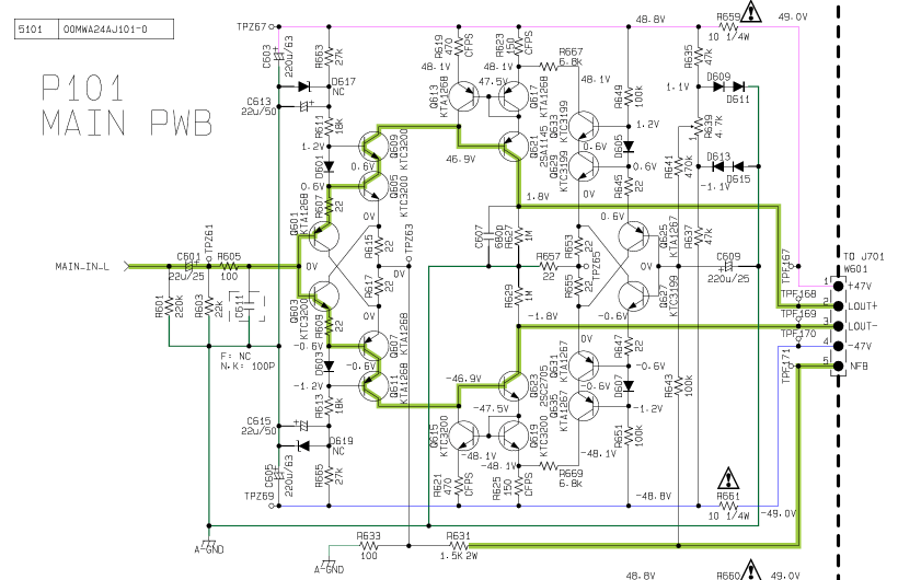

Hi all. I'm trying to better understand the changes that Marantz has made to their same basic symmetric design that they've used for over 20 years. What has actually improved, and what were just manufacturing decisions based on the parts available and power efficiency?
Note that this not an HDAM discussion which IMO was just their injection of proprietary IP into an amp that I can otherwise build myself.

PM6006 (AND PM6007 AFAIK) - 2016-2020
So what exactly have they done that's good?
I ask because I wonder what I can learn to improve my own symmetrical builds. Why do even their latest flagship models not thermally couple each transistor stage?
Many thanks
- Eliminated most diodes from the signal path? Is this to reduce noise or is it to save power from Zener leakage?
- Added DC offset control? Is this for idle power savings as well?
- Added series transistors (Q6007-Q6011) in the input stage? Why?
- Switched from a darlington to a regular high-gain bias transistor?
Many thanks
