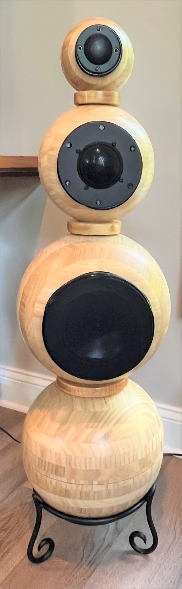

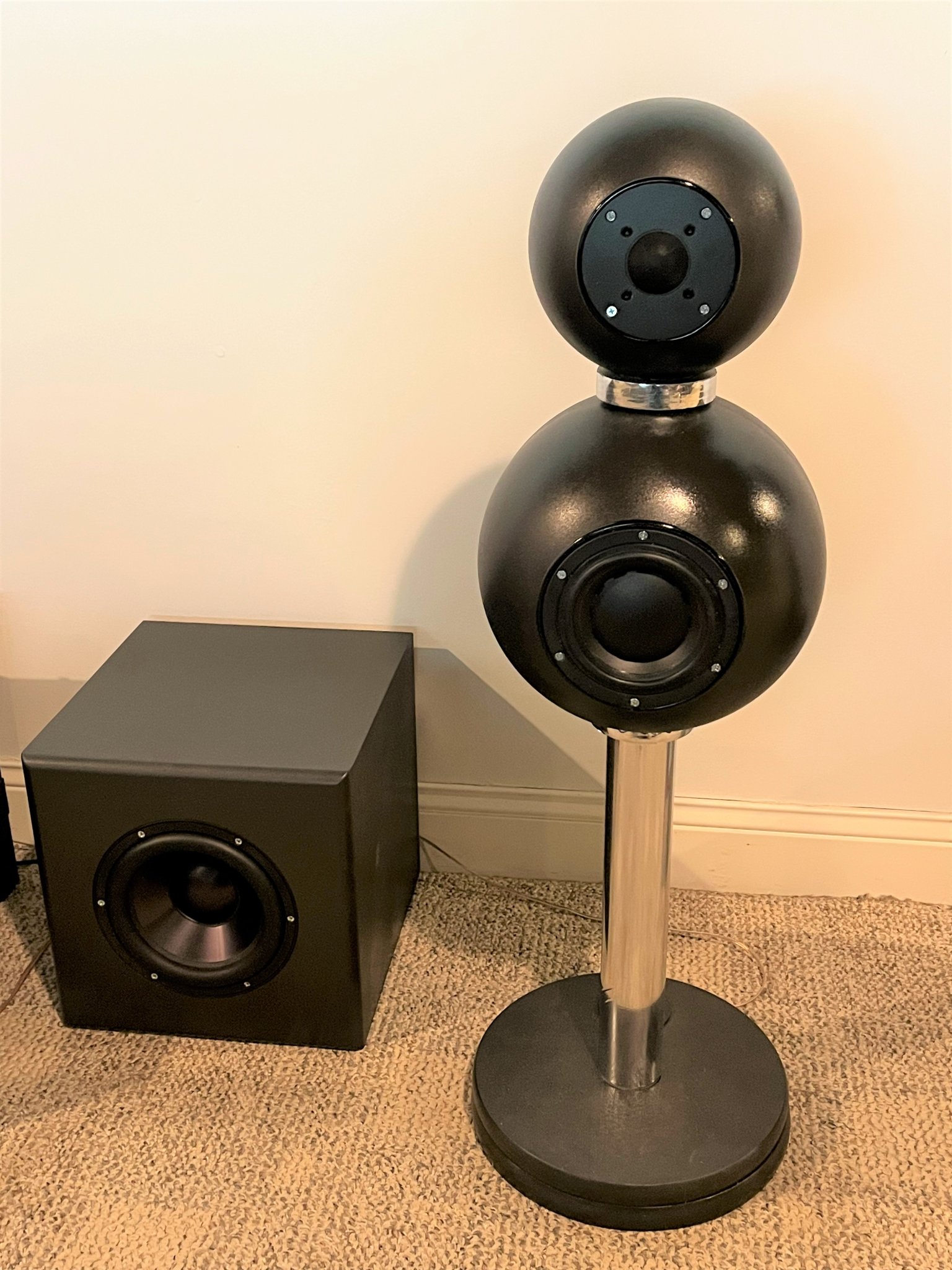

I have built two pairs of spherical speakers, one a 2-way (with separate sub) and one a 3-way with integral sub (so 4 spheres). I used Ikea bowls which are made of bamboo (very rigid) and are 3/8" thick. Then added a 3-part damping system using speaker cabinet paint on the inside, thin felt glued in, and fiberglass inserted. And mounted with a center pole. No standing waves and no resonance. No need for other internal bracing. Even with a 6 1/2" sub, the larger (11") sphere does not audibly resonate. In order for a sphere to resonate it actually has to pulse in and out, almost impossible. Meanwhile a box cabinet can have vibrations both in the panels and at the joints. Plus you get the benefit of little to no external diffraction.
Cute speakers!
Enclosed volumes of any shape resonate.
Tap on an empty sphere, easy to hear it resonate (ring) for a long time.
Your 3-part damping system reduced the sphere's resonance time.
