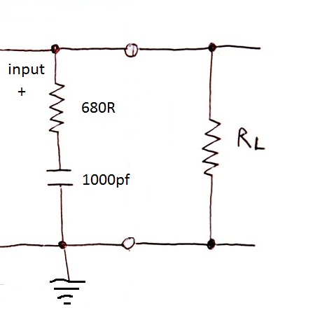

I've had this problem on and off with a NOS SAE1000e for a while now. The cartridge produces incredibly loud white noise when on the tonearm rest, but only with the Pearl 2. It's quiet with other phono stages. When the stylus hits the groove the noise quiets down.
It also makes strange sounds and loud snaps when the TT muting kicks in and out. Pulling one RCA cable kills the noise, and touching one of the signal terminals quiets it.
It only happens with the combo of the Pearl 2 and this HOMC cart. The cart is fine on other phono stages, and other carts are fine on the Pearl 2.

Here's an update on my troubleshooting -- The noise seems to be related to C22. I have these caps in sockets now, so I can vary the load on the cartridges.
When I pull C22 from the right channel but leave it in the left, the noise goes away from both channels. If I pull C22 from the left channel, the noise stays in both channels, regardless of whether C22 is in the right channel or not.

So if you pull c22 from the right channel, the noise goes away in both channels, and if you then also pull C22 from the left channel, the noise returns in both channels? ( I might have misread)
I would try soldering C22 in both channels to see if that works. Or alternatively, try without C22 in both channels (cable capacitance ot the TT interlink mightbe enough). I have silver mica ones in my Pearl.

It's so weird, I've had to stop using the cartridge. It happens with three different turntables, and the cartridge is fine with a different phono pre (an ART DJ). And the Pearl is fine with several other MM cartridges.
When the SAE is first connected, there is a continuous blast of white noise. Touching the stylus with a brush or dropping it on a record stops the noise, but it continues to make weird noises while playing.

To update everyone on this, there is indeed an incompatibility between this cartridge and the Pearl 2.
I sent the SAE to 6L6 who confirmed the problem existed with his Pearl 2 as well. He contacted Wayne, who recommended a simple fix -- a "Zobel" network consisting of a 680r resistor and 1000pf cap in series across the inputs. Apparently the high inductance of the SAE put the JFETs into oscillation, and the Zobel prevents this.
Wayne mentioned that all Pass gear has the Zobel network installed.
So I can now enjoy this fine cartridge thanks to 6L6 and Wayne. 6L6 even provided the caps and resistors when he returned the cartridge!
