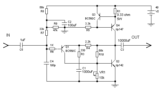

Rod Elliot said it quite loud in his Death of Zen power amp page. It's the test circuit he experimented with; using an NPN darlington as the power device and an 8ohm resistor as the current source. He seems quite unsatisfied with the output of this amp at its original state and noted that there will be chages in the final circuit. There were big changes including the omission of the darlington as they are slow. Everything went fine and the DoZ amp was born. I have made a couple of DoZ and it's an exceptional amp with unmatched sound quality, I like the amp. Link> Death of Zen - A new Class-A power amp
So far so good.

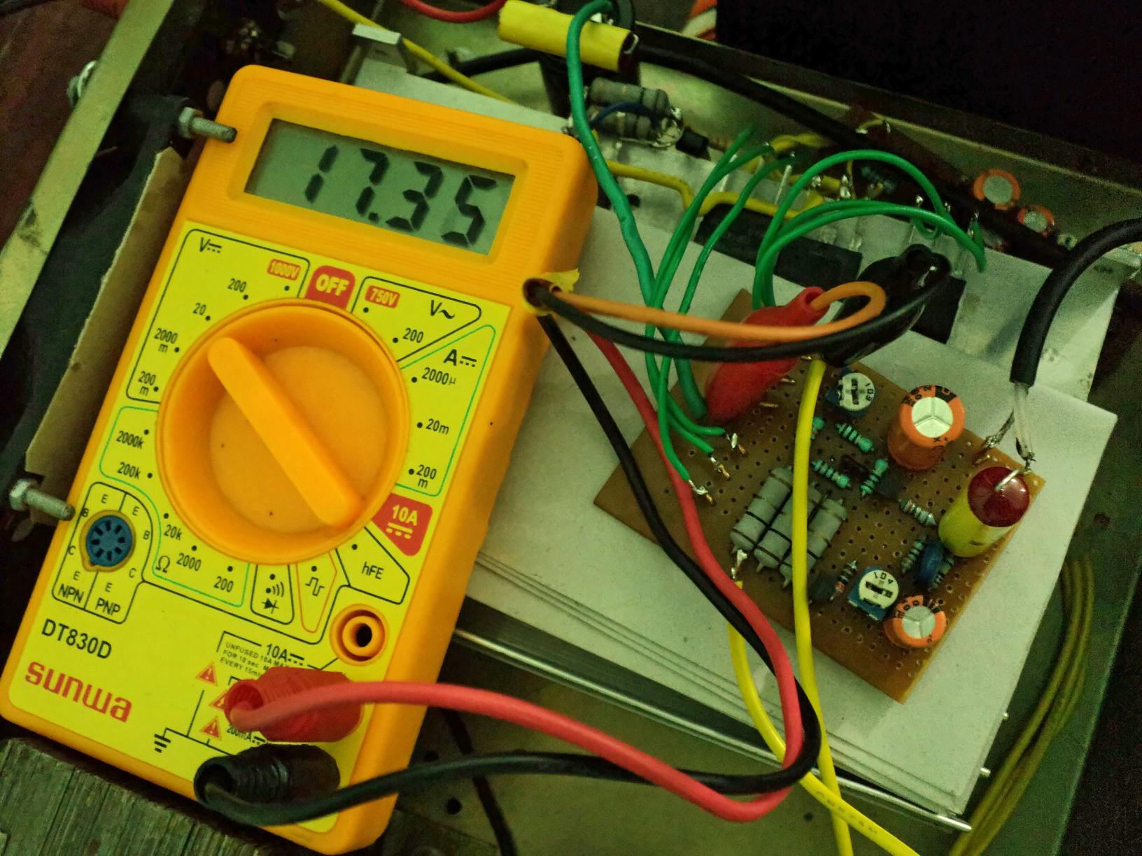

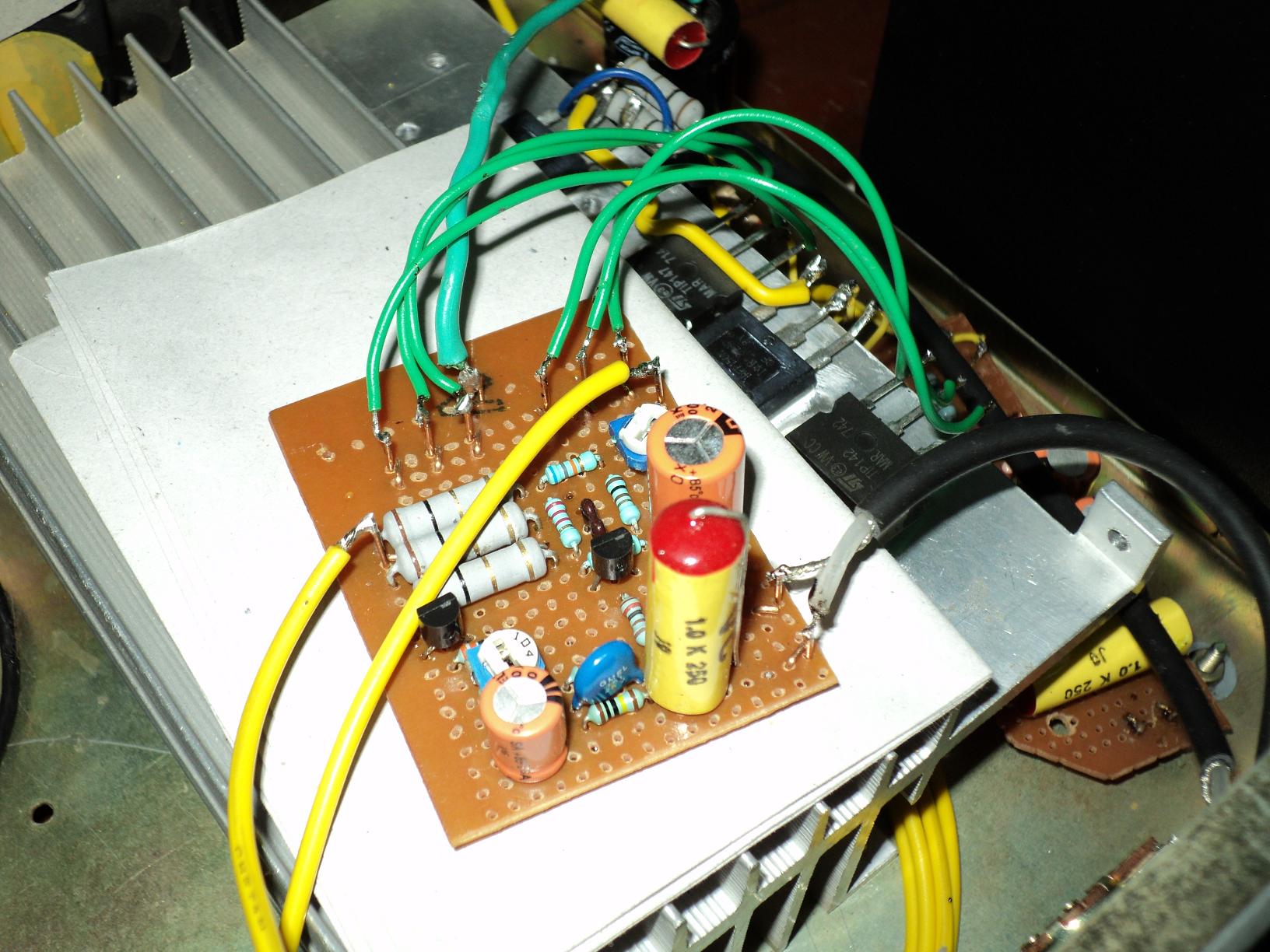

A couple of days ago I was going through that project page again and got stuck on that "STOP!". The test circuit seemed to me as workable with only the addition of a constant current source in the place of the 8ohm current source resistor. I added one, following the way the CCS is designed in the DoZ Preamplifier, using a PNP darlington and a BC560.

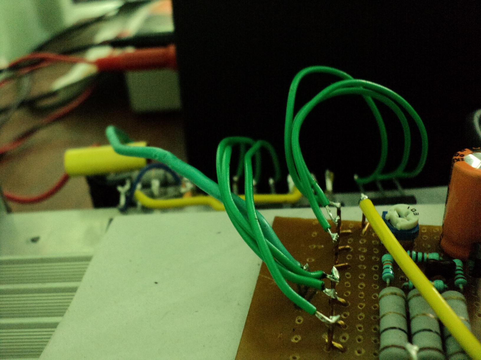

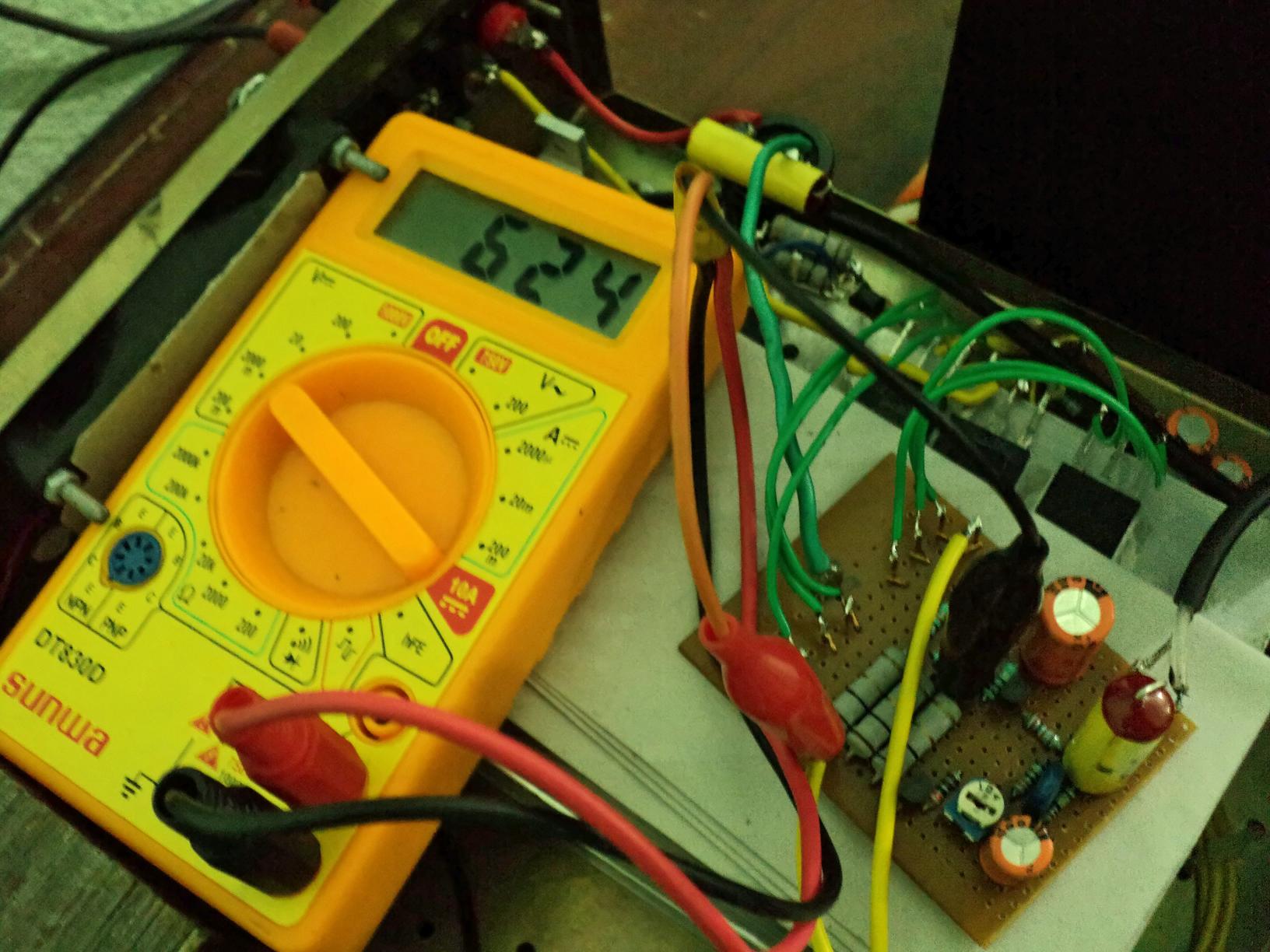

Expecting NOTHING special I assembled it and powered it up.
The amp really sounds nothing special, EXCEPT when I start varying the VR1. Damn funny things start to happen while I increase or decrease its value. Rod explains how the amount of distortion in this amp's output almost directly relates to the value of this resistor.
What I felt was that when the resistance of VR1 is set to high, the amp starts creating strange clipping behaviour, which sounds good to me when there is a little of it. Of course too much of it makes the sound gross and low volume and at 10Kohm almost nothing is heard.
The main source of fun right now is this resistor. At high, medium and low value this resistor makes this amp sound Distorted like an overdriven valve amp, Sweet like any SE amp, and Clean like a Hi-Fi respectively. You get the idea.

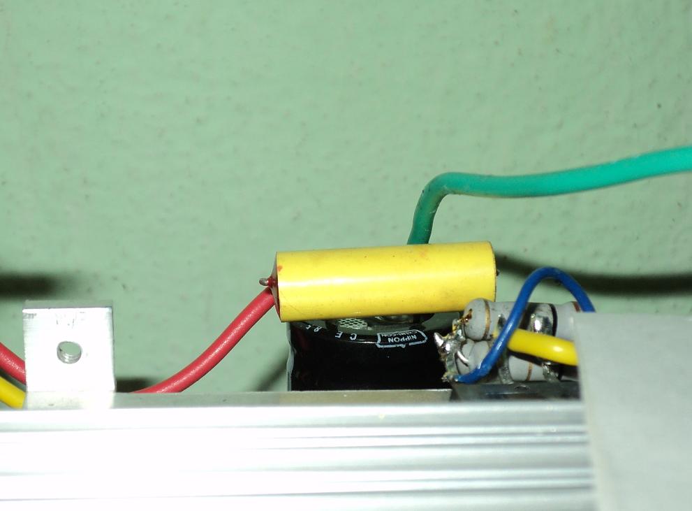

Currently I am not in the mood for that much of testing, with direct coupling or split supply etc. Actually I really love what comes out of that NipponChemicon output cap, kinda wanna keep it there...

Without feedback, VR1 would simply be setting the output bias, and hence the output quiescent voltage. Too high or low means distorted output as one of the devices would be either cutting off or bottoming.
With feedback, the main result would be to adjust the current through the input transistor and also vary the output voltage (but with smaller variations than before). So the wrong setting can cause assymetric clipping in the output stage, or non-linear distortion in the input stage (partly offset by the negative feedback, which will generate higher-order distortion too).
A rather strange circuit!

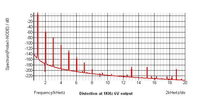

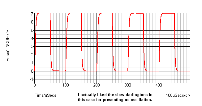

Yup quite strange. Tech details aside, it sounds (or at least simulates) very clean (as much as is usual for SE amps) starting from about 5Kohms and at about 1Kohm or so it's turned off.
The squarewave sim is of 10khz.
Yes I'll upload the realworld tests too.

How is the circuit without feedback, as feedback (R) is needed by first transistor to get current (CFB)? Do you mean to connect this to some voltage reference instead of output?
Ervin L
I didn't say it was without feedback. I meant that if it did not have feedback then VR1 would simply be setting the output bias. As it does have feedback, the result is more complicated.
The early posters seemed puzzled by the effect of VR1. I was explaining what it does. When explaining a circuit, the presence of feedback can confuse things so it is often best to mentally break the feedback loop, explain the circuit, then impose the feedback again to get the full picture.
