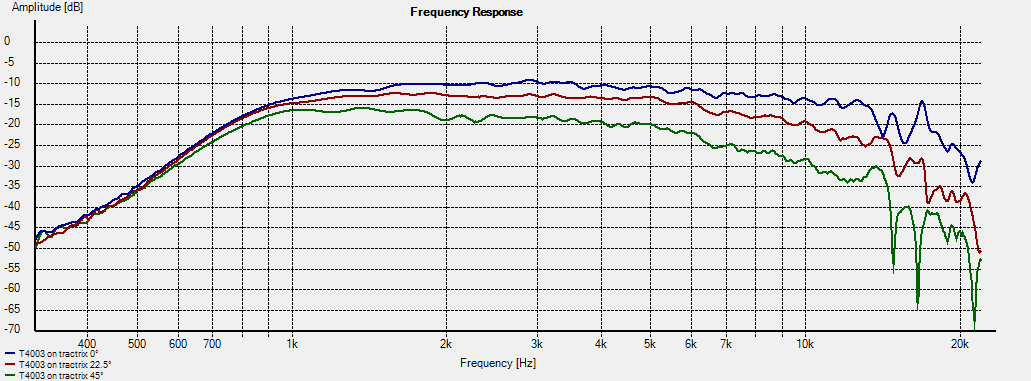

They are one of the few (only?) manufacturer that will actually build a horn with the correct throat size for the TD4003 (39mm vs 38.1 for JBL 1.5" compression drivers).
In my experience they are easy to deal with and their products are great.
Here is a measurement of a TD4003 on the 400Hz stereolab tractrix horn (600Hz HP + protection cap)

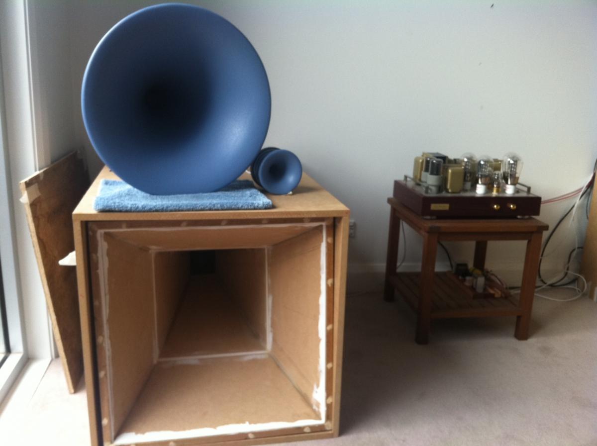

I've enjoyed the Stereolabs 250Hz horn and 1000hz horn, using 2-inch massive Selenium driver and smaller 1-inch driver.
I found the horns to be very good....and they compare favouably to Altec 511/811 and other horns.
I then moved onto Yuichi horns...and now enjoy Azura 340Hz.
