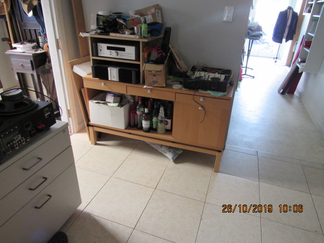

Here's an awful picture of the IKEA cabinet.
It is being used as a horizontal surface at the moment due to renovations work
I can see this as such a console
It stands 750mm tall
420 deep / 470 high / 1400 wide all external

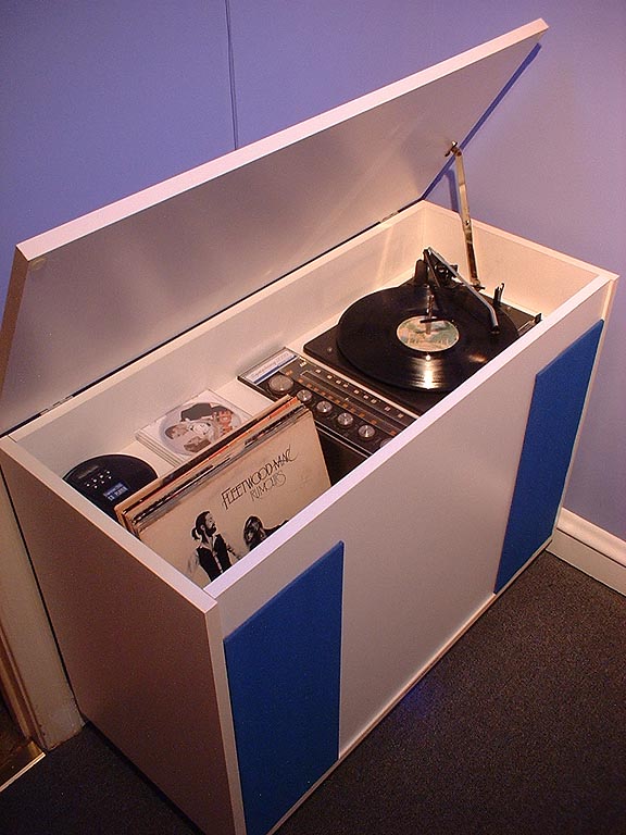

Back in 1999, I custom built a stereo console.
I wanted to do something "different", with a different look.
Introducing the "Symphony 2000 Deluxe" console.
White melamine finished cabinet with blue highlights...
Garrard 3600 record changer w/Pickering magnetic cartridge...
Receiver taken from a 1970 Zenith console and highly modified...
CD/R player...
6.5 inch woofers in ported enclosures plus dome tweeters...
And.... featuring a "one touch" motor-driven top lid! (Dyna Lift).
