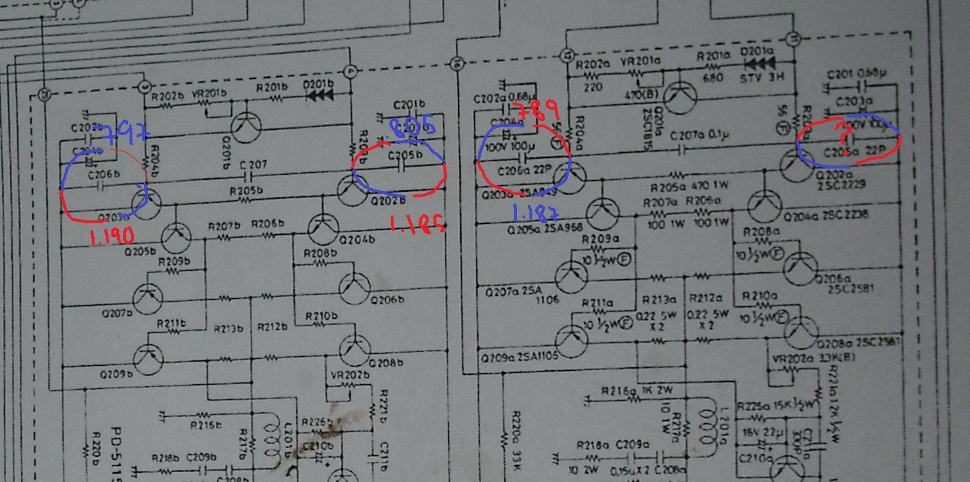

Here's part of the schematic, with some added artwork, showing the amp main boards for both channels - the one on the left is fine, the one on the right is not.
Highlighted are 4 caps which are all the same, being used in the circuit in the same way. With DMM set to the 2m ohm setting, all of the caps measure (in circuit) around 0.8 one way, and about 1.2 with the DMM leads reversed. The readout is stable, and does not move up or down.
However, the one on the far right measures differently. The impedance climbs as if you were measuring a medium sized cap by itself. With the leads place in either polarity, the impedance will eventually climb over 2m ohm. I have taken some of the nearby parts off the board to measure, (q202, q204, c201, c203) and they all check out.
Any ideas?

I traced the problem with the mystery impedance to a bad power supply connection. But the performance is unchanged - it still has the same horrible distortion problem. Im going to switch the connections from the input boards and see if the problem stays in the same channel or switches sides. That way I can determine if the problem is in the input section or the main section. I hope its the main - the input board is way tighter.
