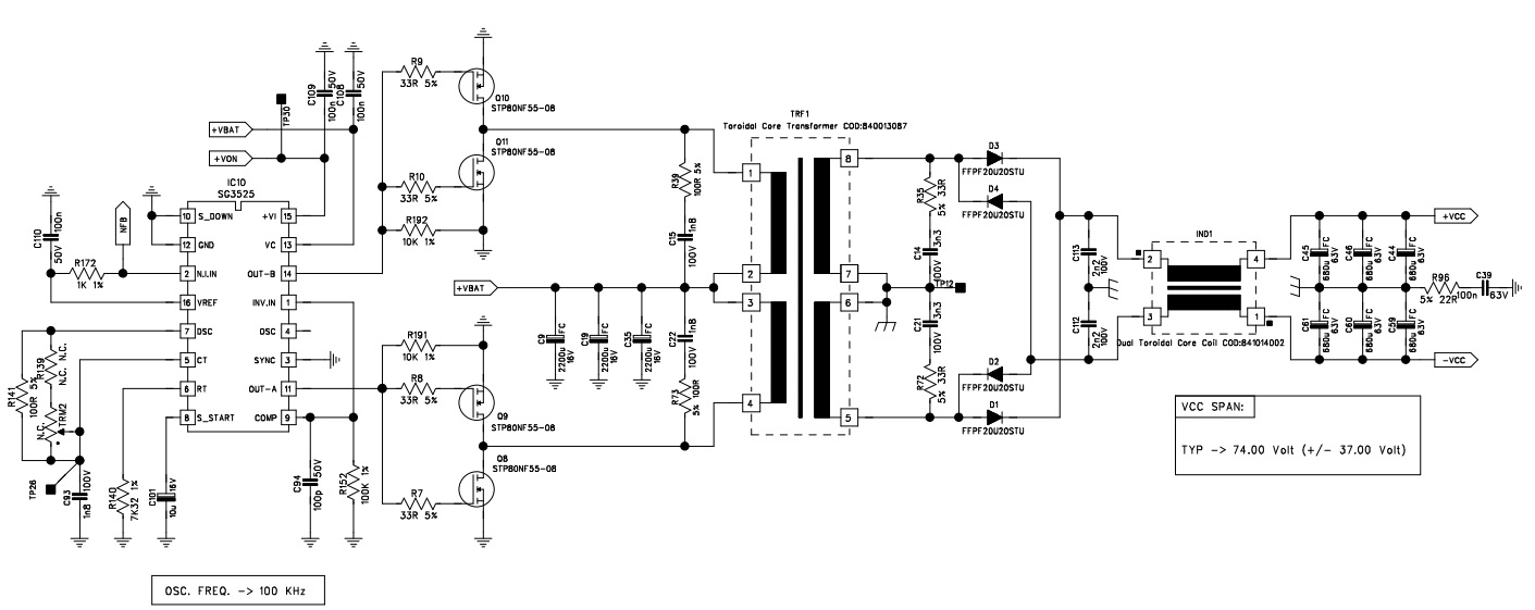

Steg K2.02 Supply MOSFET Substitute

It`s the first real Car Amp i try to repair.
I know you wrote, start with cheap one`s but this one is lying around some time now and i wanted it to be fixed

I have performed this very repair. IRF3205s and 47 ohm gate resistors I believe. I did stress test it at 10 and 15 volts. No problems.
