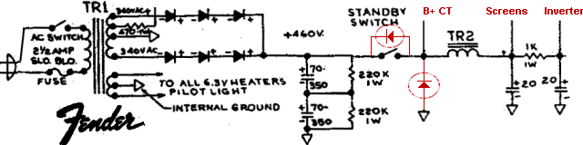

Standby Switch + 2 diodes
Can someone comment whether the 2 added diodes in red are a useful addition?

That type of standby switch has been typical in most Fender and Marshall classic amps. How about just putting a 2W 220K resistor across the standby? Merlin recommended 47K 2W but I can't see that working well in the long run. What happens when you apply signal in standby. I guess the 47K will act as a fuse now that I think about it.

To burn out a 2W 47k resistor the output stage would pretty much need to behave like a short circuit to ground. But it can't, not least because it will be operating under starved conditions while the 47k is in place. The 47k will last forever. But you can use a different value if you prefer.

I agree, switching the AC just before the diodes is a better option.
Why would Fender (then Marshall and others) do it that way?
Single pole switch was cheaper than a double pole. Fender built to cost.

There are two plausible explainations for the added standby switch. One is that is helped to protect the power supply capacitors from excessive voltage before the valves start to conduct and pull the voltages down to normal levels. Fender often used a reservoir capacitor rated for higher voltage than the smoothing caps after the standby switch, which must have saved money and space. Take a look at the 5E6 Bassman for example. The 135 Bassman schematic even shows labelled voltages, exceeding the cap ratings during standby.
The diode pointing up is the 'Free Wheeling Diode', a place for inductor current to reference when the switch is opened. These are commonly found on switch mode PSs, not common in toob ccts. Just some insurance for the switch. In Olde ccts there would be an RC combo to damp the arc that eats switch contacts while switching DC.:)
Not sure why the diode across the switch, its unlikely the the RHS will go higher than the LHS, even tho the volts across L might bang around a little. But the vertical diode clamps that point.
Set scope to single shot, set the triggering, than watch the transient on switch off. Some examples here in the pile.
