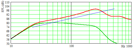

Hi mortron,
I see that you built the ubiquitous MJK Goldwood frame. If you look at its response without a xover, it is the red line in the diagramm:
The same driver in an infinite baffle would have a rather linear horizontal response line at ~94 dB in this diagram. If you put a driver in a OB, it will develop a dipol peak at 6dB above the infinite baffle response and a 6dB/octave roll-off below that peak.
The dipole peak is at 200-300 Hz and the roll-off below 200 Hz. The blue line marks a 6 dB/oct roll-off. I put it below the actual response, because I didn't want to clutter things. The Goldwood in its frame follows it down to ~25 Hz. Why not lower?

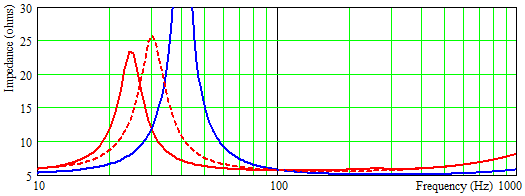

Look at the impedance curves for the Goldwood in infinite baffle (dashed red line) and in the H frame (full red line):
Both impedance peaks are at the resonance frequency of the driver. For the IB it is the advertised 30 Hz, the H frame lowers it to about 23 Hz. You don't want to EQ a driver in a dipole below its resonance frequency. So this is the lower response limit.
The green line in the upper diagram shows the application of a second order low pass filter at 60 Hz. MJK recommended a 100 Hz xover frequency to have a linear response over most of the range. 60 Hz is a bit too much, but this is only a simulation. Notice how you dont get the full 12 dB/oct of a 2nd order filter. You compensate the 6 dB roll-off, but don't have an additional full 6 dB - it's more like a 9 dB/oct filter.
Above simulation does not yet include the floor influence. I come up with that and the added Visaton later.
Rudolf

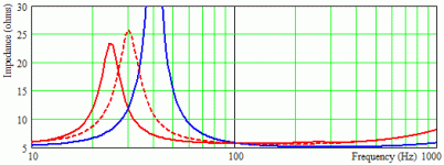

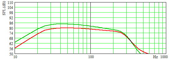

Since we are talking about such a dry topic, I try to keep the discussion wet
How does the response of the H frame change, if we place it on the floor? Red is the response without floor, green is with floor:
We get a gain of 6 dB at the lowest frequencies, which dwindles with rising frequency. May be we like the bass boost - may be not. In the last case we would have been better off with the 100 Hz low pass.

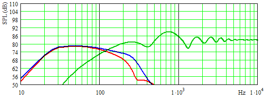

Now to the Visaton in a 20x20 inch OB:
Continuing from the previous post ...

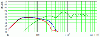

Red is the B 200 response with the 250 Hz highpass. It is 10-12 dB louder than the H frame on the floor (green) and needs to be attenuated - like in the blue line.
For the next diagram I moved to 3 m distance from the loudspeaker. Blue is the lower H frame, red a second H frame above the B 200 and green the B 200 itself:
Floor reflections are better visible now: For the upper H frame at 300 Hz and for the B 200 at 400 Hz and upwards. We need to add up both H frame SPLs for a combined response, that will be 3-6 dB above the single lines. It will probably be better matched to the B 200 in level.
