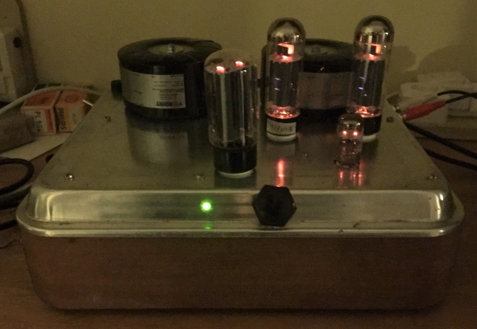

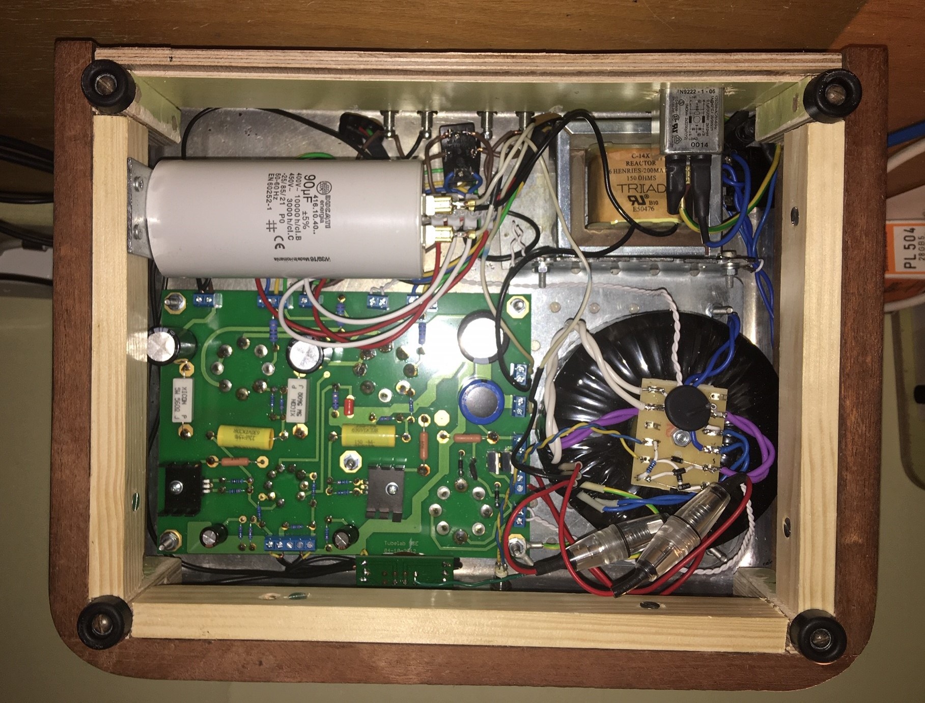

I am in the final leg with my SSE build. It has moved from breadboard to an enclosure I built, and now I have been focusing on refining the sound so that I can down tools, and say that I have finished.
The top is some sort of heavy duty baking tray I rescued from recycling, and I like the rounded lines that are repeated with the base and toroids.
The bass is excellent, but it is lacking some elelement of brightness. I had been using a bluetooth source with Youtube, but I tested today with a CD player and good quality recording, and there is no doubt that there is something lacking in the upper ranges. For instance, Funeral for a Friend, after the initial synthesizer refrain, the band plays and there is a high hat, which is there, but sounding a bit muffled and not part of the sound stage.

I am using UL with CFB. I have tried swapping tubes around. Currently have new JJ EL34s, but before had some old Telefunken EL34s liberated from a guitar amp. The driver is a Telefunken ECC81, but I have also tried a CV4024 (which does make the bass more dominant). While tube swapping, I managed to pick up an ECC83 without noticing (reduced gain and poorer sound), but it goes to show how you have to be careful and be organised when swapping tubes. Could have been something with a different pin out.
I have a DPDT switch for speaker impedance between the OPTs (where hopefully it will not get used during running), and I am pleased with that solution. I will be adding a 300ohm 5W resistor from the line to ground for each speaker connection to protect against no speakers. I am thinking this should be as standard as adding a fuse to the power supply - are there any nay-sayers?
I am pleased with the layout. The signal wiring is short and down one side, the power down the other, and the outputs at the back. Only downside is the proximity of the tubes to one of the OPTs, but I may well mount them vertically to get round that. (There is a perforated base to be fitted).

I am using a Toroidy OPT, the details are attached. I am fairly sure that is not the weak link. Bias resistor is 560ohm, and B+ is 407v. Voltage drop is around 28v, so dissipation is 20W and OK.
I have noticed that when I disconnect one input the sound does not disappear in that channel, but remains at around 25% of the volume. Is that crossover distortion, or is it a consequence of using a single tube as a driver for both EL34s? If it is a problem, that is pointing to an issue with the wiring, so I will recheck that and make sure the RCA plugs are insulated properly.
The problem is going to be something that is non-standard. In my case that is:
  • I have used a DPDT switch to switch between 4ohm and 8om taps. Could that be the source of crossover distortion?
  • There is a silicon bridge added to the 5V tap on the transformer, to get a source of DC for the green power-on LED. Maybe tat was not a good choice, since the 5U4GB is directly heated, so that tap is elevated?
That is a clue that there may be an issue with your input wiring. There should be near zero sound from the channel with no input even if the other is cranked full tilt.
That should not affect the sound, but it will put your LED at B+ level with respect to ground. Really bad stuff could happen if it ever shorted to ground or the chassis. I would use the 6.3 volt winding instead. A short here won't blow anything.

In my business, when we report IT support issues, sometimes we say the issue was 'the crank in front on the keyboard', and that was the case here. Suffice to say, I made a basic error connecting the wires to the OPTs (swapping the 4/8 line wires left and right), and it was no wonder that the stereo imaging was less than stellar :-/
The wires are now correct, and the wow-factor has been restored. And some ...
