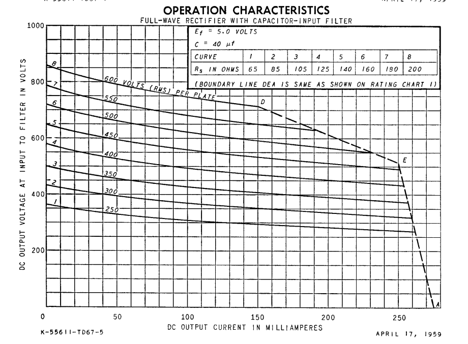

On the SSE website George said the value for C1 was not critical and spec'd anything between 22uF and 47uf (47uF being the upper limit for the 5AR4 rectifier). After he added some components to "make life easier" for the rectifier, he mentioned doing some experimenting to see if a higher value like 50uF was acceptable.
I can't find a subsequent thread or message that confirms whether 50uF/500V is safe to use or not with the 5AR4. Anyone?
At the other end of the spectrum, what would be the effect (if any) of using 22uF/500V?

Still wondering if it's safe to use a 50uF/500V cap in C1, with a 5AR4 rectifier and 750VCT (375-0-375) power transformer.
50uF would be about the upper limit. But that depends on the secondary DC resistance of the power transformer you're using. It's possible you may need to put small value resistors in series before the 5AR4 plates.
Check the 5AR4 data sheet - https://frank.pocnet.net/sheets/093/5/5AR4.pdf

You should see a drop in B+ compared to a larger C1 value. Either way, Id definitely be using sic diodes in series with the rectifier plates.At the other end of the spectrum, what would be the effect (if any) of using 22uF/500V?

You're gonna have a pretty high B+ with that trans. What's your target?

I think if you use 22uF instead of 50uF, the drop in B+ voltage will be small. There's a certain critical value beyond which the voltage doesn't go up very much.

I would also go with a 350-0-350 volt transformer today. The 750 volt Allied unit was a bargain at about $40 when I started making SSE's. Line voltages were also a bit lower and tubes that eat 500 volts for years without complaining were more common. The Hammond sourced Allied transformer has gone through at least one "cost reduction" redesign since I bought a bunch (2004) and they are known for putting out more than their rated voltage today. It will put the voltage across C1 real close to, or over 500 volts. Electrolytic capacitors have very wide tolerances. For all practical purposes a 47 uF and a 50 uF are the same thing. I would not go beyond 50 uF with a new production 5AR4 in an SSE.
