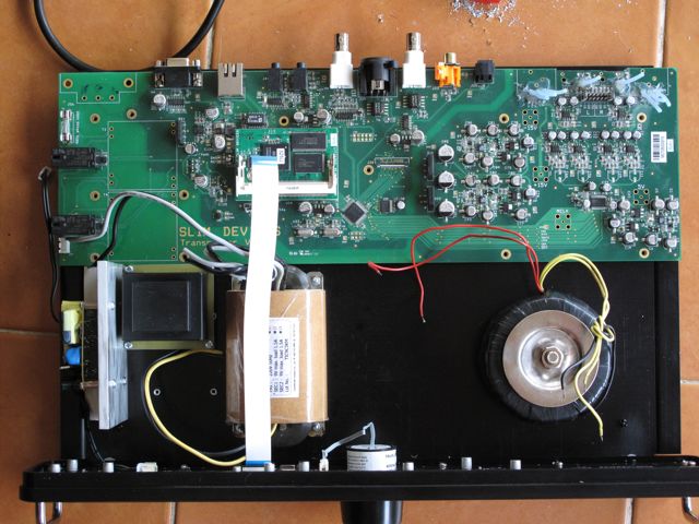

Transporter, I have dedicated time to do it offline. Because listening Like the first time admitted that a strong and promising to be more exact Mo. Mo First time I'll know what to do, express the point of the first Mo.
1. Transporter transformer power supply a little blue, size 2 9-0 9-0 V 3.2VA 18-0 18 -0 V 3.2VA Power, which I was listening to and measuring the symptoms is still not down from V. 15 -15 down to 13.5 - because of insufficient flow.
2. The problem of interference from switching to the pay screen, Clock and stir 2 to the treble no bass into shallow end of the image flow is not much less clear.
3. C power supply did not use the 85 degree low ESR of about 70 characters.
4. Use C ELECTROLYTIC CAPACITORS (a polar) in the signal path.
Transporter

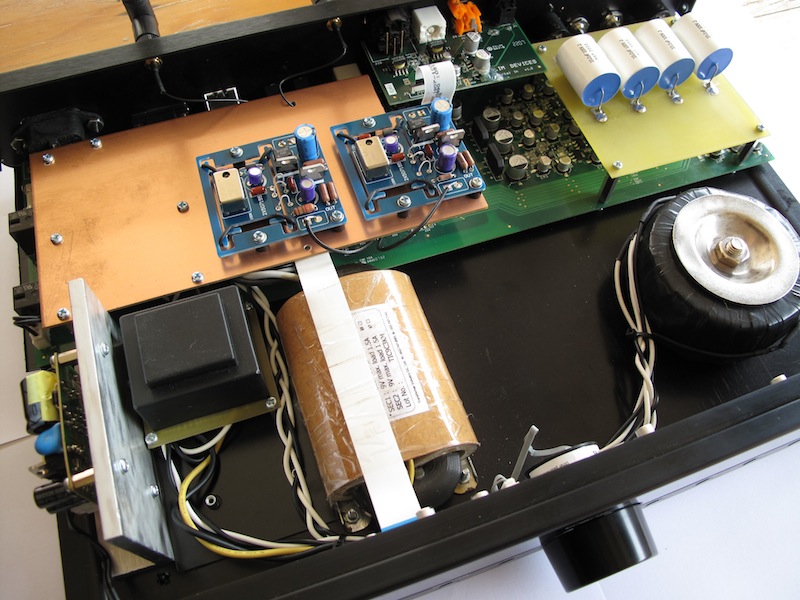

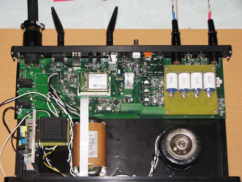

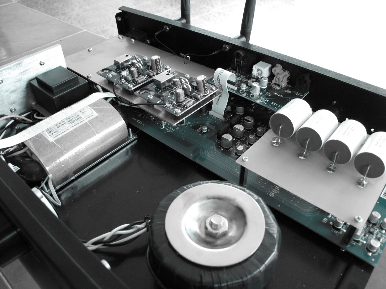

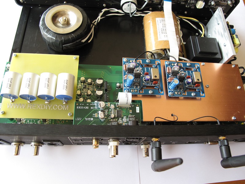

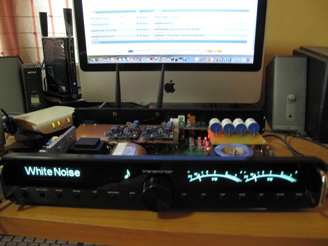

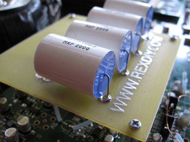

What I am Mo instead of the original.
1. Transformers size 9-0 9-0 V 30VA 18-0 18 -0 V 30VA solve the current problem is not enough.
2. Switching the screen to pay. Solve the problem by use Aluminium foreground 1 Cm to prevent interference and blocking. Move to remote digital

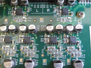

3. C power supply using low ESR 125 degrees instead of the original 70 characters.

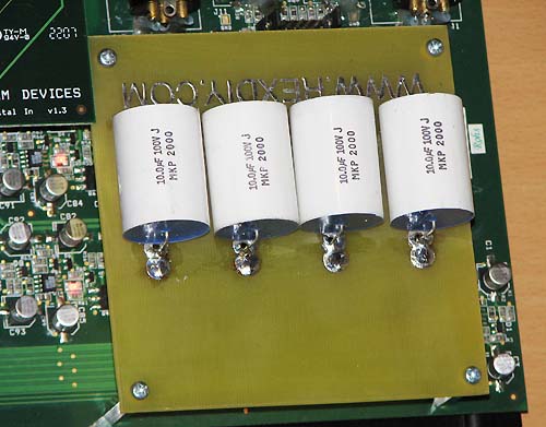

4. MKP 2000 changed to 4 instead of a circuit board and wiring from 47LAB Transporter.
Call 47LAB walk the entire signal path of Wisdom....

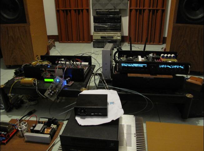

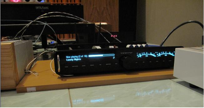

Clock input is not difficult, but how to locate interference at a minimum. Because a lot of noise and transformer FiWi I have to use copper to prevent interference with Transporter features I was listening on Optical S / PDIF to iMac and Power's song shooting Macbookpro 24/96Khz wifi than sending the same file but the iMac and the same song. Macbookpro Amarra is a wizard, but sounds even up the noise transmission wifi lot better than the sound that much better Since I can send files from iMac (old version) 24/96Khz Macbookpro send files up to, but 24/192Khz. Test no. I carry such a high file size, but you two just 24/96Khz Transporter is acceptable Thee d 24/192Khz the DAC is in a few dl. The file size has been the fact that Transporter Thee d 24/192Khz the DAC in terms of this slope few. The file size is actually because AK4113.
New TP firmware Ver 84 with squeeze server Version 7.6.0 (beta).
Is interesting.
Transporter: DAC roll-off filter can now be toggled between sharp and slow.
Sharp and Slow subconsciously what it offline. A bit of knowledge helps.
