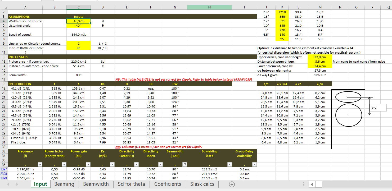

Hi !
Tried to use this calculator to find out where to cross TPL-150H with a B&C 8PE21 midrange.
I am using Minidsp OpenDRC with Firdesigner to design linear phase crossovers.
I am trying to avoid the distortion centered at 1.8khz in the TPL as much as i can and at the same time try to match the directivity at 80deg for the B&C 8PE21 and TPL.
I know that i would be better off with a 6.5" midrange, but i hope the results in directivity matching could be satisfying.
Can anyone precisely let me know where the 8PE21 reach 80degrees?
c4 16,735
c13 220,0
Close to 2300 Hz, if 16,375 cm is the cone's diameter and not all the way out to surruond/basket frame.
(Disregard what 's to the right, those are my additions to Inotin's spread sheet when I was checking versus AEs TD12 M and TPL 150H.)

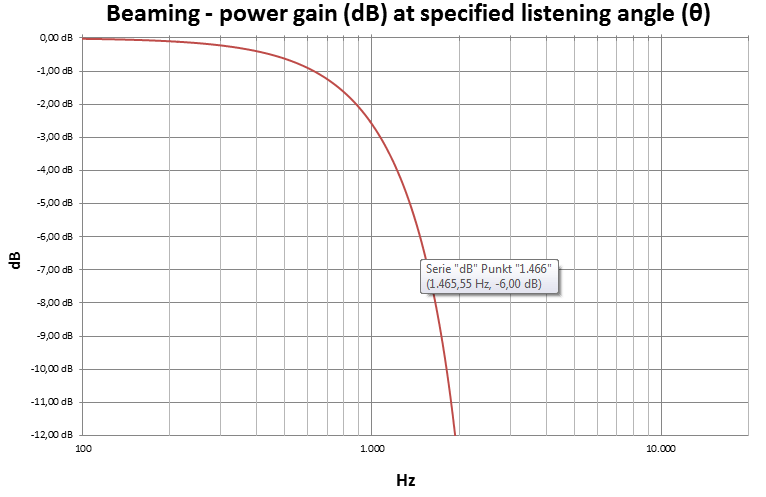

Rizzla and Adhoc1,
Maybe stuff is over my head but if you look for -6dB point at 80º and if we set C4 to 16,735cm and C5 to 80º, then at "Beaming" tab mouse point can read out numbers as being 1465,55Hz.
