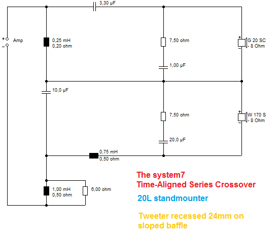

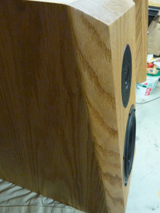

Oh, it looks like we did a Spica clone a while back! Nvr2manybikes built these sloped-baffle beauties. He said they sounded good.
This was slightly (2.4cm) time-aligned and based around a Visaton W170S-8 6" paper cone and a G20SC 3/4" tweeter.
Slightly iffy impedance, but everything else falls into place. Series filters can come with built-in notches in just the right places if you get lucky. All about good driver selection.

I have learned quite a lot since that project. Mainly how to get impedance better. You really need those online calculators for 6 ohms and get Butterworth values for the filter.
2-Way Crossover Calculator / Designer
Series filters work best like this, a near 3:2:1 ratio with time-alignment
Flat Impedance and Flat Power response design.
But I expect the original Spica filter does much the same things.
