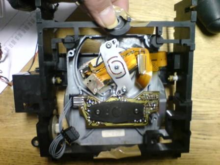

I bought a sphinx project 9 cdplayer but it couldn't read cd's, so i changed the laser from the CDM1 MK2 and tried if it was ok, (the laser is from an old player that was working) . But now the cd disk is not rotating, everything works display, drawer in and out i can see the laser arm moving and focussing but the motor is not spinning the disk, the i put back the old defect laser and stil no spinning disk, i also took a look at the hall motor changed the 4 transistors and 1 ic, measured the coils of the motor but still no running, i also noticed that when the power is on the and you turn the cd by hand the motor is breaking a little when the power is of than the cd turned by hand runs freely.

I already checked the resistors and caps they are allright, today I spend again several hours with the player and put in another good working laser assembly, but still it is not working.
What happens is when I turn the power on the laser arm of the cdm1 mk2 nocks with a loud klick to the outside off the drive and stay's there, you can see the lens focus, that's all and the disk motor (it's a hall type) is not running the disk, and when i turn the disk a little by hand the motor seems to break a little, i mean the disk is not running free, when i turn the power off the breaking is over and the disk runs well when you give it a turn by hand.

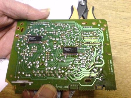

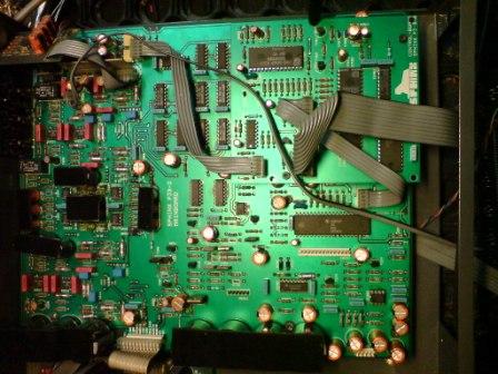

Hello back again just replaced the TDA8809 and TDA8808 chips but no change still not working, I will try to take a ppicture of the board maybe that can help for advise.
Regards Rene.
Regards Rene.
Must be a 7210 or 7310 decoder somewhere. Check MSC pin for pulses. Compare with one of those kringloop machines. Maybe it's dead, seen it before. But cant remember if a failure normally means 'full speed' or no turning. Without clock it's full speed.
Could be the driver between MSC and motor or it's powersupply.
This part of the player is probably very standard. i expect differences with philips/marantz at the powersupply and analog section.

Thanks Guido,
I could not find the 7210 or 7310 wil have a look maybe this chip is on the solder side of the mainboard.
I will check this tomorrow and let you know.
