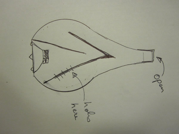

Newpaton, a photo of your maze if possible?

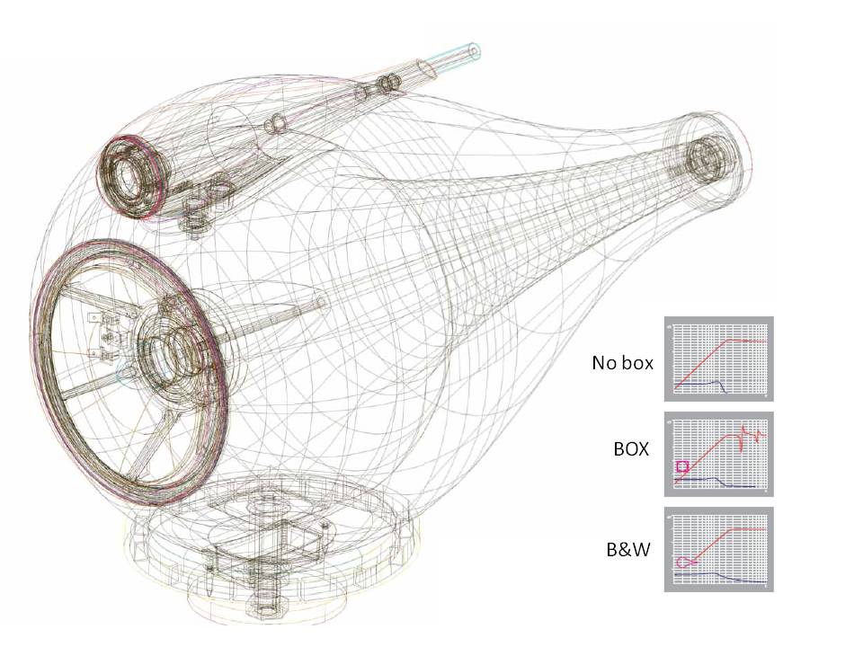

A good shape for the enclosure is a tear drop, but not for the inside, unless it follows the proper dimension of sphere and truncated tube with relation to the diameter of driver (B&W's nautilus enclosures). So I decided to play around with a maze system. The maze was somewhat complicated, but using a simpler maze I am sure you could still get good results. I will draw it up and upload a photo of the finished speakers.
Have approx idea of the Nautilus tapered impedance system (tapered tube) and the "maze in sphere" idea is new to me - most interesting - looking forward to it - thanks.
How interesting - does the Xsection area along the path of the "tube" stay constant despite the varying diameter?
The internal panels are straight panels, not curved, yes?

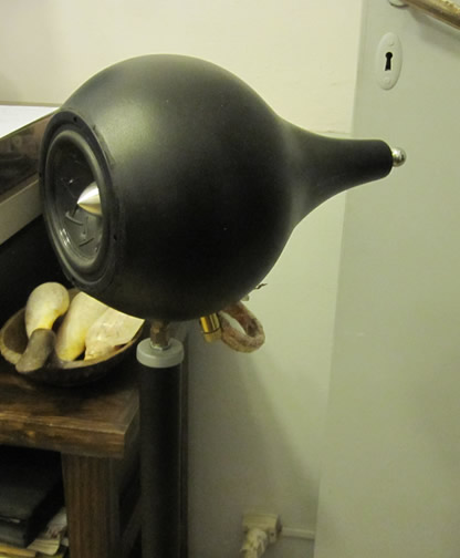

The internal panels are straight panels, not curves (i had originally designed curved inner sphere but very difficult to make). I tried to calculate the tube so that it tapers down as it reaches the back tube area, the rough hand drawing is just that, rough, the real design was better calculated. The pic i attached is a 4inch version with the sphere taper proportions without hole (sealed), sound great with woofer. However the maze version uses a 3 inch driver, open end (30mm) and the teardrop is 28cm long and 18cm spherical diameter section (7 inch diameter) with 3 liter volume (minus panel volume) and goes down to around 75 hz -3db , this was not possible with the same driver without the panel systems, it did not go down so low. The sphere is one piece all aluminum (no seams) done using aluminum spinning and a very special chuck. The idea of the maze with the holes came from a patent I had read, i forgot the physics behind it, i haven't designed speakers for a long time now. Kinda rusty! But the holes where like 6mm, cover the holes with some type of acoustic material and line with sheep wool or felt or another type of damping material to reduce standing waves..etc.
Thanks for the info - I wonder if the same thing will work with my 8" FR driver in a 28liter chamber (16" dia) and just scale your design up? My exponential tapered "horn" is about 250mm long (sealed tip) for the system low Xover point of 120Hz, pretty much straight off the Nautilus papers - this taper is a bit different to that - I'll get started.

Newpaton, your speaker looks really cool. do you think a full range driver, such as the Tang Band W8-1772 can produce enough bass in a tear-drop shaped enclosure?
I would also like to keep a ball shaped enclosure for the look... not sure if that is possible tho.
QUOTE]
An W8-1772 would have -3db around 100Hz in ~1-1.5 cu ft sphere. This shape seems optimzed for midrange/midbass to minimize both rear wave reflections to the speaker cone and baffle diffraction. Naturally a very large sphere can deliver good bass with high Qts speakers.
