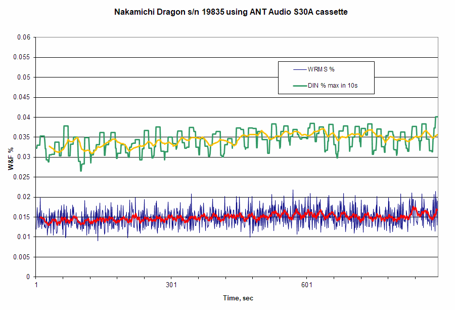

Email or PM me, I make probably the best current Speed/W&F cassettes, with the residual W&F below 0.06% not wtd, 0.03% DIN wtd, 0.015% WRMS . Good enough to check if the Nakamichi Dragon performs as it should. Here is the W&F graph of a well serviced Dragon using one of my cassettes.
