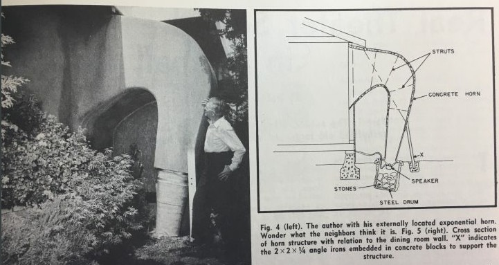

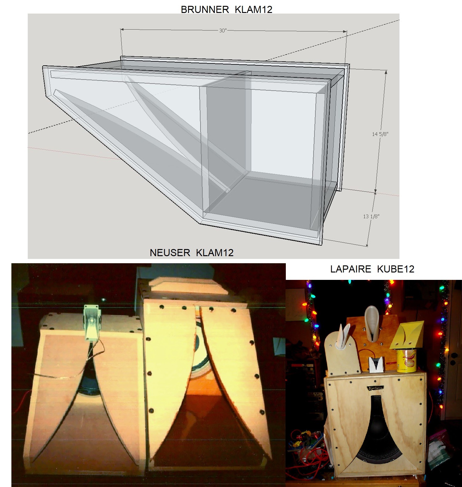

Well, Canada is a big place and you guys have a special kind of cold (in NWT, etc), sooooo...judgment prevents assuming temperatures. What you could do is bury the LF drivers like that old Crabbe horn. Except, in your case, shifted down so that the driver lives deep enough to stay 45-50F 🙂
