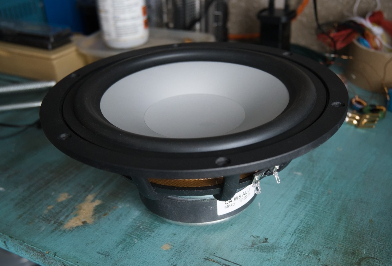

Recently I made a TV stand out of wood and aluminium, and thought it would be nice if we had a pair of speakers that matched. Using T-slot extrusions would also let me avoid having to do any real joinery, which is too much effort for my lazy self. But would that really work?
To start with, the drivers: Omnes Audio CX 3.1 coaxials for the mid/tweeter, and Omnes Audio W8 Alu for the woofers (in series pairs for 8Ω total, as they are driven by an amp with a 6Ω min. load). These are nice looking aluminium cone drivers, although their matte finish doesn't quite match the silky finish of the extrusions. I chose the CX 3.1 because I wanted coax drivers, and they looked like they had less terrible frequency response than most. The woofers I chose simply because they match.
