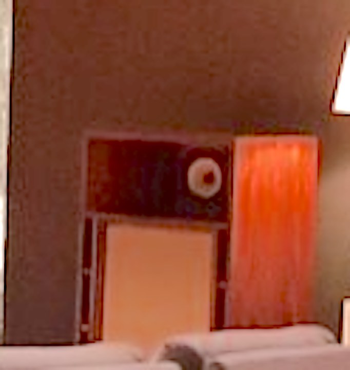

So my buddy went to the movies with his wife to se the Korean film "the parasite" - naturally he focused on the important things in the movie... i.e. what are those speakers in the living room?
It looks like a Onken 360 cabinet but extended upwards with a rectangular horn ending in what might be lowthers or something similar 6" or so with a phase plug.
Looks as a nice idea and inspirational (I collected the parts to start building some Onkens soon...) a larger 300hz horn might make the potential lobing issue (from the distance between the 15" and the horn) go away.

It's kind of a neat design. I have been tempted to build the Onkens described in the Hiraga article. But what to put on top? I have a pair of Altec 811 horns, but if I cross over at 1K or even 800Hz that will make three narrow lobes if you estimate the horn/woofer distance as 20 inches or 0,5 meters. With 300 Hz you will get just one nice big lobe i.e. better blending in my estimation. Check out this freeware to calculate lobes. Other neat stuff too.

You can design a tractrix upper horn of any dimension using spreadsheet on Volvotreter’s website. Those can sound exceptional with a good powerful 5in full range. I used 5MR450NDY and had a 105dB/2.83v horn. Goes down to 600Hz. So almost any bass assist can work. Needs to be a pro driver to get 100dB sensitivity.
Ideally a front loaded bass horn to match the sensitivity. What I like is that because of the high sensitivity, cone barely moves (40um for 90dB listening level). So distortion is very very low. Great sound from full range tractrix. Highly recommended.

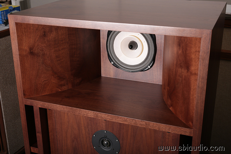

It is hard to see what driver, but it is earily familair to a stock FE206 with phase pugs installed. Small front horn and Onken loaded rear. The ghost of the frame is what is pushing me to that guess.
Hard to get real bass if it is FE206 (or most lowthers — i am working on a simialr miniOnken for the PM6A).
dave
-it's got to be a lowther (or lowther-like driver): the size of the whizzer in relation to the cone is very large, larger than the 206..
-basically a lowther TP1 on top of an Onken.. Needs to be one of the more powerful lowther's as well for the rising response when used in a horn like the TP1.

Looks like a Lowther in an Altec style short front horn with a dome tweeter and Onken style bass cabinet. What a mix!
