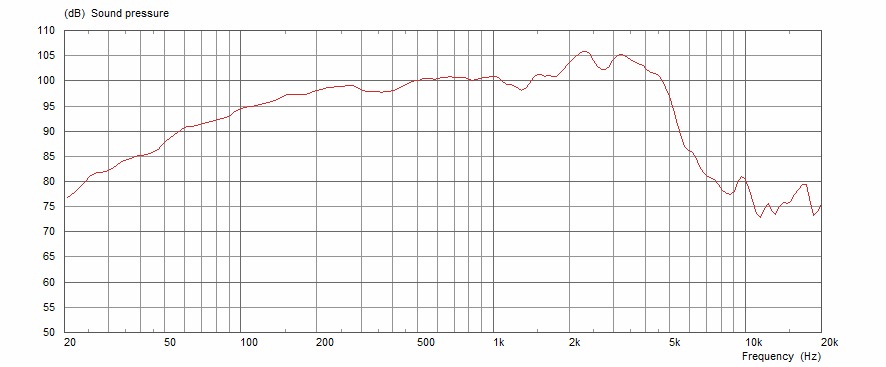

Hi, first post here. This is a celestion V30 speaker that is common in guitar speaker cabinets - an example of what the impulse response will be played through what I’m looking for explained below

I will be using them to monitor guitar playing. Guitar speakers frequency response is as such (see picture of graph of Celestion V30 speaker)
Notice it drops off above 5K: the beaming issue is a bit different with electric guitar speakers 🙂

To answer the question of the OP, your best bet in the 12" range will probally be the Fane Sovereign 12-250TC or the Beyma 12GA50 in a custom cabinet. Not many fullranges that size are availeble and they are mostly not flat in frequency response. But those are best in the guitar frequency passband and relative flat over the full range. For amps, if you don't need colouration from it, a good class D can do the job and be lightweight. I would take a pa amp for live purpose (for durability) altough, like a crown XLi series. Most hifi amps are not build for the wear or tear of the road and will break down fast.
