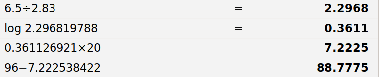

I have an old pair of Mordaunt-Short speakers where the sensitivity is measured like this:
Sensitivity: 6.5V r.m.s (5.3 watts) to produce 96dB at 1 metre
How would this be converted into something more understandable like dB at 1W/2.83V?

6.5V into an 8 ohm speaker results in 5.3W.
2.83V into an 8 ohm speaker results in 1W.
Since the voltage is somewhat over 2 times higher in the first case, the sensitivity will be a somewhat over 6dB higher.
So I reckon a good approximation of your MS speaker's sensitivity is 89dB/W/m.
