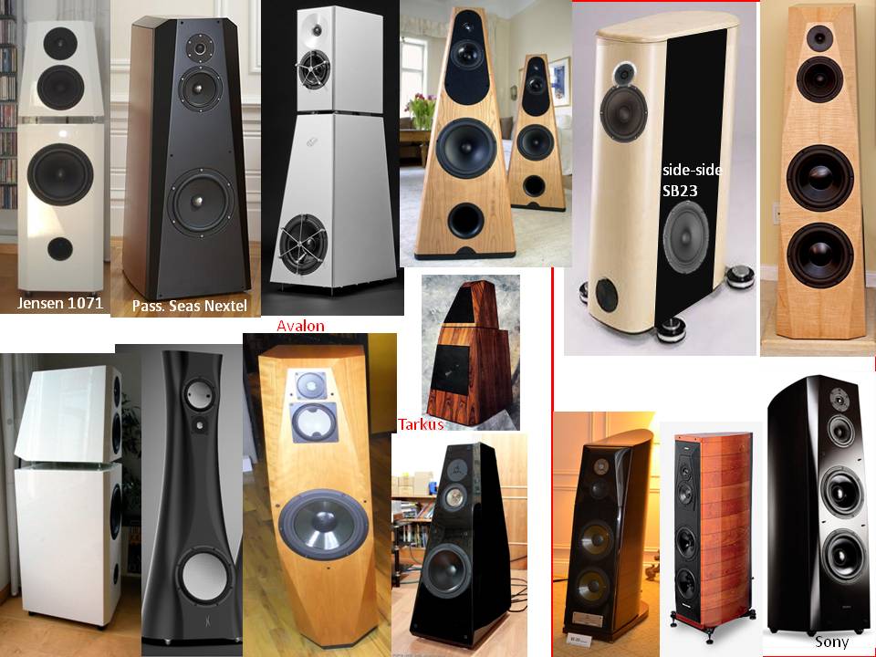

Cirrus57, Is there a commercial speaker which has the physical size + construction style + performance range(SPL/W, freq_range, polar_pattern, etc..) that comes close to your diy-vision? It seems you favor traditional drivers...e.g. no dipoles, no horns, no ribbons, no AMTs, no ESL,
A few slightly-over-the-top >90db/watt drivers:
--Satori TW29RN Ring Dome Tweeter with Neodymium Motor $145. (high 95db sensitivity, flat + extended SPL)
https://www.madisoundspeakerstore.c...w29rn-ring-dome-tweeter-with-neodymium-motor/
Faital 6PR122 95db sensitivity $140 93db sensitivity from NdFeB motor
http://www.faitalpro.com/products/files/6PR122/8/6PR122_datasheet_8.pdf
Woofer selection requires cabinet selection.
-------- PROVEN design ~85db sensitivity
The Kairos Three-Ways
SATORI-TW29R-dome
SATORI MW16PR-8 midbass
SB Acoustics SB29NRX-75 woofer

All this advice makes to much sense to ignore . Therefore I will start small with a two channel . I would like to use some good drivers . I like the two towers on the far right of the commercial tower photo . I will high density mdf to start . Thank you for all the help .

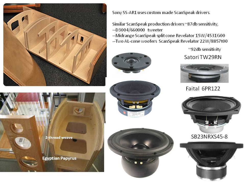

The bottom-right black Sony SS-AR1 speaker has won several major awards for sound quality and style. Attached photos will give you cabinet construction details.
Sony uses custom made ScanSpeak drivers. You could choose to use similar ScanSpeak production drivers for ~87db sensitivity,
--D3004/660000 tweeter
--Midrange ScanSpeak split cone Revelator 15W/4531G00
--Two AL-cone woofers ScanSpeak Revelator 22W/8857t00
OR use newer tech drivers like the (92db Faital 6PR122 mid or 86db Satori MW16P-8 mid) + (94db Satori TW29R tweet) + (two 8" SB23NRXS45-8 woofers = 92db).

Here's the best part. Retail speakers are always smaller than the optimal size for the woofer drivers. Thin wood as well. After all, they are shipping boxes of air around. If you build your own, the construction will be more solid, and the internal volume will be correct. This is where your efficiency and damping come together for an excellent sounding speaker system.
How small are retail boxes? Often less than 1/2 to proper size. Crippled before they make a single noise.

Sony wrote a white paper on the SS-AR1 which you can download for more technical details, measurements, and dimensions. Sony had ScanSpeak manufacture a 5" midrange with custom T/S parameters optimized for Sony's rear-port midrange box. The SS-AR1 is a ~4-ohm speaker.
You have to decide if you want a ~4ohm or ~8ohm speaker.
I would recommend a sealed midrange box.
4-ohm---RUN a sealed box sim for the 15W/4531K01 "K" specs Qts=0.23 in 0.25cuft sealed box and see if you agree it looks good. You should also tweek box size for Qtc ~0.6.
8-ohm---RUN a sealed box sim for the 15W/8531K00 "K" specs Qts=0.27 in 0.25cuft sealed box and see if you agree it looks good. You should also tweek box size for Qtc ~0.6.
ScanSpeak offers the 15W/4531K01 4-ohm with Qts=0.23, 15W/8531K00 uncoated cone 8-ohm with Qts=0.31, Scanspeak 15W/8530K-00 8-ohm with Qts=0.27, and 15W/4531G00 4-ohm with Qtx=0.34(good for ported box). Confusing.
