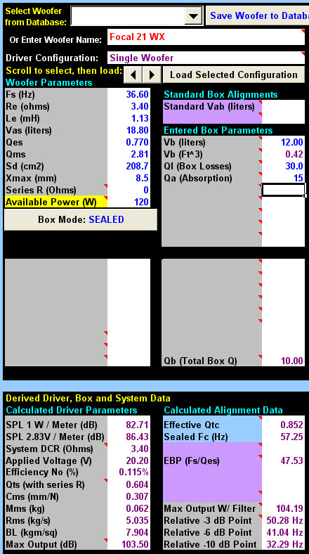

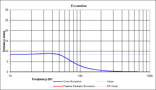

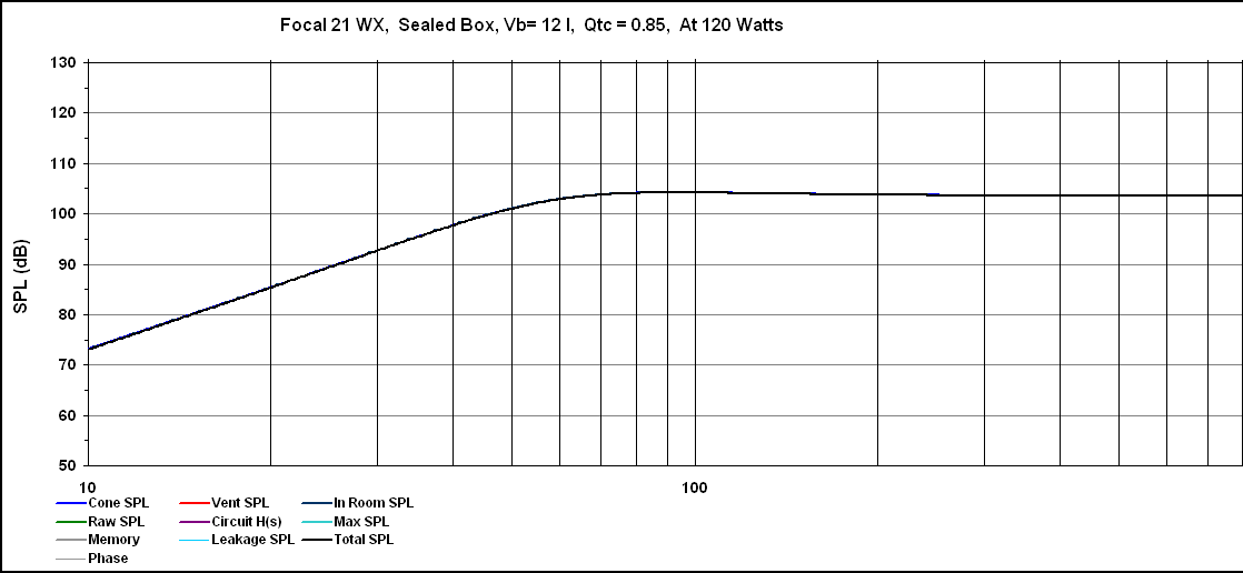

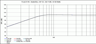

There is no WTF here under any circumstance! You have a 86,5 dB spec
for 2,83V input and 82,63 dB for the 1W input based on 3,4 ohm dcr.
I have included some simple sims for this Utopia unit.
