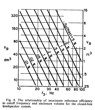

Not 100% sure about anything. Might even throw some better drivers in the doors and forgo the sub. For now, I really want to see what kind of bass I can get from the spare tire well "on paper". Might not even be that good. From my research the well is 1.5ft3.
According to Small's charts, 1.5 ft^3 net = 20 Hz/F3/vented/0.02% = 75.01 dB vented, closed/0.01% = 72 dB.
Efficiency and sensitivity conversion - loudspeaker percent and dB per watt and meter loudspeaker efficiency versus sensitivity vs speaker sensitivity 1 watt = 2,83 volt box chart - sengpielaudio Sengpiel Berlin
