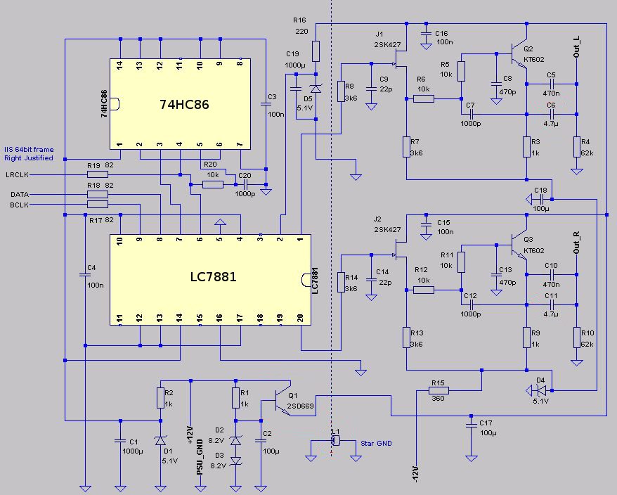

I want to build an easy DIP socket type DAC, and Sanyo LC7881 looks very interesting to me. Easy build, few external components, native voltage -high impedance- outputs, but no standard i2s wiring compatibility.
I found this schematic on a Bulgarian forum. I don't know its author and I'm posting here within his/her tolerance. Any comments on circuit, especially i2s conversion on digital input section and additional info will be appreciated.

Glue logic for LC7881 here.
Looks painful, and he does not show the SPDIF receiver used.

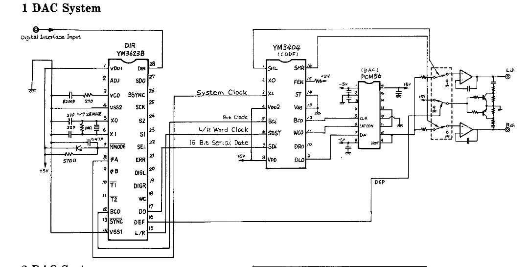

Perhaps I have found an easy solution?
The NAD 5325 CD player uses LC7881 and YM3404B oversampling filter.
The complete d/a DAC converter list - DutchAudioClassics.nl
The YM3404B is designed to work with the YM3623B digital receiver
YM3404B chip for sale here
YM3623B chip for sale here
I found a pre made receiver board here
Is there any reason this wouldn't work? ( the picture is from the Ym3404B datasheet and shows a PCM56)

I think the Yamaha reciver looks much simpler. I bought some of those too

Link below for the source of the scheme:
Upgrade of cdp vega-122
http://semigor2.narod.ru/KarDAC.rar
In this particular case no spdif was used as the dac was connected to I2s provided by pci soundcard with software upsampling.
