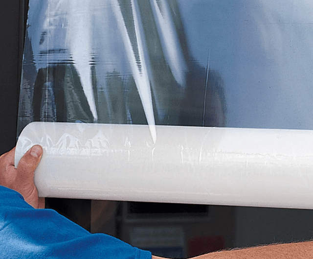

As the title suggests, I'm looking for sources (preferably North American) for clear slightly sticky film such as what you find on new TV screens, etc. I'd like to adhere it to my projects before doing final routing to protect the finish. It must be stronger than plastic food wrap and with am adhesive that doesn't leave residue.
Any ideas?

You could use vinyl wrap material used on car bodies. It can be peeled off after applying it, but I dont know how strong the adhesive is.
It is a low strength tacky film that is used as a transit packing, like you said.
It is usually sold in large rolls direct to factories, by plants using roll coaters to spread the adhesive on base film.
Getting a small qualntity will need finding...the rolls are usually more than 1000 meters long, and start at 1 meter width, and up to 6 meters...
The alternate is to find a spray or liquid form of the adhesive, or use wide (2+ inches) pieces of masking tape, that should work.
Basically you want a tape / film that stays in place during routing, and comes off when you want to remove it.
My advice is to buy a roll of wide masking tape made by a reputed company, and try it on a scrap piece, then work on the job after you are satisfied.

Essentially you're searching for a pressure sensitive adhesive based film with mild retention properties. There is the so called "clear bra" film some automotive manufacturers use to protect rocker panels from stone damage. It may be overkill for your needs.
I like the masking tape idea. It will probably be the cheapest solution, and probably the best. I have used 3M "blue" 3-inch wide masking tape for exactly this purpose. It prevented a hand-held circular saw from marking the surface of high-quality veneer plywood... in my case it was walnut veneer plywood.
I often use painters tape but I'm looking to cover larger areas such as a full size 3 way to route holes and preferably see through.
If you type in "protective plastic film" on Amazon you will find multiple examples of clear and colored films available. My favorite name is "ArmorDillo" film, but that is blue. No endorsement, just a chuckle.
I've used 6-inch-wide painter's tape from Amazon for similar purposes. Don't know if wider is out there somewhere easy.I have used 3M "blue" 3-inch wide masking tape
Like the window film referenced earlier, there is also plain static cling vinyl that most sign shops can get. Depending on how much tack you really want, that may work for you also. The surface needs to be quite smooth for that to adhere though.
Masking tape does leave residue. Only use genuine 3M Scotch painter's tape. It comes in several widths.
https://www.amazon.com/Scotch-2090-...HWPf1X8pFjSF6lvurP2ILf6mE_iZ-6WRoC8V8QAvD_BwE
Not cheap in small quantities but I don't know what other sources might have. Also, may be a bit thin if the item is going to get too rough of handling.
https://www.uline.com/BL_6408/Glass-Protection-Tape

Wow. Great find. I even deal with Uline nearly daily. I'll order some and try it.Not cheap in small quantities but I don't know what other sources might have. Also, may be a bit thin if the item is going to get too rough of handling.
So many great suggestions. Thanks guys!
