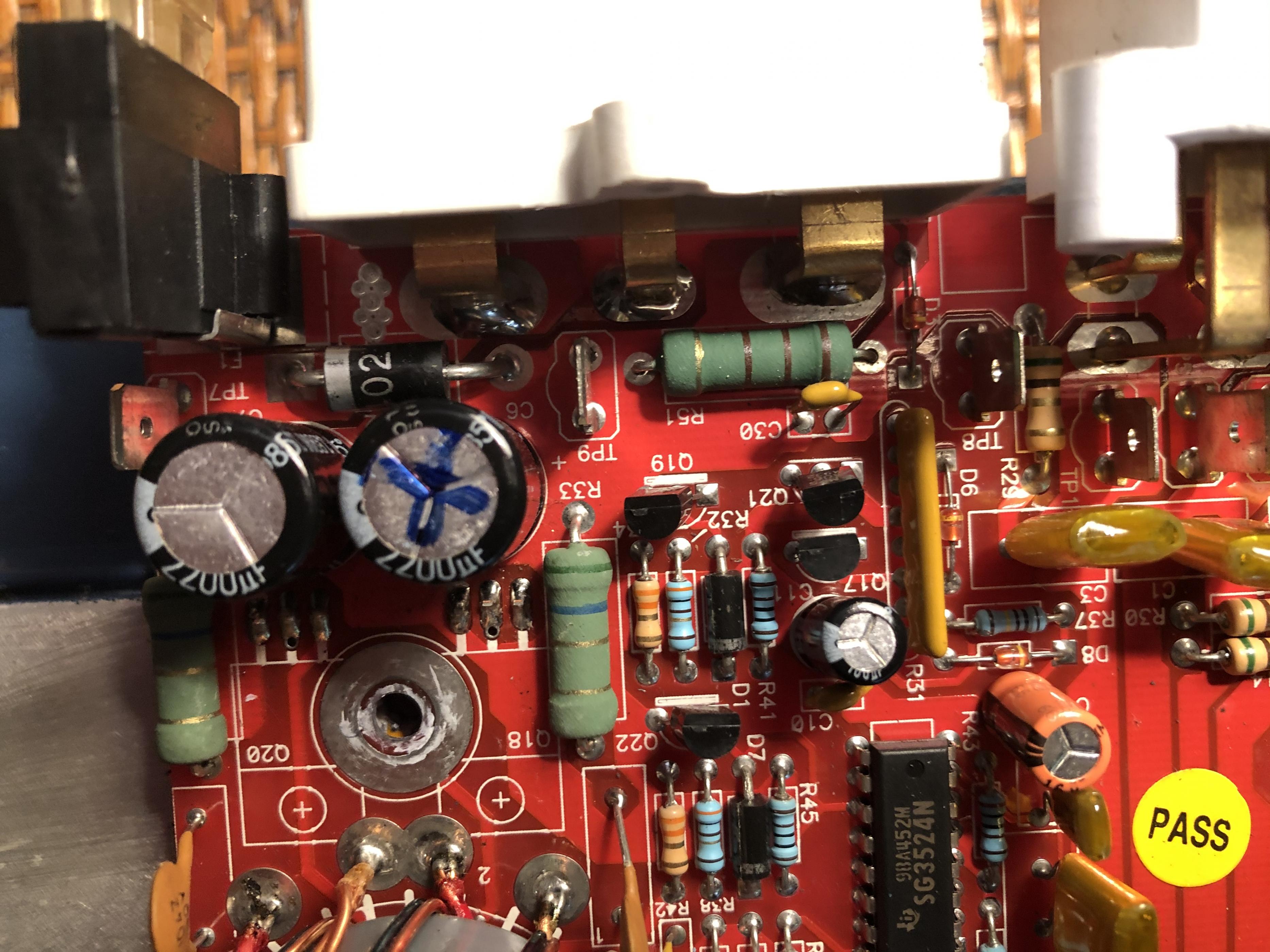

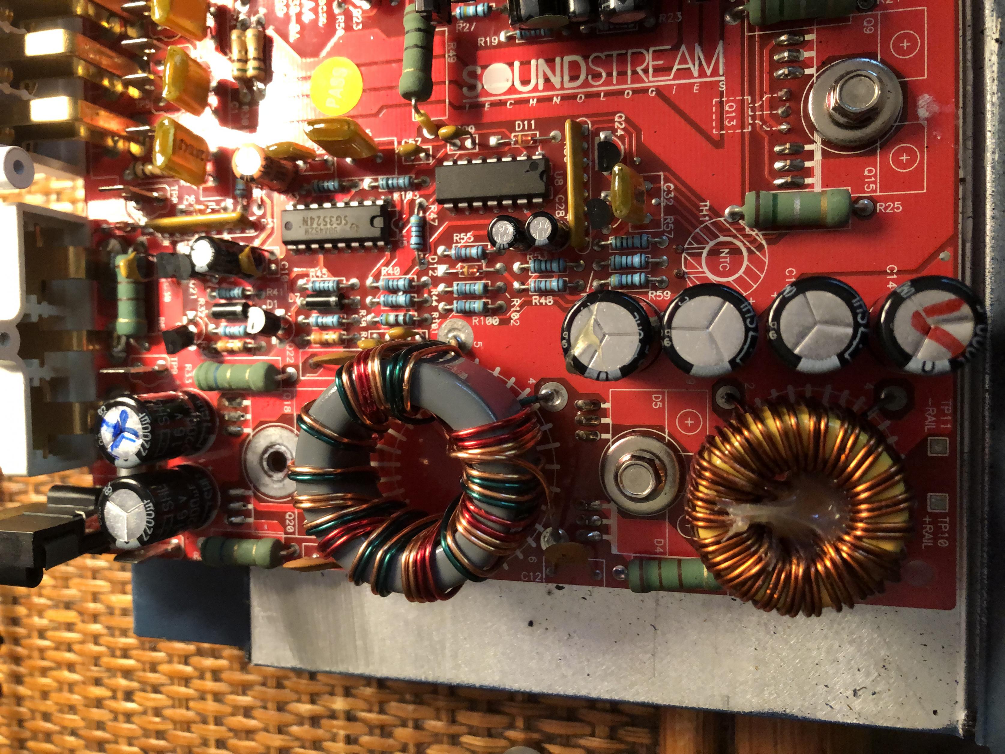

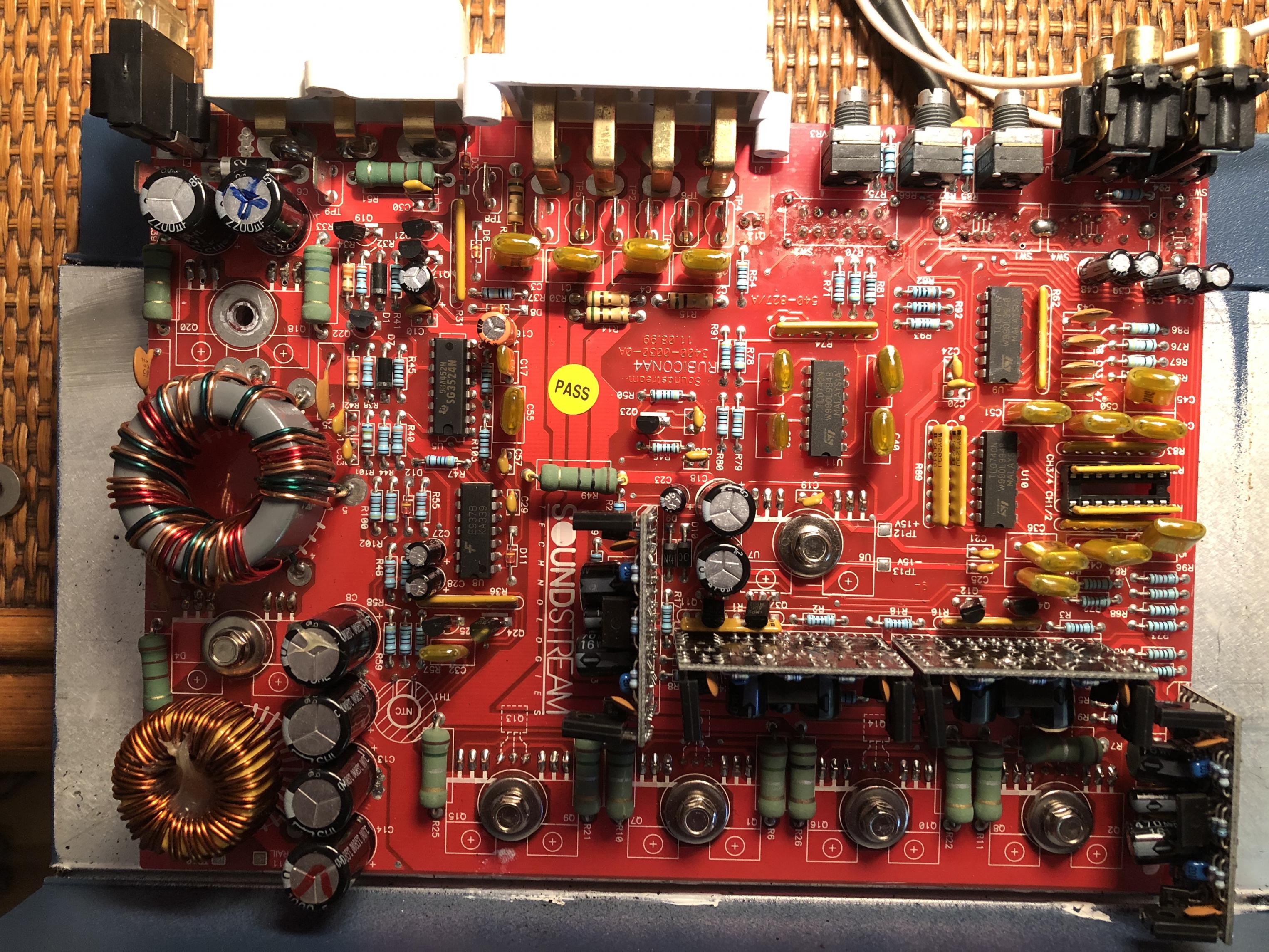

Picked up a Soundstream RubiconA4 to mess around with and see if it can be repaired. I have had no luck finding a service manual. Powered up the amp and the power light fluctuates from bright to dim red. The amplifier produces no sound. Opened up the amp and noticed one of the screws that clamp the board to the heatsink was loose, the screw will not tighten, seems the heatsink is stripped or was tapped improperly from the start. That can be addressed if the amp is functional and when the board is removed from the sink.
Test point TP9 reads 0VDC, TP7 +12.3VDC, TP8 +11.7VDC, TP 10 +Rail fluctuates between +8-12VDC while TP11 fluctuates between -8 - -12VDC.

Did you check Q18 and Q20 for shorts. If that screw was stripped out, then the mosfets in the bottom of the board probably weren’t held tightly against the heatsink. They potential could have overheated and gone into thermal run away and shorted.
While your at it go ahead and check all of your other mosfets, Q2 through Q15 in the output section. Looks like you have biasing transistors in between your mosfets in the output section.

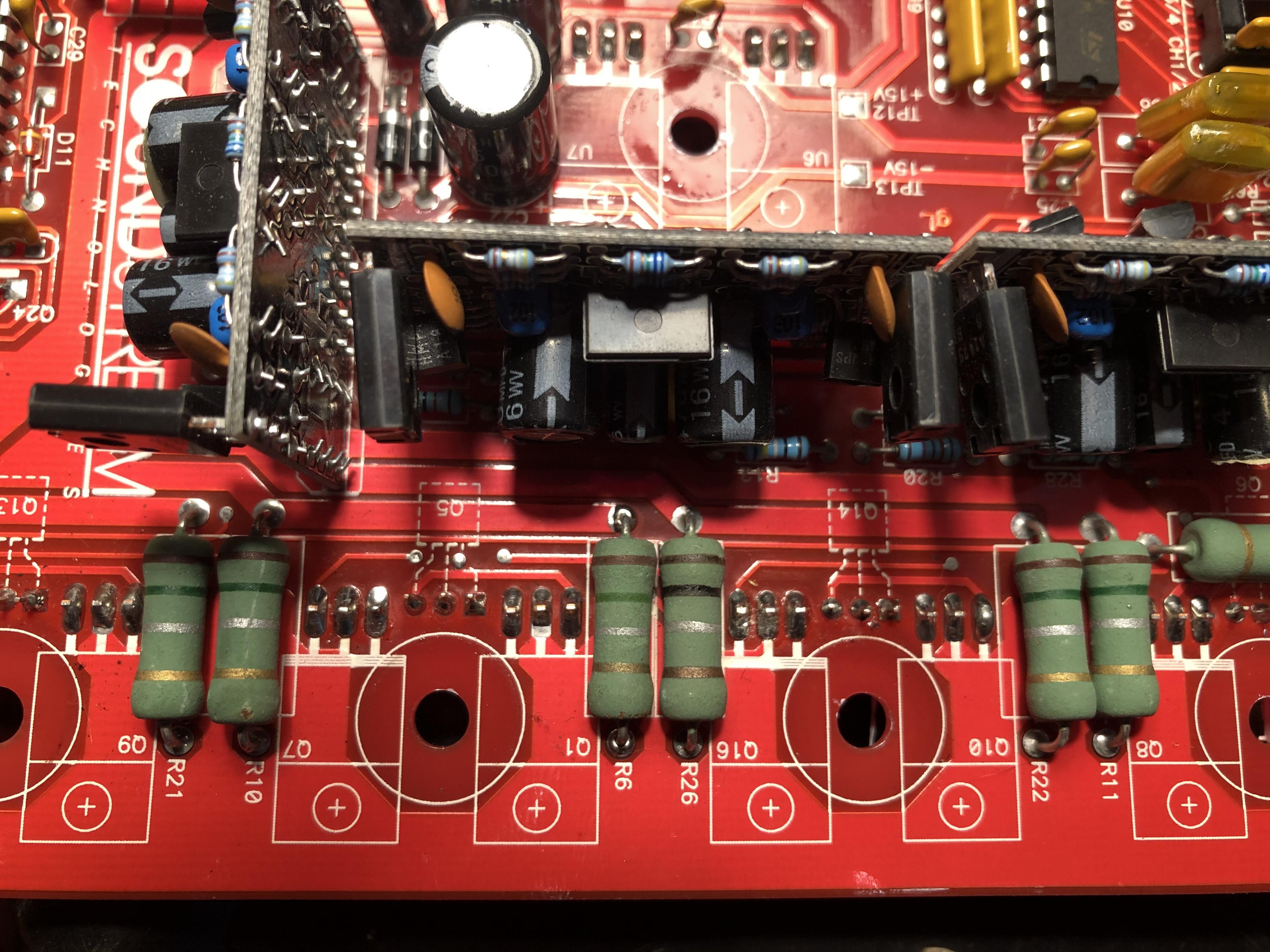

The emitter resistor R26 has a different value from the other which read 0.2, 0.3 ohms. The R26 starts out at 5.xx ohms and steadily increases which would lead me to believe it is bad. I included a pic as the resistor appeared with my bad eyes to have a different color band and it does. Could that resistor have a different value than the others causing the problem, or just a color variation in the batches? What would be the correct value to google to find replacement.

The value is 0.15 ohms. Probably 2 watts (measure and buy the same size). The color is different because it's burned.
