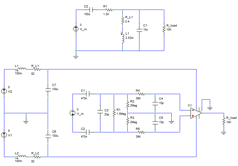

Ok, what I have so far looks like this. At the top you can see the output from the soundcard. C2 protects the output in case of 'accidents', R1/L1/C1 form a 1kHz bandpass filter.
At the bottom left, two batteries with LC filtering which should be very low noise. The inductors internal resistance is enough to damp the filter.
On the right the input. I'm not sure if this is the best way to go about setting the input impedance, but then again since this is not a very high frequency circuit it probably doesn't matter too much. The impedance seen by the probe is fairly close to 1M||20pF, but slightly lower if one end of the probe is grounded. R2/3 provide a path for the input bias current of the IA. R4/5/C4/5 filter RF.

The coil is part of the bandpass filter: C1 and L1 resonate at 1kHz, presenting a low impedance at that frequency, forming a voltage divider with R1.
So far the most likely IA is INA128PA. It has reasonable specifications and is one of the cheapest I can find. Better ones tend to be a lot more expensive.
