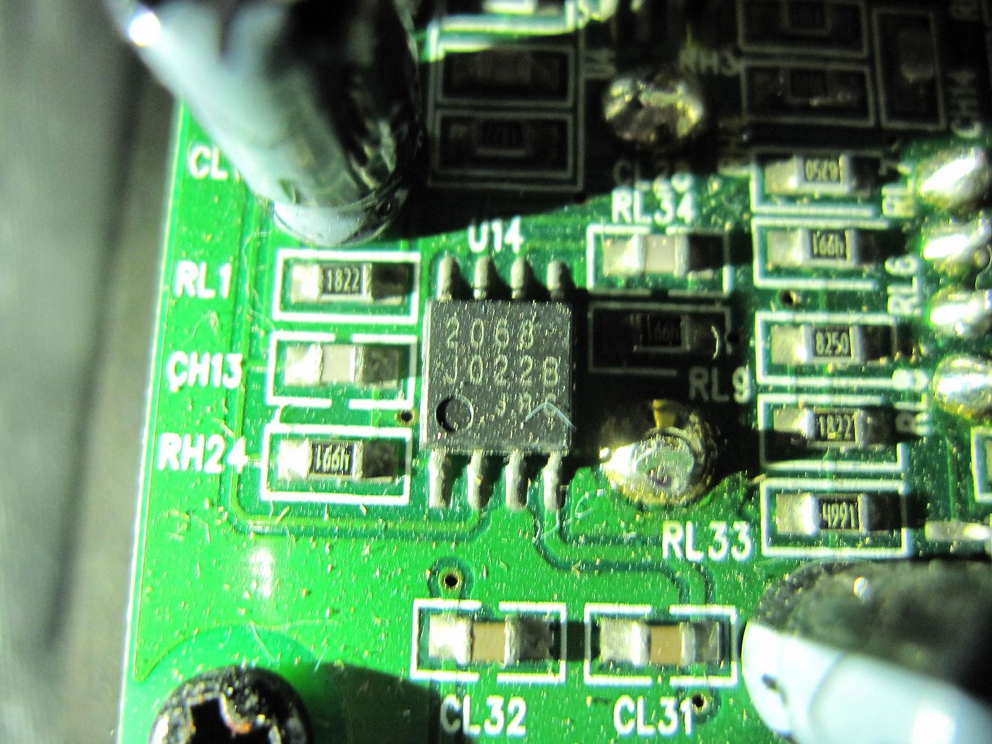

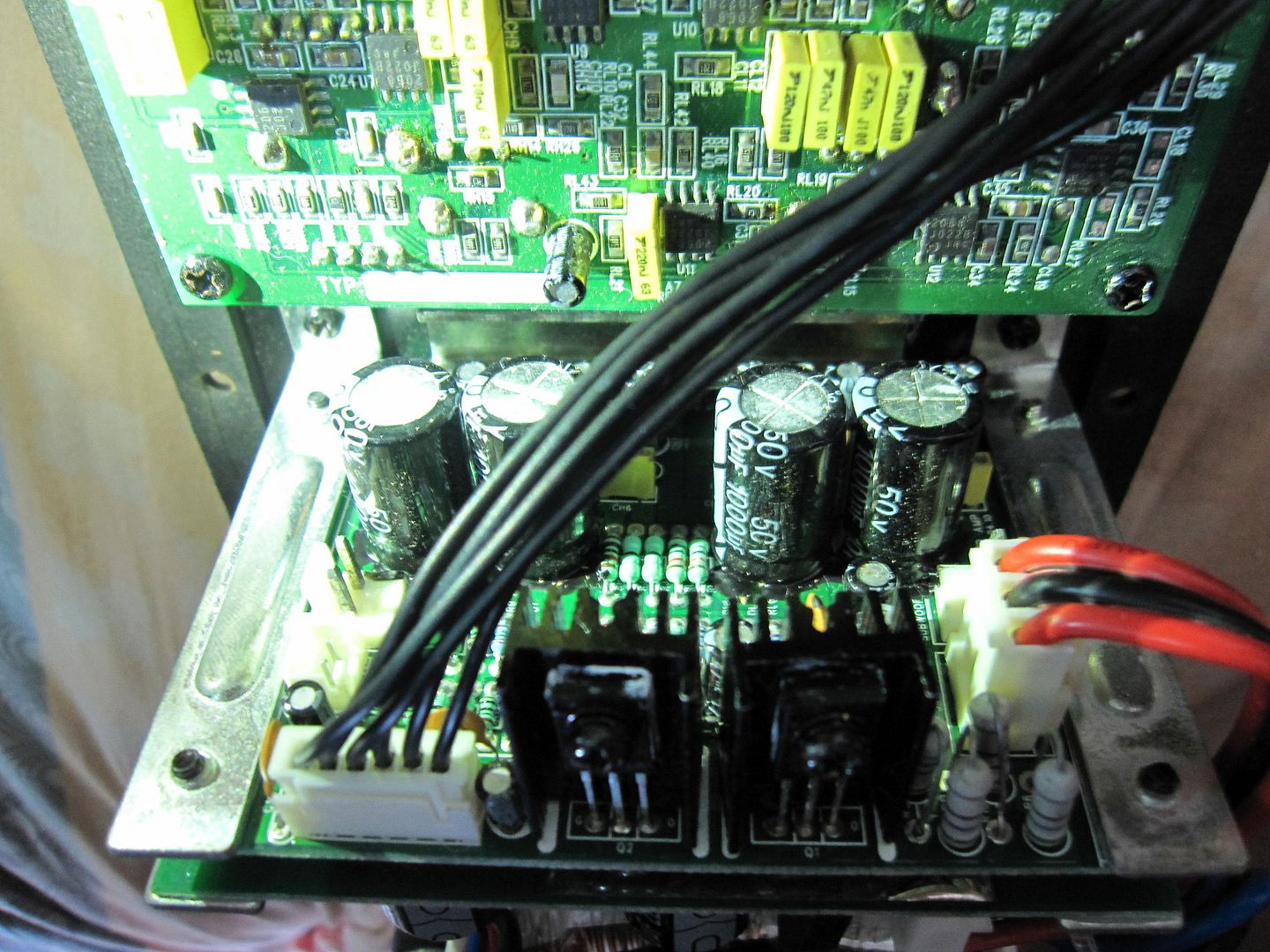

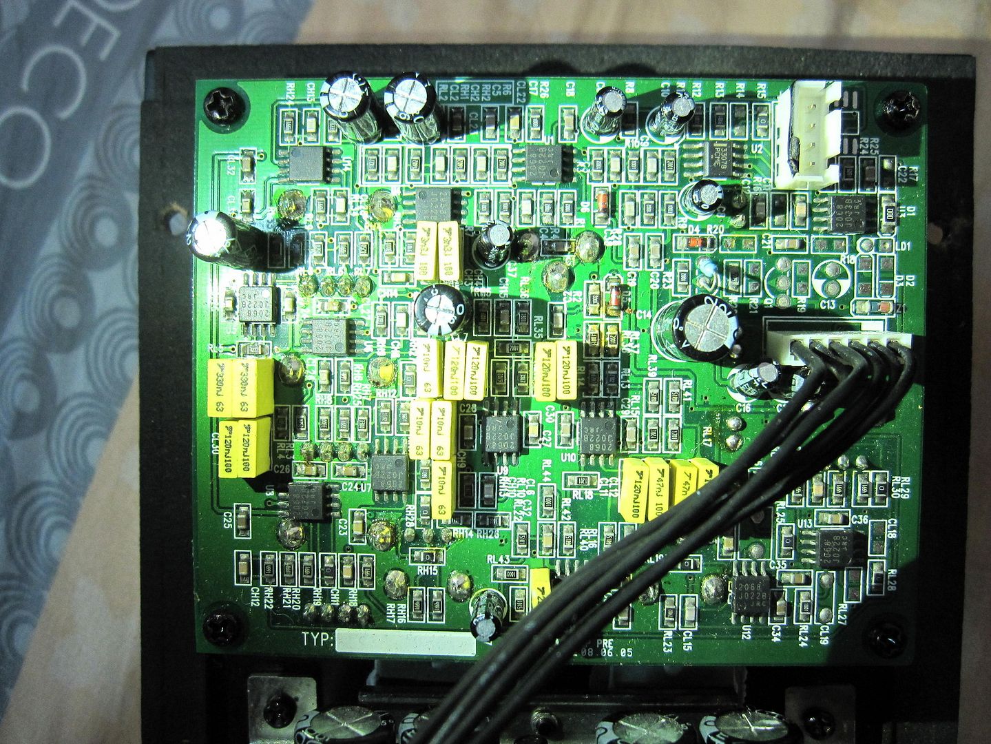

This Adam A7 come with D-K cap. Do anyone know what brand is it?
And I replace power amp cap to elna cerafine and blackgate
Preamp replace blackgate and cerafine too. And change to bc film cap. Opamp change to opa2107.
Power filter cap change to bc 146.
Do anyone can give me suggestion? What wrong?
Looks like an active crossover with Gainclone amps. Better not change many things at the same time. D-K is cheap but very good sounding.

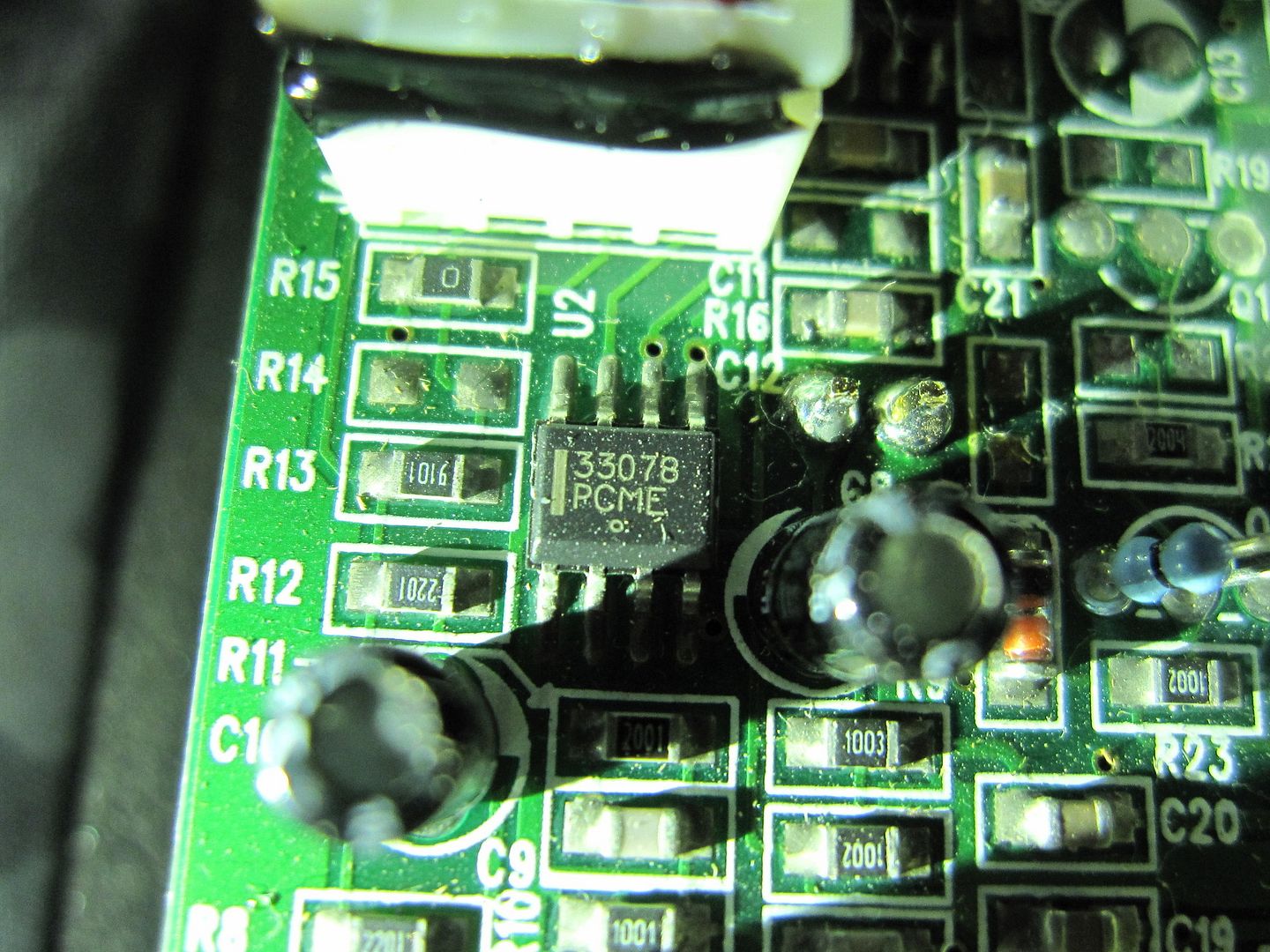

1) Make sure you have compared both opamps (other components being the same) to make sure the problem is not due to the opamp. There are many (SMD!) opamps, which one that you changed? All?
2) Small caps (mostly in nF) might be crossover elements. If so, you cannot replace them with different values. Tho may be they are the SMD ones.
Guess I have to suggest, are you sure you did not get counterfeit parts?
By worse sound, what do you mean?
You modified two boards. Which is causing the problem? Both?
I agree, it is likely an oscillation has been introduced. It looks like some of the caps are physically much larger. Were the values changed? You need to get a scope on it.

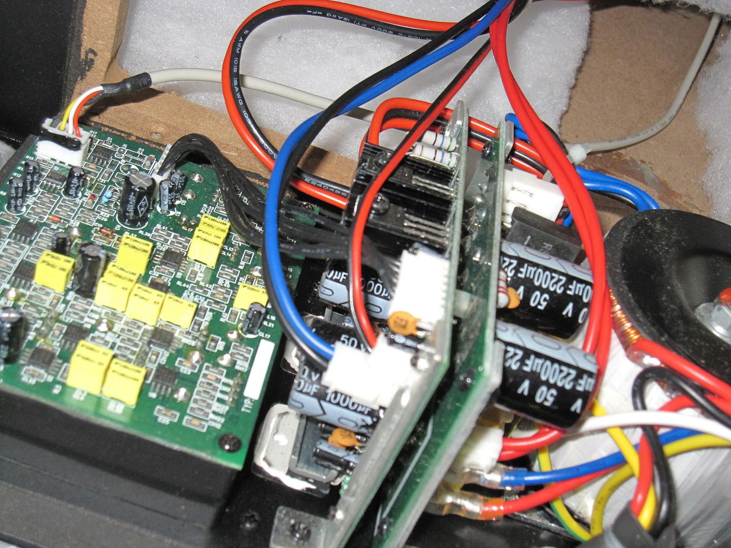

The yellow cap is made by many companies. Here it is commonly called MKM capacitor. I don't know what it is made of, but it is cheap but good sounding. It is a good decision to use it for commercial offering as its performance-to-price ratio is very high. And it works in all positions.
The OPA is better than the JRC/NJM, I don't think the upgrade will reduce performance. The JRC can be used with lower voltage than the OPA, but I don't think they use below +/-10V (as it will degrade the performance).
I think you need to listen both amps. Who knows you have different taste than your friend. The original caps will tend to sound "thin" but quite transparent, so good at middle to high. Cerrafine and especially Black Gate, especially when it is in signal path, the sound can be "hard" with small speakers. Its bandwidth is wider, you can hear more bass, but the sound is not friendly to ears.
Check the cap in signal cap (usually in input and output to block DC). Cap in this position is usually used to "tune" the sound of a circuit. If it is an electrolytic (such as Cerrafine/BG), simply parallel them with your MKM/MKP. Or use smaller value if you have one. Or use the original cap

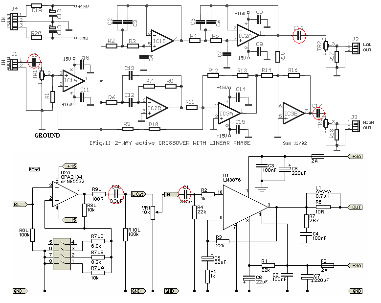

but do you mind to teach me more detail about how to check the cap in signal path or not signal path.

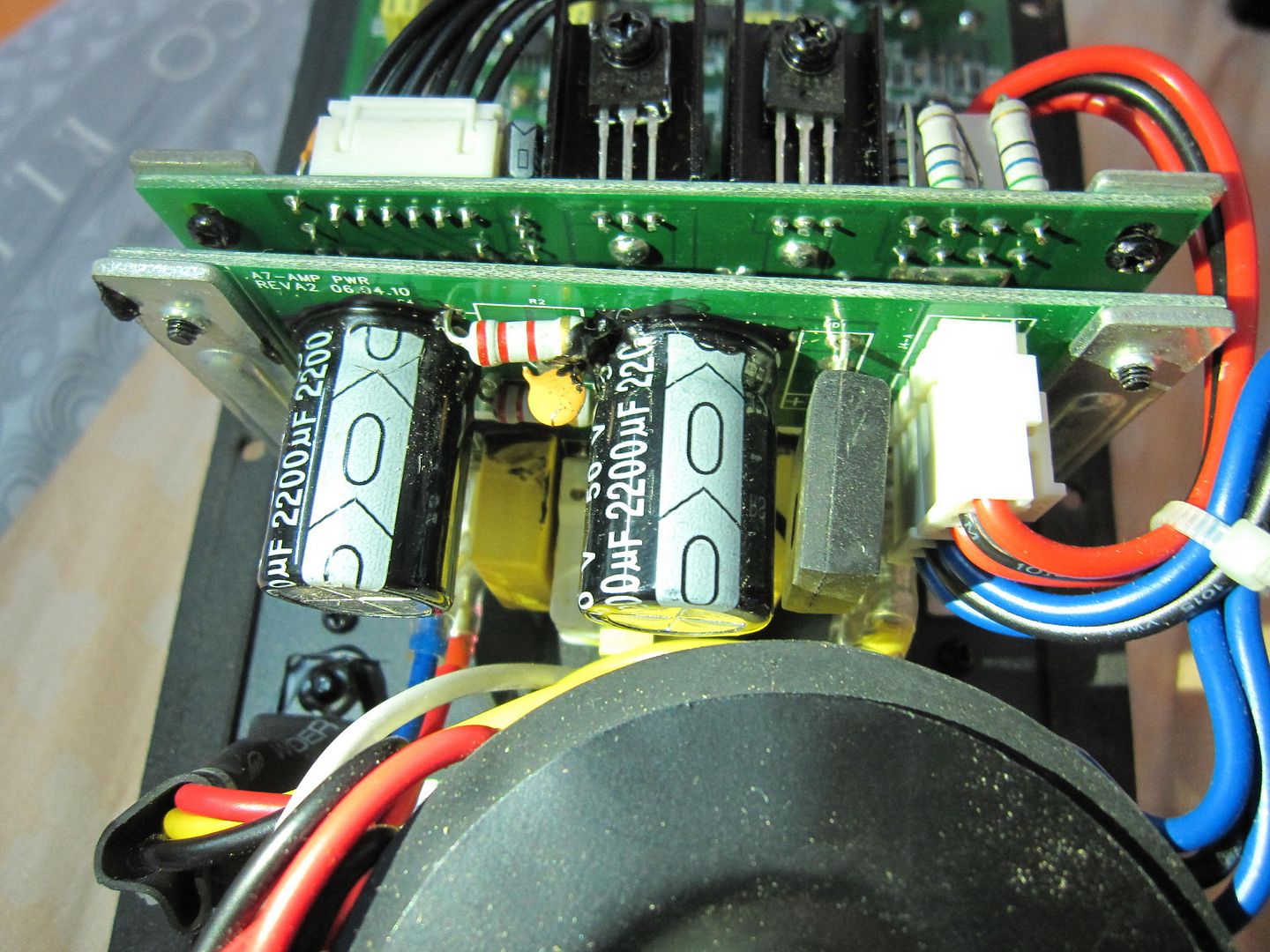

also, in the power amp section , it has 4 of cerafine 1000uf 25v cap. is it power filter cap?
thanks
Yes. One in +V, one in -V. Four for stereo.
In signal path, none of the cap ends goes to ground. They are usually in input or output of the opamp. So for opamp, check on pin#3 (or pin#2)
In attachment, input cap is circled in red. Sometimes, to save space, electrolytics (usually of too high value) is used there.

As you can see from LM3876 above 3u3 input cap is sufficient. I don't know what IC in your amp is. If it is the LM3875, then the cap on pin#7 or #8. I can see that you have electrolytics there, around 47uF-100uF. Better is MKP 2.2uF but the size is big. If electrolytics, better use NP type (non-polar)
