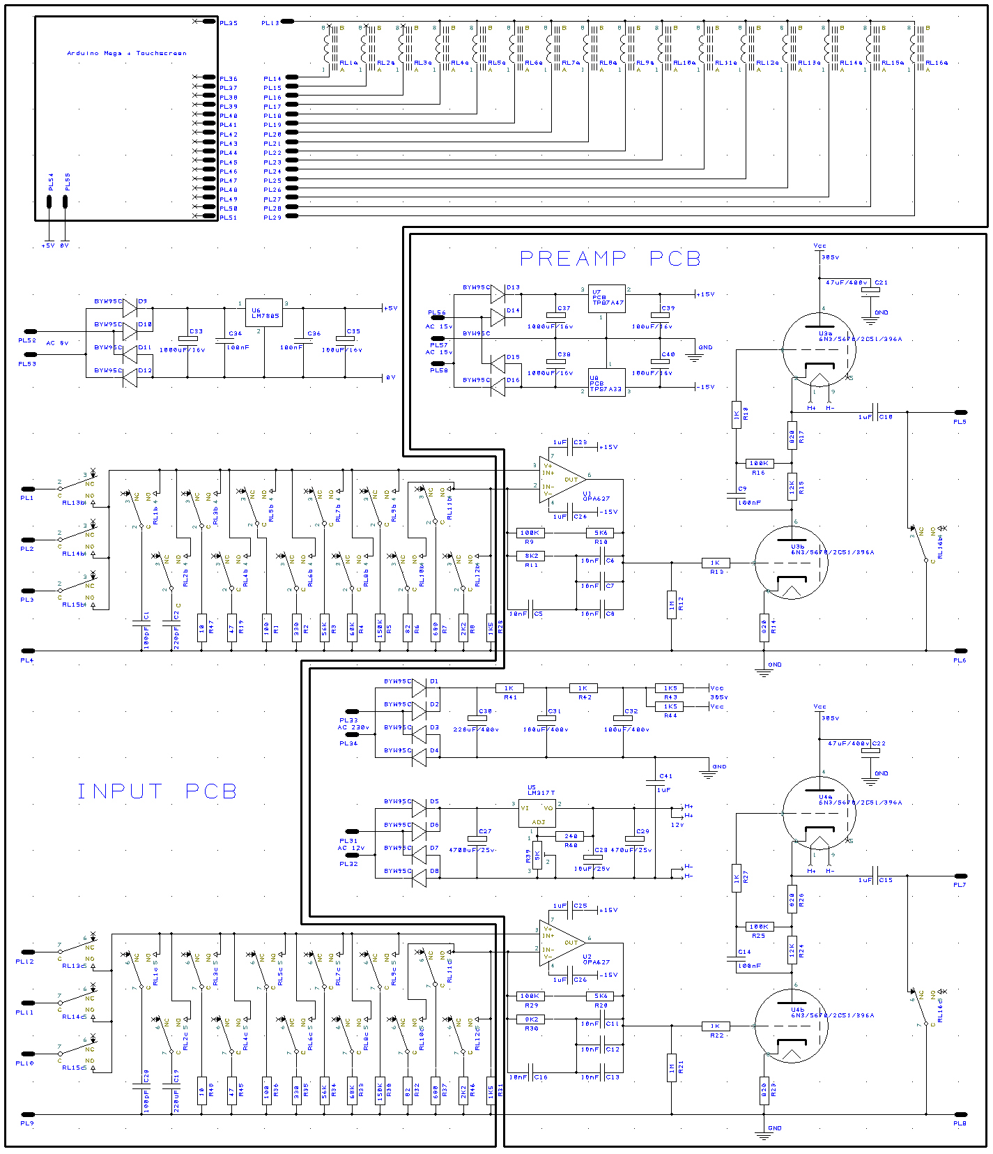

The two IC pinouts are drawn wrong. Pin 2 is inverting input not pin 3.
If it is wired like your schematic, where is the feedback loop on the ICs?
Thanks, my fault.

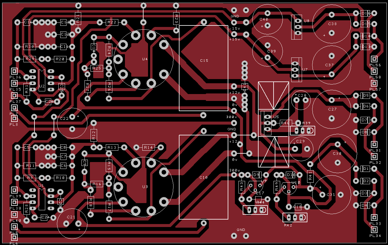

Today i designed the preamp PCB to test the prototype.
You can devide the PCB in two. Between preamp and powersupply.
Tubesockets can be mount on bottom or top side.
Changed schematic with better anode supply for tubes.

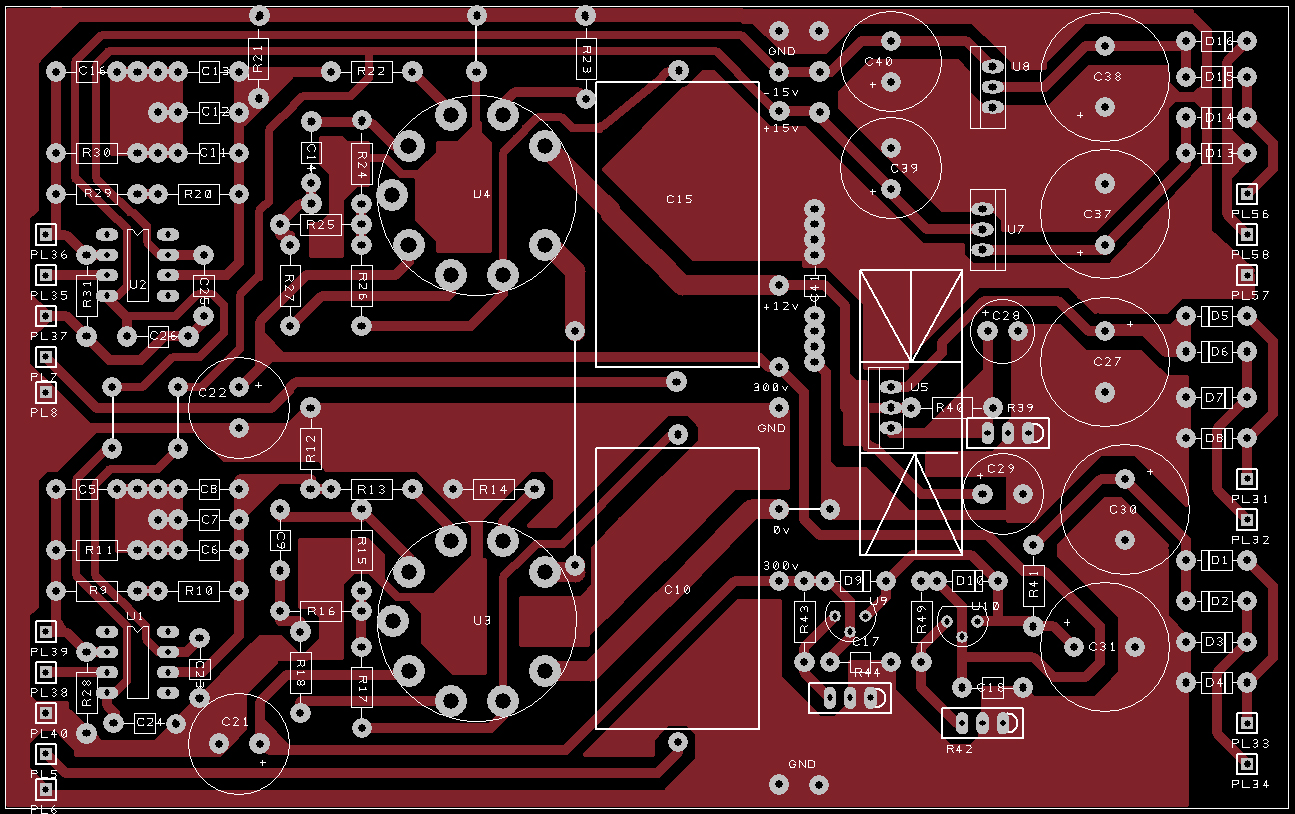

Thanks , it is good that i not have ordered 100 PCB's.😉
I connect the heaters in serie to the 12v as in the phonodude design.
I will change the pcb design and schematic.

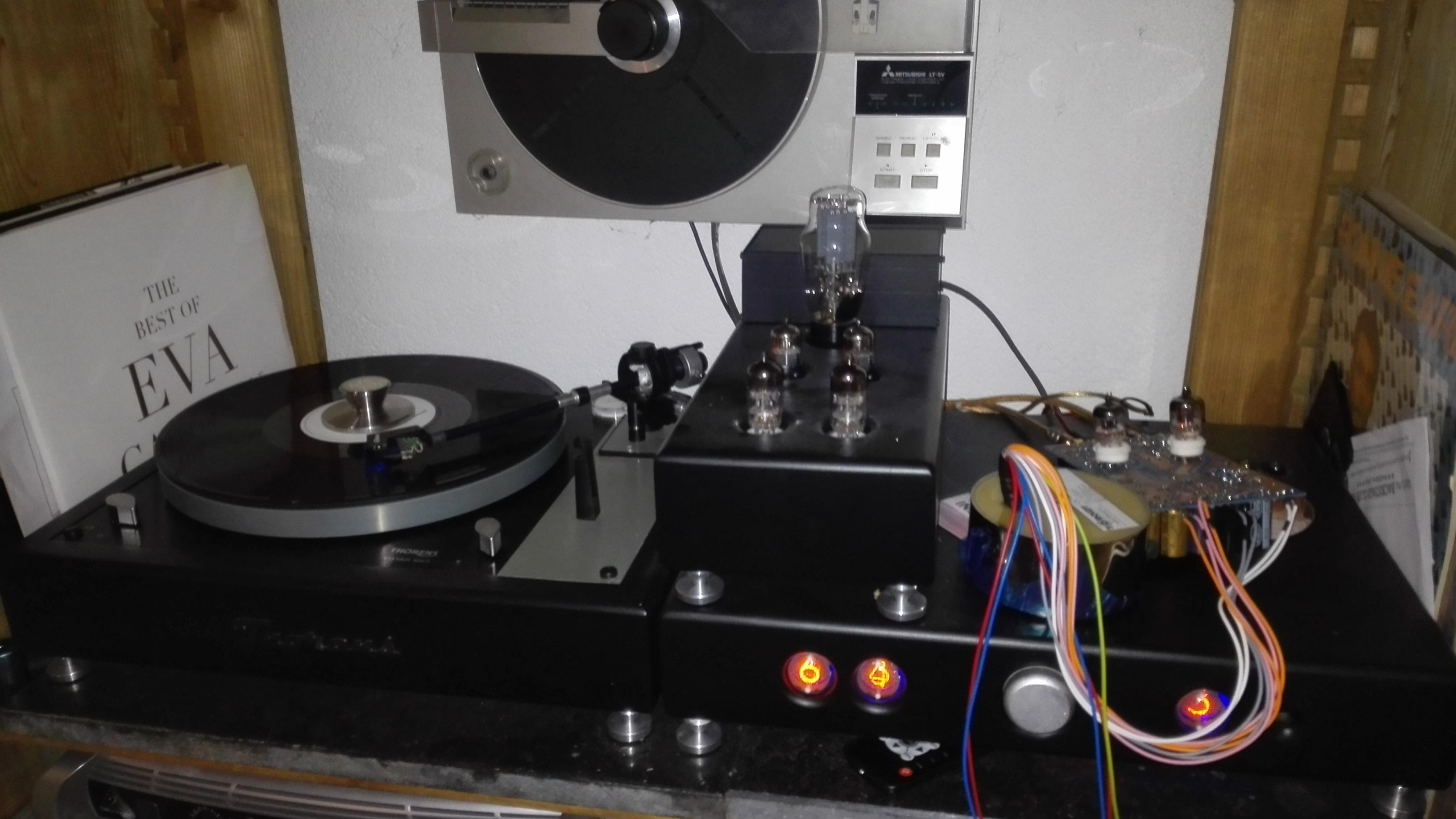

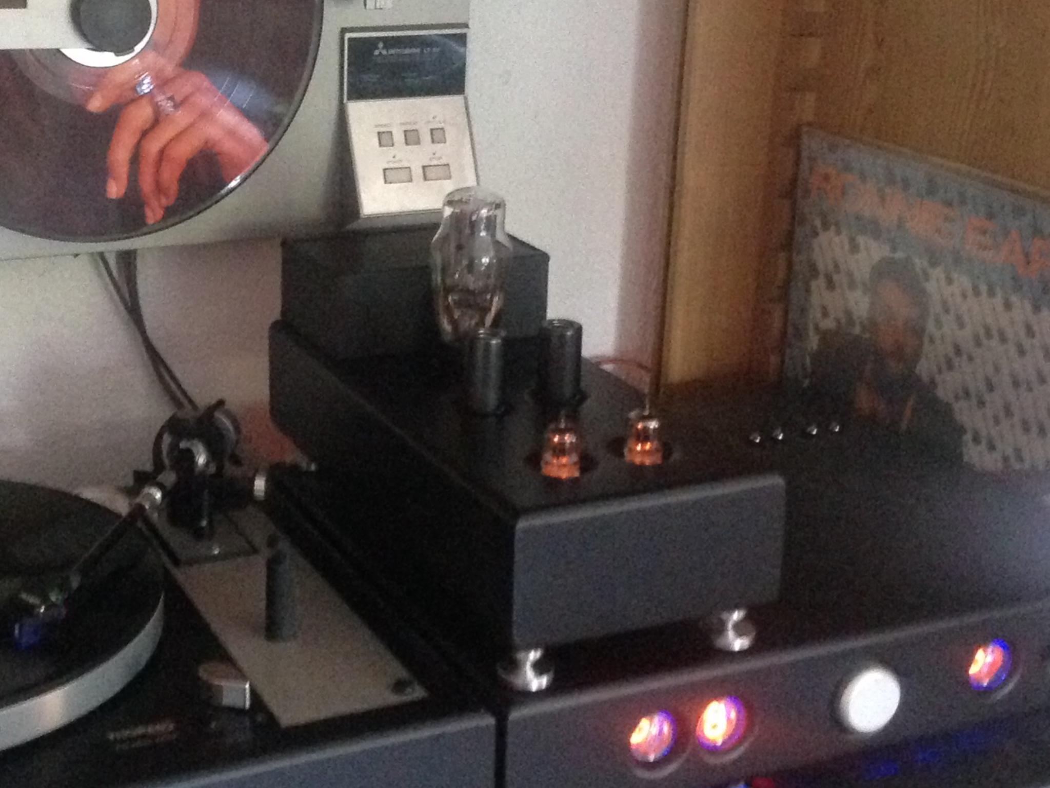

Today i had time to complete the soundpart. Tested it with my thorens TD160 mk2 modded and a ortofon 2m blue mm cartridge. One thing i noticed direcly, background is death quit. Like a battery operated preamp. Riaa frequency respond is within +/- 0,5db. First soundimpression without impedance tuning, tight, dynamic and big sound stage. Very promising. Hopely i can compleet the comfort part in the next view weeks.

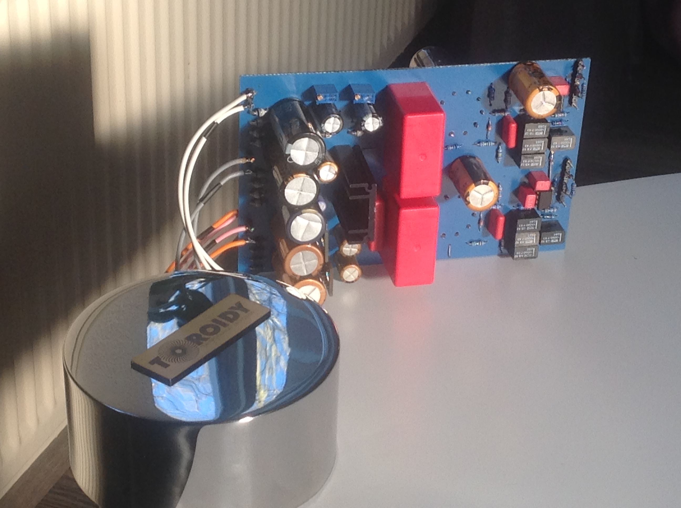

The transformer which is custommade works great.

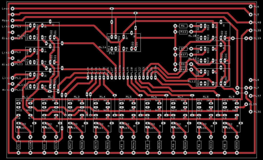

This afternoon while listen to Eva Cassidy and Ray Charles i designed the comfort part. See picture below.
After rolling some opamps and tubes i prefer the AD847 and Bendix 2C51 combination for the sound part.
The phonopreamp is ideal for rolling opamps and tubes.

I have build the comfort PCB. Still listening every day to the sound part. Next i test the comfort PCB just with manual control after that i need to program the arduino software. I have a arduino mega 256 with colourtouchscreen.
The housing i also need to make myself from 25mm mdf. I think i still needs 1 or 2 months to complete this project.
