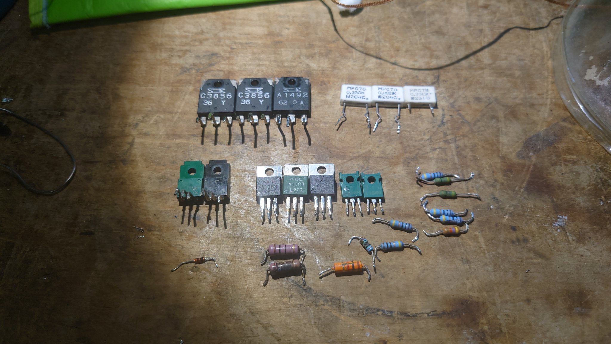

I just got a new (old) ta-n80 es amplifier and I had cleaned it, recalibrated it and thought I had it working, held the bias well, came out of protection etc. So I go to test it and get no sound. I tried a few things but nothing worked so I pulled the left channel input and put that into the fixed left input while the right channel was still in the variable input I also disconnected either just the left channel, or both I do not remember 100% from the pre amp while still keeping them connected to the power amp to see if tapping the connectors would produce anything. Before I could even try tapping the connector the amp almost immediately started smoking and shot into protection. After this I pulled it out with a heavy heart and started disassembling to see what went wrong. I found out that the driver transistors for the left channel, three of the six output transistors for the left channel, one of the 10 ohm emitter resistors, a zero ohm resistor and the left speaker relay had all gone. While very annoying especially after just spending a bit of money on this amp this is all fairly easy to replace even if the transistors might not be cheap. However I am making this post mainly to ask why this happened. Is the screwing around with the inputs the reason for this? I do not really understand why this would be an issue but admittedly I do not have a ton of experience with a/b power amps. I had it running on idle for atleast an hour to adjust the bias and it showed no signs of issues. I did redo the solder joints for the transistors but I checked for shorts or otherwise unwanted bridges and found nothing. And the 1 hour plus idle session was after this. While I had no sound during testing I also am not familiar with the setup and it is very possible I just connected something incorrectly. Since the dc offset adjustment was working I doubt that there was a relay that wasn't engaging or otherwise something obstructing the signal. I checked the manual on instructions that might caution the user to not use it in the way I did but I did not find anything like this either. Ofcourse that doesn't have to mean much but if there was such a confirmation I would feel much more at ease with repairing the amp by just replacing these components.
After some more searching and reading I figured out that the d312 diode is also gone. I have read that it is unobtanium but I am sure that some modern replacement will work.... The same diode on d311 is not shorted but it gives some unexpected readings (1.7 voltage drop one way, 0.3 the other) so I think I probably will have to replace both.
I will check all the other fusible resistors for shorts but for now I am planning to order:
Q404 2SA1306A-0 (toshiba) -> MJE15033G (onsemi)
Q403 2SC3998B-Y (toshiba) -> MJA15032G (onsemi)
both C3423 transistors read ok with a multi meter so I do not believe they need to be replaced.
C3856 (sanken) -> 2SC3856 (sanken) if chip one stop allows me to order there, otherwise 2SC5200N (toshiba) (non obsolete version of a transistor successfully used on a thread from years ago). I can also order these from digikey but they do not have the A1492.
A1492 (sanken) -> 2SA1492 (sanken) same story with chip one stop, otherwise I will probably opt for the 2SA1943N (toshiba)
As for the known bad resistor I will just order whatever is available locally that has the correct specs of 1/2 watts and being fusible. I am not sure yet if that is all that needs to be replaced. Input on this regarding the cause of the problem would be really helpful.

@Citizen124032 thank you for taking the time to try and help me. I have since tested all the resistors on both mainboards and the protection circuit and I found some more defective components.

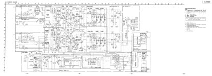

@madis64 I bought a ta-n80 that was working. I brought it home and calibrated it which went fine. I hooked it up in my set up and turned it on but did not get any sound. I eventually decided to connect the left channel to the fixed input while keeping the right channel on the variable input. I also disconnected the cable from the pre amp. When I did this the left channel started smoking and the amp went into protection. I disconnected everything opened it up and I have now found the given list of defective components. My questions are as follows:
What would have caused the amp blowing up? Would me screwing around with the input cable be able to short the amp ? I would normally expect such behavior from a speaker terminal short instead. I had the amp on idle for an hour without issues while it kept a stable bias.
Of the mentioned defective components there are quite a few that are no longer available in their original form. I have found some possible replacements from reading a bunch of ta-n80/77 repair threads but I would like some input on whether they are ok as replacements or not, specifically the zener diodes.
There are also a few components I have yet to find replacements for, tips regarding those would be great as well.
For the final question I would like some general advice. I am not sure what to do with testing. I would like to prevent more damage but the dim bulb tester I have uses a 60 Watt bulb. I also do not know whether some of the components I have tested are actually ok or not.

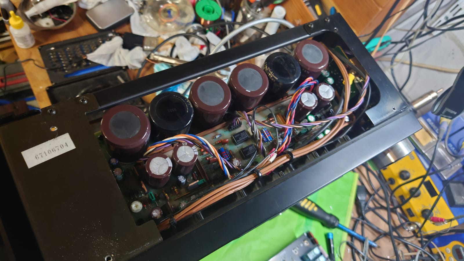

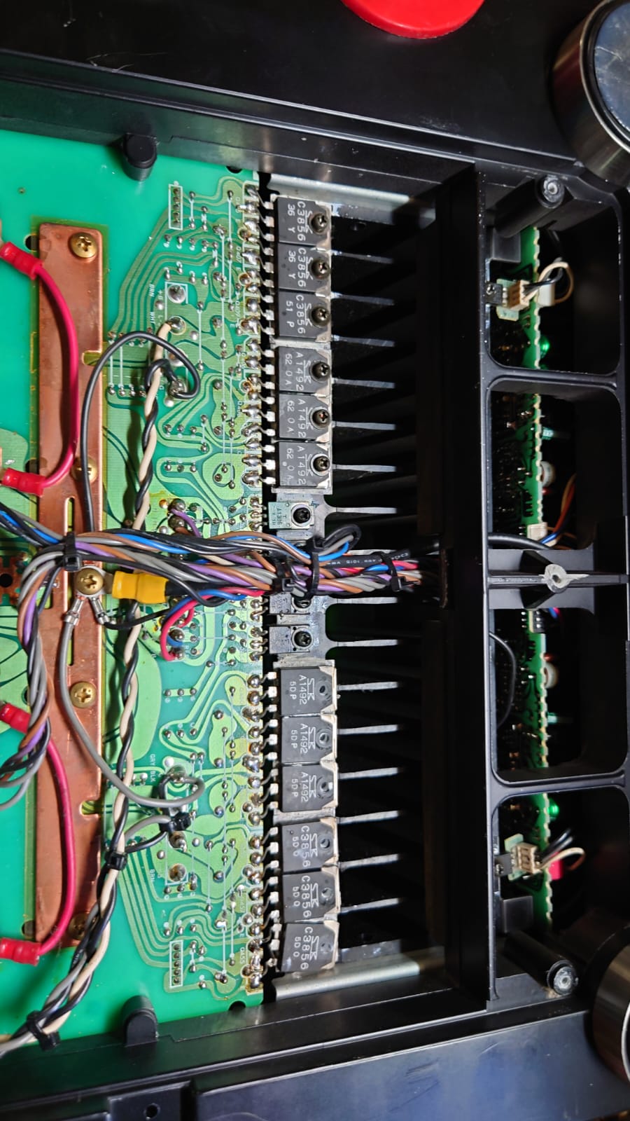

Can you upload some photos of the amplifier internals? Sometimes it helps to understand the playground.
That could have invoked RF oscillation...I essentially connected a cable to it with nothing as the input
Been there, done that...
I am pretty good at soldering. I have repaired amps before but usually simpler designs from the 70s and it is also most definitely not my forte, I mainly work on record players. I do not know what THT is. I was able to calibrate the dc offset which to me indicates that a signal was going to the speaker terminals. I have some pictures of the boards but the amp is now in pieces so pictures of the internals might be difficult.What exactly are your skills and technical capabilities - DBT, DMM, scope, soldering THT/SMD...?

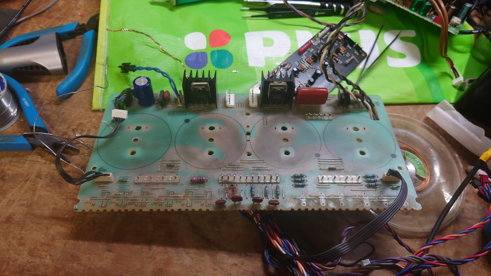

Before I changed the thermal paste for the transistors:

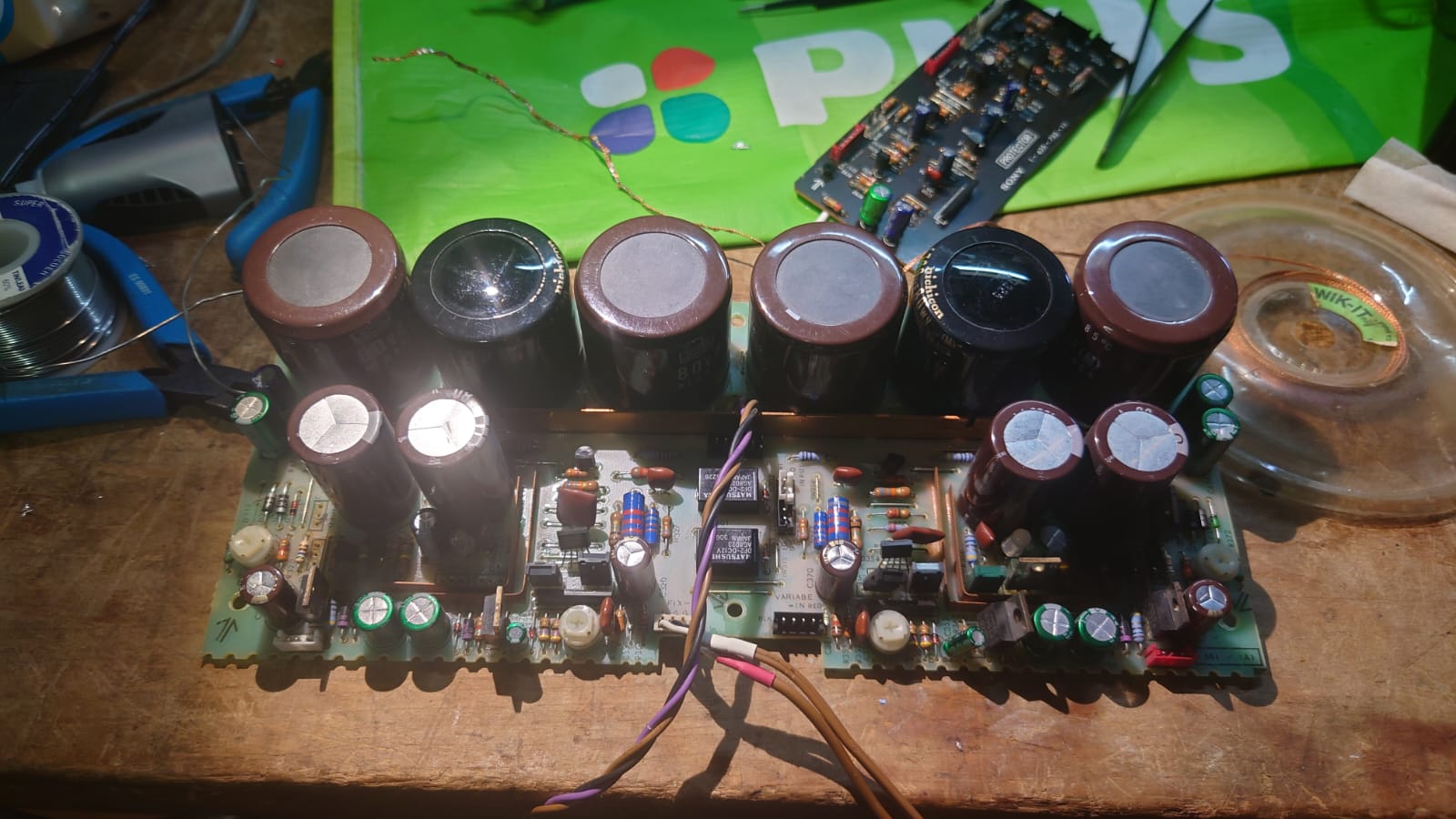

The two main boards after removing the broken components:
I believe that the amp has been repaired before. The driver transistors weren't all the same as the ones listed in the service manual and some of the resistors are different even if they are measuring correctly. The thermal paste was also still wet, so I cannot imagine that it has been long since it was last changed. There are some resistors, mainly next to the two relays on mainboard a and on the protection circuit that differ from the service manual. However since both channels have the same exact differing resistors I assume that the modification was made with intent and makes sense...

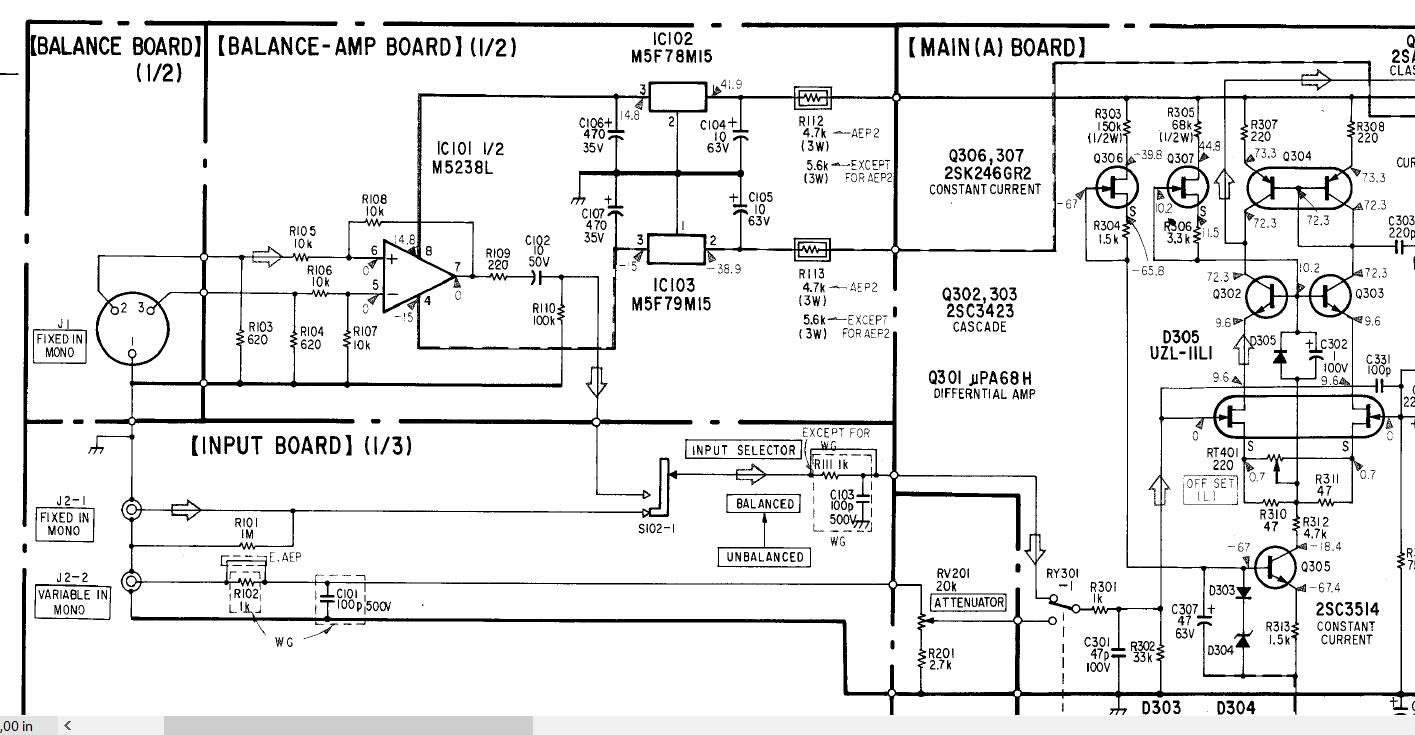

D312 HZ3A1L zener approx 2.5 - 2.7 Vd312
Check for the Idss by connecting the gate to the source (Vgs=0V), a 9V block battery and a mA meter (drain to plus, gate-source to minus).UPA68 Dual N-Channel JFET
A faulty polar cap can take the amp down. Recapping might become neccessary.As for the actual reason this happened, I am still not sure.
pre drivers...Q401 2SC3514-Q
Q402 2SA1383-Q
VAS cascode...Q308 2SA1360-0
Q309 2SA1383-Q
Temp comp for bias...Q312 2SA1360-0
Protection zeners...D311 hz3all X(maybe)
D312 hz3all X(maybe)

RF... (#12)
Instability caused by...?
Check all polar caps and/or replace in advance - use tropical grade (105°).
Solderings, continuity, wires, connectors, &c.
You can use two bulbs of 60W in parallel for a suitable DBT.

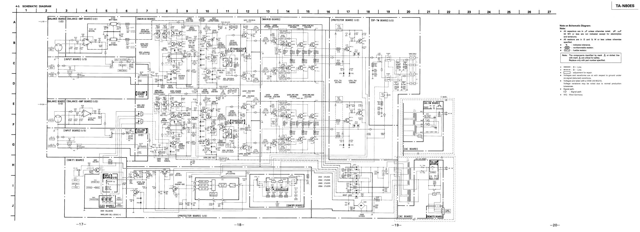

A magnified & separated circuit diagram.

I would not recommend that, as this arrangement is a (fast) Sziklai video buffer in a bias application. Q313 is set at 1mA defined by R320, so Q312 takes the extra amount of current. This makes Q313 more sensitive to temp changes.bypass the 1360 in the bias circuit
Thank you, I have now ordered the onsemi MJE350G as a replacement and the onsemi MJE340 for the complementary 2sc3423. I have ordered a bunch of spares as well.I would not recommend that, as this arrangement is a (fast) Sziklai video buffer in a bias application. Q313 is set at 1mA defined by R320, so Q312 takes the extra amount of current. This makes Q313 more sensitive to temp changes.
I would first check all transistors and resistors (many of these are marked as fusible ones) in the power amp section starting from the back end and working towards the front (until the input stage). That would give you the scope of damage.Would you say that it is better to first recap it before testing? I would like to avoid changing too many things at once because if I make an error along the way it could be hard to figure out why what happened happened. Should I replace all the electrolytics?
And then I would replace - without thinking twice - all lytics except the big ones.
Thank you for the suggestion. I have done this and I have already ordered replacements with plenty of spares, wasn't cheap though, it is annoying that I could not find everything in one place but that is also kinda on me for not being patient enough with finding the proper modern substitutes. I will first replace the defective parts and attempt to turn the amp on with the DBT. If this is ok I will test it and if it tests ok I will probably replace the smeller ecaps like you suggest.I would first check all transistors and resistors (many of these are marked as fusible ones) in the power amp section starting from the back end and working towards the front (until the input stage). That would give you the scope of damage.
One thing I found is that
The mystery regarding the no sound has been solved. I just went up to check if there are any weird issues as I had not touched my setup since the amp had blown. Everything was ok no speaker wire shorts etc. So I grab my ta-4650 to use as a power amp with the e80es and wouldn't you know it, no sound. Turns out I had not pressed the output on button on the pre amp..................................................... So yeah that is the reason there was no sound.The main problem is in your initial posting - you had no sound. Now you need to find a cause of that (in addition to the release of magic smoke).
