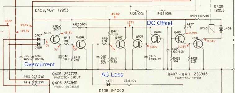

First you need the service manual, which is HERE
It sounds like it's locked in protection mode.

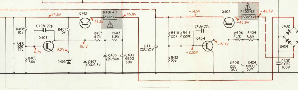

First thing check Your supply voltages ... +45 and -45, +14.5 and -14.5, at the test points indicated on the schematic. Make sure they're all correct. See the attachment below.

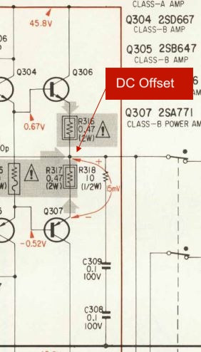

Next you need to check for DC offsets at the amplifier outputs on each channel. This should be very nearly 0 volts. I marked the test point on the attachment below.
let us know what you get...

They might... but looking at the schematic I see only 3 things that would cause that relay to drop out... DC offsets, loss of AC power or overcurrent. I think it's best to explore those causes first.
These checks can all be made from component leads on top of the board. So lets not tear it down until we have a reason to...

I'm attaching a snip of the protection circuit. I've marked the functions of the various sections in Blue.
First lets be sure we have good power supplies and no DC offsets.

First phase : Q401, Q402, Q403, Q404 measures
Q401 : emitter 15,27 V, collector 47 V
Q403 : emitter 5,84 V, base 6,4 V
R401 : 47,2 V
Q402 : emitter -14,98 V, collector -47,7 V, base -15,6 V
Q404 : base -0,58 V, collector -15,6 V
R402 : -48 V

For example with the thumbnail I gave you for DC Offset... look at the schematic, note that point is between R316 and R317 also R318 ... if you locate any of those parts on the board, you can use your probe on their legs as a test point. The other channel will have a similar point where you can probe it.

You noted an erroneous reading on the base of Q405 ... Looking at the schematic, I would say this is actually an error on the schematic and your readings are correct. The base of that transistor is fed by D407 and D406 which in turn monitor R413 and R414. Both should sit at nearly the rail voltage unless there is a problem with too much current being drawn. So lets double check that to be sure... Take readings to ground from the cathodes of D407 and D406, both should be within a volt or so of the positive rail.
Next, on the pcb locate R423 and R422. If you follow the schematic you will see these resistors monitor the DC offset from the two amplifiers... I need readings from both sides of both resistors. Reading to ground, you should get almost 0 volts on all 4 points. Stay with each reading for a good few seconds to be sure they are stable.
Finally we need to check the AC monitor. This is fed with D408 through R418. Take a reading on the anode of D408. Again stay with this for a few seconds to be sure it's stable. Now take a reading from the cathode side... this will be an AC reading.
Finally lets check the relay itself. On the schematic you will find D409, which is directly across the relay coil. Take a reading from both sides of this diode and stay with it for a few seconds to be sure it's stable.
