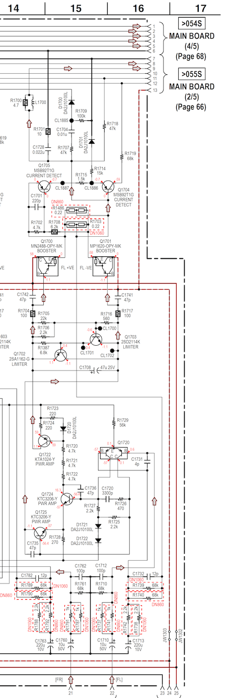

I've got a Sony STR-DN1060 which blew one of the FL channel transistors the other week. I've replaced the pair and the matched double ceramic resistor. Put it back together and I'm still getting a protector error after about 10s.
I have the schematics for it. I've stripped it back down (repeatedly) and checked the resistances across the resitors in the current detector circuit on that channel (R1700-R1719), all look ok. I've checked the fuses (all OK), and D1700 and 1701, also check OK.
Any ideas for where to go next please?
I have (re-)checked the replaced transistors, and they aren't dead-shorts. Not checked them for a day or 2, but can do again. I've not measured the output DC offset, reaching the end of my experience, please can you explain how to?

You can measure DC offset anywhere from midpoint of the 0.22 ohm resistors to output inductor, Zobel network resistor to protection relay input - depending on what's easiest to reach. You are looking for a DC voltage to ground, which should be within +/-100 mV if the amplifier is operating normally.
When an output transistor has gone up, typical further damage includes:
* corresponding driver transistor
* input LTP transistor on the feedback side
* electrolytic cap in ground leg of feedback network (often a very low-voltage part of several hundred µF)
Might be one of the latter two. If you cannot find anything, look for any other components that measure out of the ordinary, like shorted diodes.
Once you find the remaining fault(s), be sure to check and adjust output transistor bias. Things usually don't blow up by themselves.

It's a Darlington output affair, so no discrete drivers.
Suspect capacitor: C1713 (220µ/10V)
Also check R1738 & R1739.
The style of this schematic is really confusing.
Double transistor Q1720 is the input LTP.
Then it goes into another differential amp made up of Q1724, 1725 with current mirror D1720-R1723-Q1722-R1724.
The output is coupled out of that, Hitachi style. The "limiter" transistors Q1702, 1703 have got to be the bias spreader, I don't see any other good candidates.
This kind of topology (though originally not with monolithic Darlingtons) has been around in Japanese gear since about 1977.

Home late last night. Tested c1713 in circuit and it's resistance didn't rise to infinity in the way they normally do. So I figured you were probably right and it was duff and took it out of circuit. Tested it again and it's now fine... I'll try and work on the rest later tonight unless that points you in a direction of a problem.
