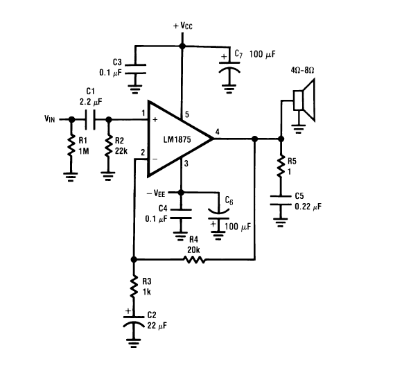

Then as I’ve started reading I’ve realised that it’s probably fairly simple to directly replace the dead STK with a couple of either LM3886 or TDA7294. Could anyone offer some tips/pointers here?

It does sound like the STK is at fault. Never come across that particular variant but generally yes, its always the STK.
Although either of the chips you mention could be used I'm going to say a couple of genuine LM1875's might be an easier option and essentially all you need do is tweak some values and decouple the chip (I would do this) directly across its supply pins with say a 10uF 63v cap.
No guarantees but I bet it could be an easy conversion.

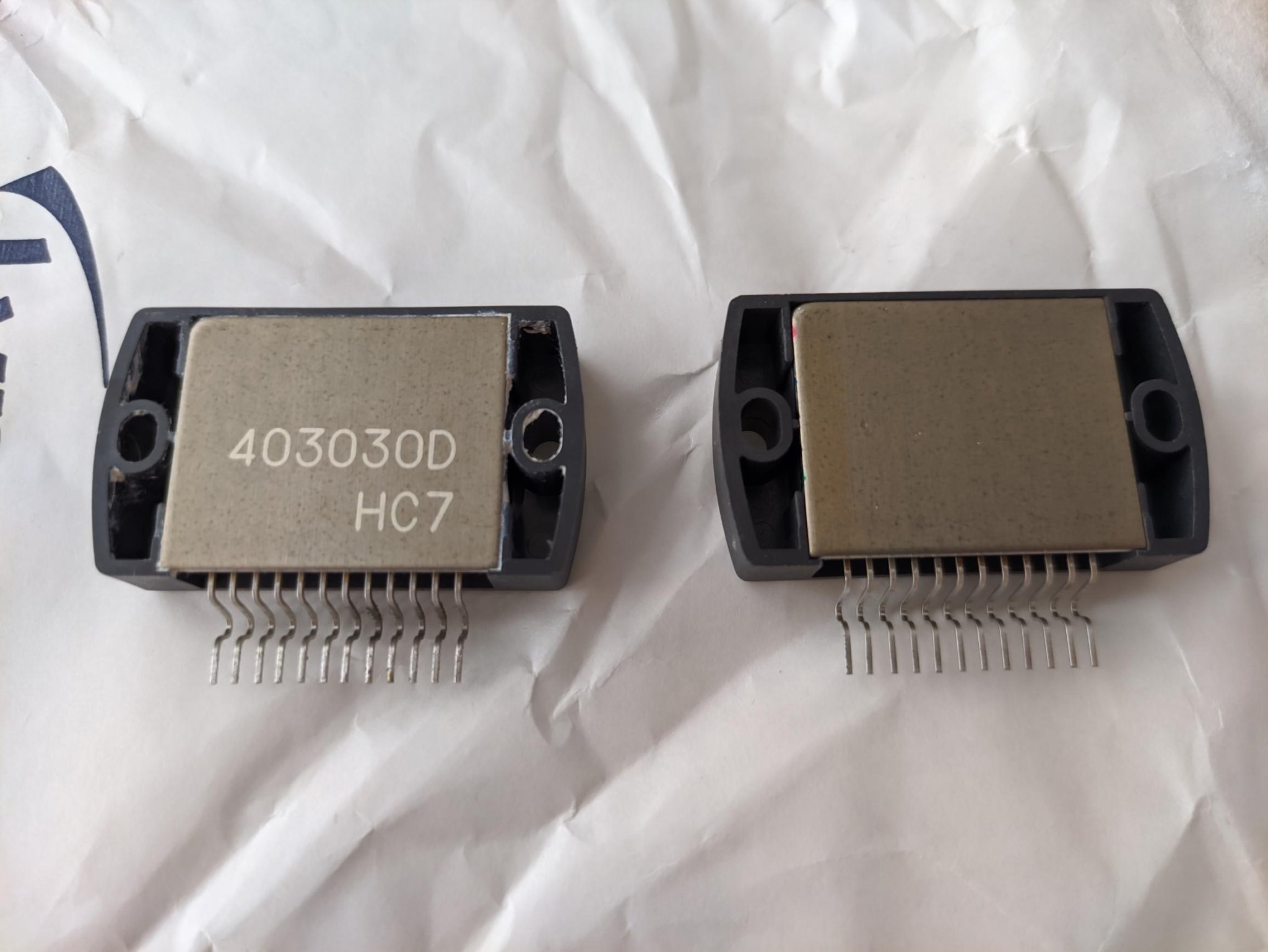

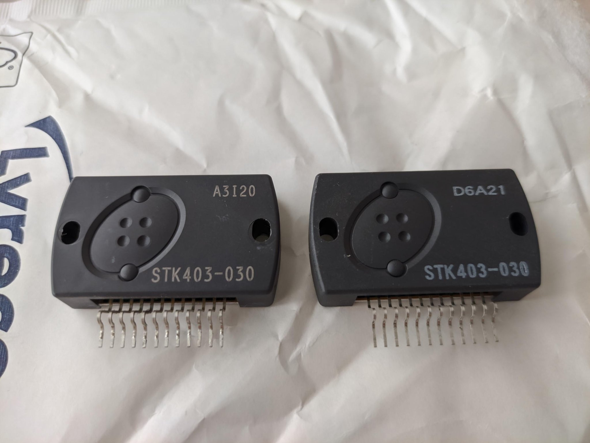

I managed to get a resolution on this…
As much as the idea of a little project to convert this to a pair of different amp chips appeals to me, with a 3 year old and 3 month old, it just wasn’t going to happen. So I figured I’d just buy the replacement STK from ebay and if it didn’t work or whatever I can get my money back easily. Then I’d buy another stereo, shove this one in the loft and come back to it in a few years.
Replacement turned up and except for the different printing of the part number on the front and the lack of etching on the back, it visually is indistinguishable from the original. Weight within a fraction of a gram the same.
Original on the left, ebay special on the right.
Soldered it in and used some CPU paste between it and the heatsink and… success. Is it a fake? Who knows? Maybe, maybe not. Either way it works and to my ear it sounds the same as the original although this isn’t high end kit and I’m not an audiophile. Perfectly fine for its purpose though.
I am intrigued by the counterfeit STK phenomenon though. I find it hard to believe that anyone would bother counterfeiting a module that doesn’t seem to have a demand. Cannot find a datasheet anywhere, cannot find any mention of it in relation to any piece of equipment it was used in. As far I can tell my system is the only device it was ever used in. All really odd.

Well that's great news (y) The more oddball (and particularly physically) a part is and the harder it is to fake so a very good chance it is what it is supposed to be. Things like the 3 square corners and rounded 4th corner of the metal tab also tally between the two.
