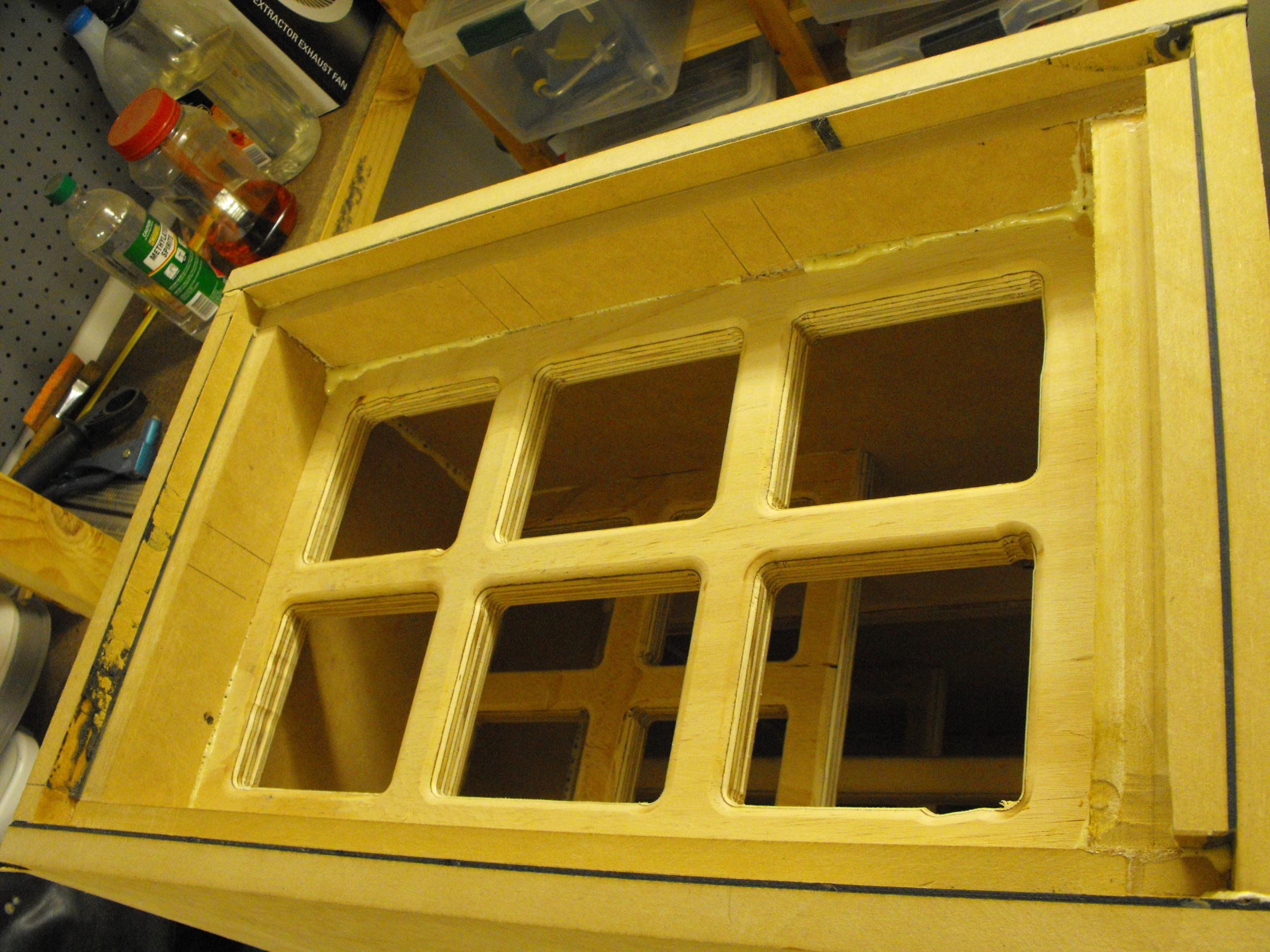

Dimensions of all the bracing (locations, cutouts, thicknesses, etc.) too.Dimensions: 11" x 37.5" x 16".

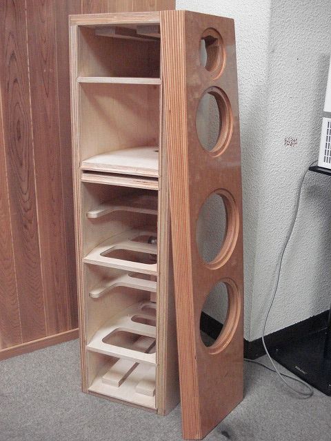

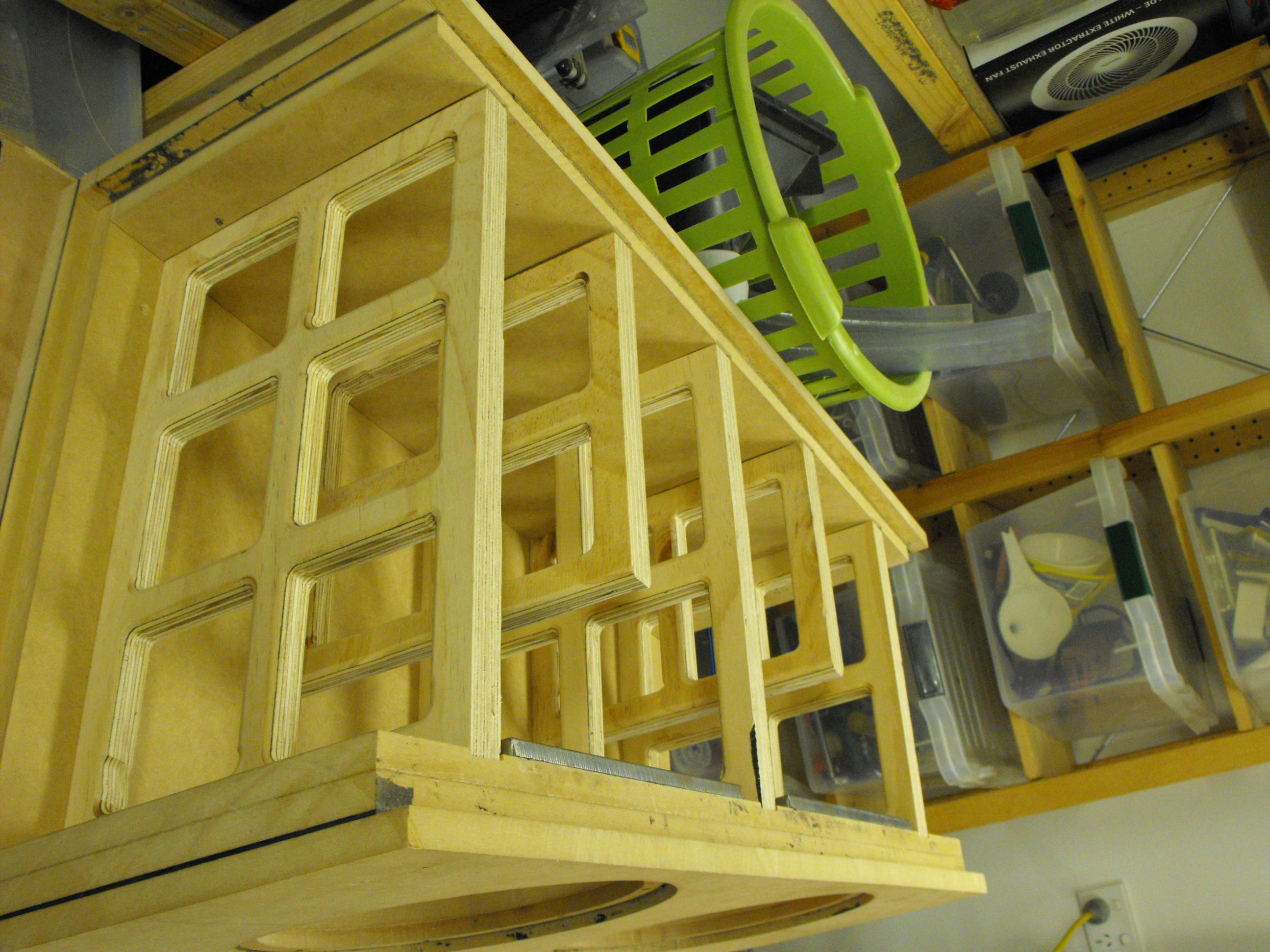

I would go further. Your cabinet can't be too stiff. Here is what I did. Notice the last shelf brace is itself braced against the end panels. Don't use mdf for bracing. 1" ply is much stiffer after cut-outs.Hi,

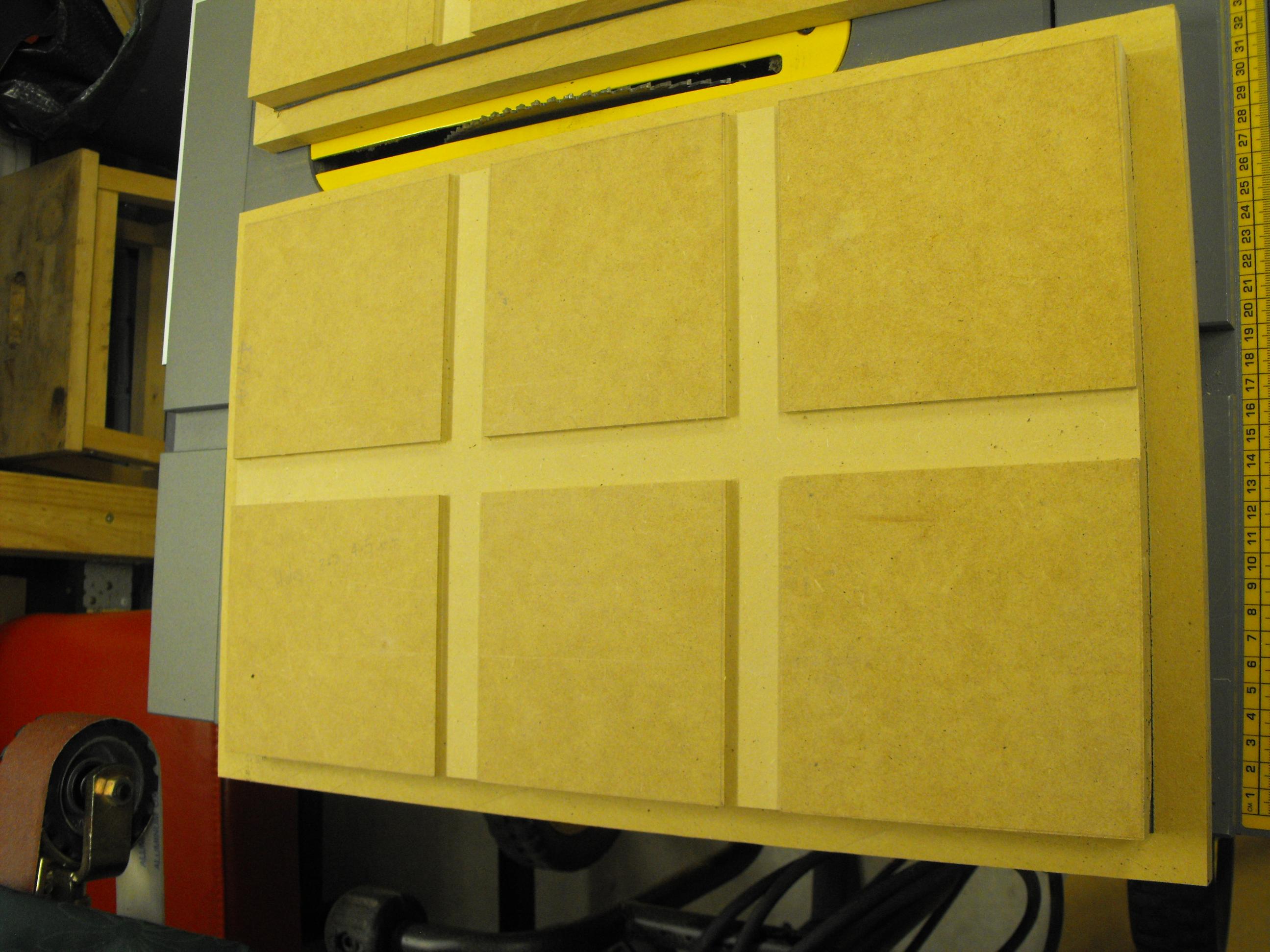

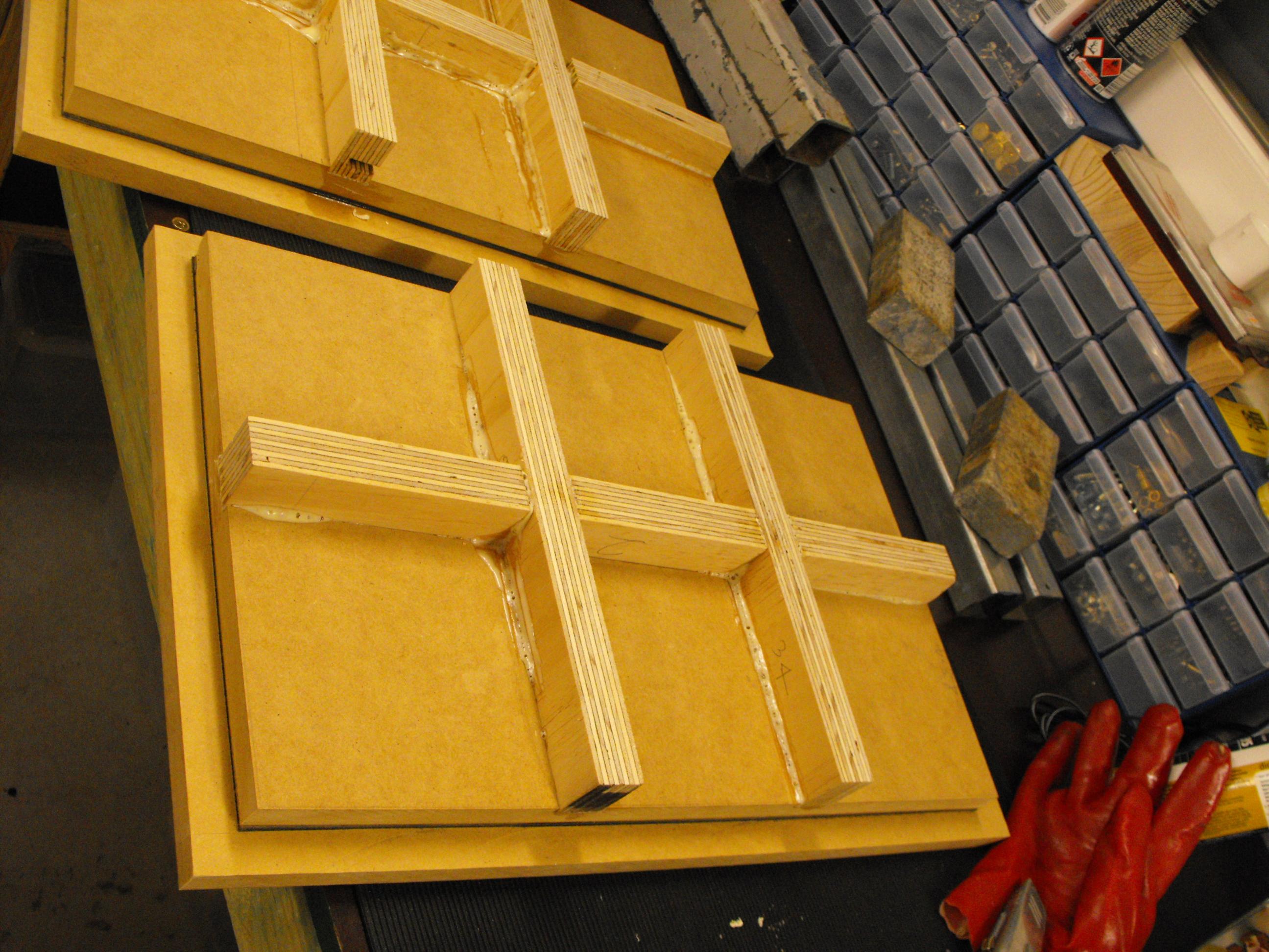

Using 19mm and 30mm BB ply. BTW those braces are a work of art.
In my quest for stiffness (sounds like an adolescent dream), I'm worried about too many braces causing a significant reduction in volume.
