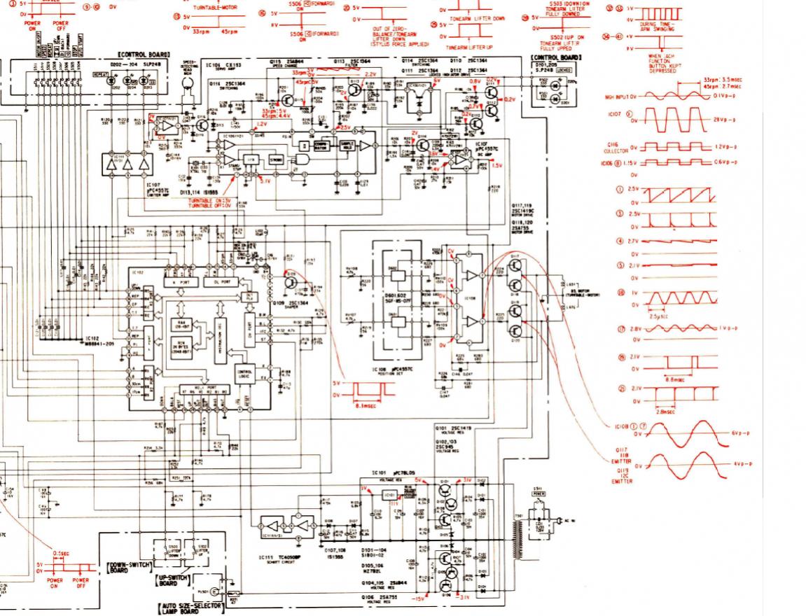

I attached mainboard and block diagram from service manual(schematic seems too big for upload but I will try somehow to shrink it).

According block diagram Servo Amp is dead.

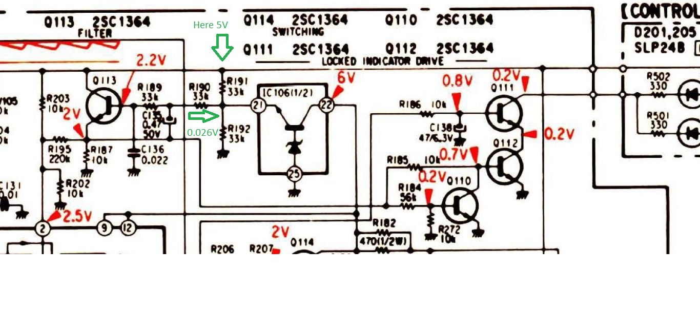

Here is a part of schematic , regarding NOK voltages from servo amp where voltages are wrong.
I can not upload full pdf file,exceeds the limit for upload.
On IC 107 I have + / - 15V on pin4 & pin8 but 0V on pins 5,6,7.
On IC 106 there is 5.64V on pin22 but 0V on pin 6 (should be 5.1V)
On Q114 there is B=0V.
Wrong voltages on Q110,Q111,Q112 (see post#1)
Bogdan

More measurements results:
On IC 106 (CX193) :
- pin2 = 2,36V
- pin5 = 0V
- pin6 = 0V
- pin7 = 2,7V
- pin9 = 5,64V
- pin12 = 5,64V
- pin21 = 0,026V (wrong ? )
- pin22 = 5,64V
On IC 107 (uPC4557C)
- pins 4&8 = +/- 14,64V
- pin5 = 0V (wrong?)
- pin6 = 0V (wrong?)
- pin7 = 0V (wrong?)
On IC 108 (uPC4557C)
- pin1 = - 2,5V
Q114 with B = 0V , E = 0V
Q110 with
- B = 0.032V (should be 0.2V)
- C = 0.19V (should be 0.7V)
Q112 with
- B = 0.19V (should be 0.7V)
- C = 0.86V (should be 0.2V)
- E = 0V
Q111 with
- B = 0.005V (should be 0.8V)
- C = 3.55V (should be 0.2V)
- E = 0.68V (should be 0.2V)
Attachement from the schematic below.
Is the CX193 dead or what?
regards,
Bogdan

It's still odd not to be seeing anything at IC106 pin 21. If the pictogram is anywhere near accurate I would expect the 2.2 V out to be present at all times as long as +6V and ground are applied. Might be a dead chip - a fault noted for the PS-X45, for example. Not an easy one to find, unfortunately.[/QUOTE]
Checking for voltages at pin21 of CX193 and trace back shows that pin21 is feeding from pin 34 of MB8841-327 where I have 4,9V.
I have also 4,9V at one end of R191.
At the other end of R191 there is 0.026V (same at pin21).
Maybe bad resistors R191 , R192 , R190.
I didn"t pull them out but measurements on mainboard shows that only one is 33K , 2 of them shows 17K.

Replaced R191 , R192 and R190 with new ones and still 0,026V at the other end of R191 and pin21 of CX193.
All were OK when measured off the mainboard.
I dont"t understand : if enter 5V on one end of R191 and R191 with R192 is a voltage divider (both 33K) , why not half voltage is present at their middle junction?
Normally this should be dominated by the regulator inside the IC... which in turn may be shorted to ground.I dont"t understand : if enter 5V on one end of R191 and R191 with R192 is a voltage divider (both 33K) , why not half voltage is present at their middle junction?

Resuming the symtoms of the turntable after more checkings:
1)The platter spins in any direction of manual push (could be backwards or normal spin).
2)When spinning normally , apparently reach speed of 33 RPM (not shure , it looks like).
3)When spinning backwards , apparently try to reach more speed (after a while).
4)Motor don"t spin by himself if rotating ax , only with platter assembled
5)A low noise coming out from motor when spinning (something like Wau-Wau-Wau , a sinusoidal noise , louder in one specific point and lower in rest).
6)Motor start to spin imediatly after pushing "Power ON" button --> no other button works
It seems that only one coil is working inside (just a though) --> motor has 2 coils according schematic and other posts from other users.
Full recap of the mainboard with Nichikon and Elna caps in progress --> small delay of this job due wrong ordering (bipolar caps instead of elytics caps).
Bogdan
