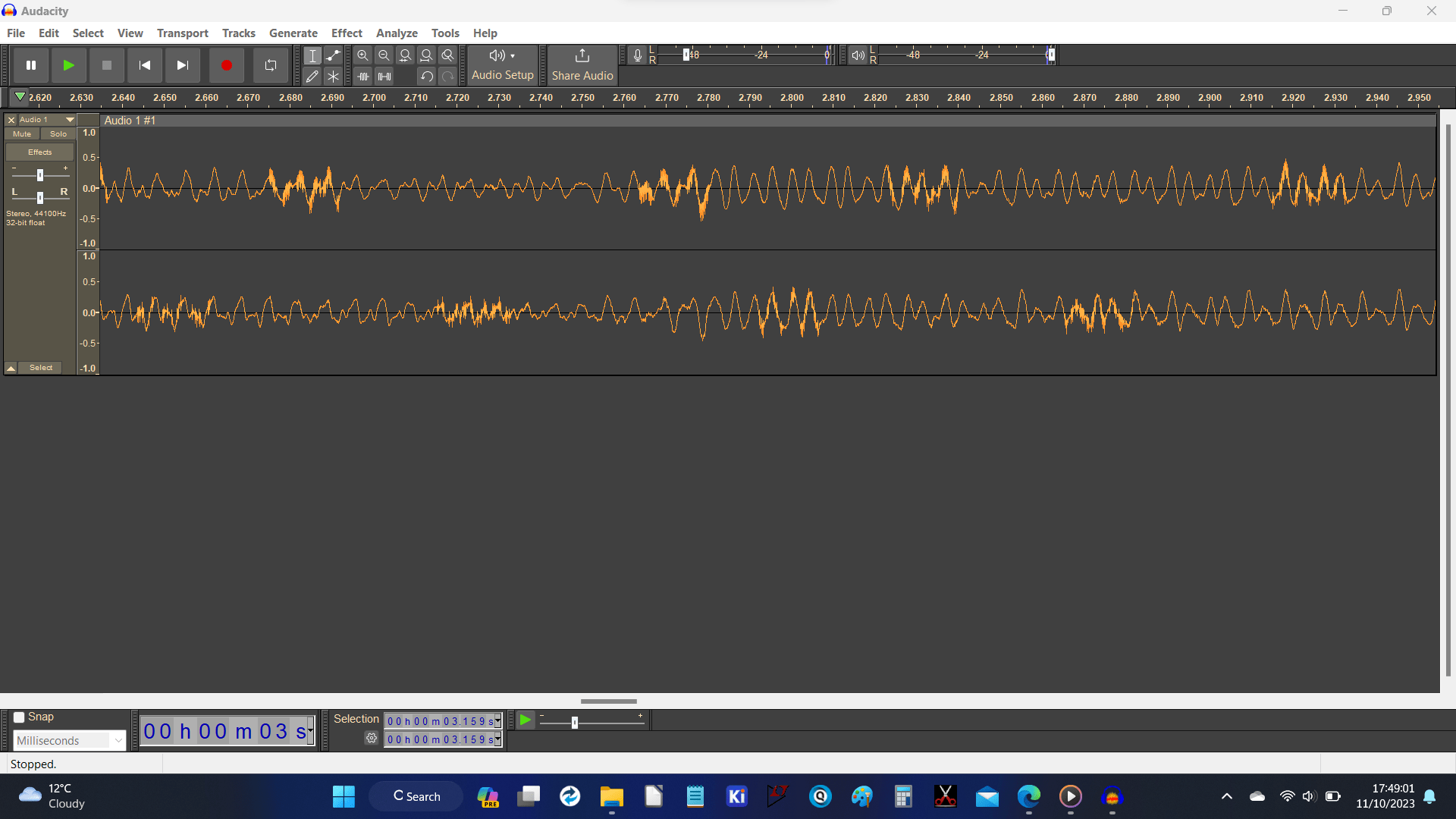

That is very weird, its not like anything I've ever come across. Its so regular. I've just swiped that track into Audacity and you can see the noise as burst of high frequency noise superimposed on the audio, first on one channel, then the other but it is so regular.

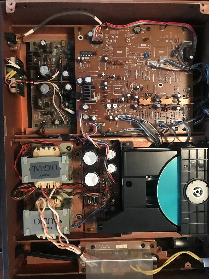

I took a very careful look at the circuit boards top & bottom. Looking for visible component damage, solder problems "loose screws" etc. I noticed three ICs sitting below copper heat sinks. Especially IC 103 seemed hot to the touch. (Fluke temperature probe):
IC 102 Focus Tracking Coil Drive 137 deg F
IC 103 Sled Tracking Coil Drive 164 deg F
IC 104 Speindle Motor Drive 110 deg F
That doesn't look right.
My repair manual isn't a very good copy. Can't read voltages very well. I'll look for better. Fact is, my ability to troubleshoot this equip't is about zero.

The fault doesn't come across as a laser issue, they just don't fail in ways that would generate that kind of problem.
Those temperatures are warm to hot but that could be normal although 164F (so 73C) is getting up there, particularly when you factor in having the covers on.
I've no quick and easy answers I'm afraid. Unless you have a decent scope you are not going to be able to do much and a scope is the first thing I would throw at this by looking at all the rails and seeing if I could pick that noise up in some way and in some form somewhere in the circuitry whether that be a rail or drive signal to something. I would also look at all the grounds with a scope as well.
