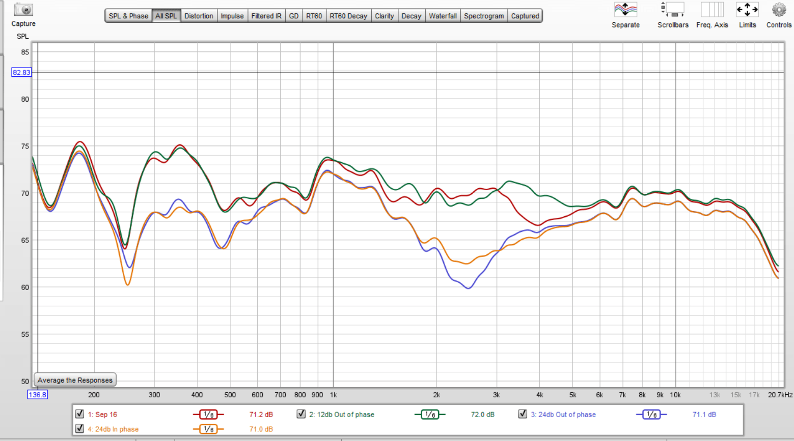

Hey guys, wanting to experiment a bit with my active 3 way speaker driver integration. I'm currently running EQAPO and utilizing stacked filters to achieve what I believe is 12db, 2nd order high and low pass filters. This seems to give me good integration with in room response (can't measure outside due to equipment limitations).
My filter settings are quite basic, just picked some easy xover points, 300hz for woofer to mid, 2.5khz for mid to tweeter. I've attempted to utilize higher order filters but always run into dips at the xover points when utilizing the same xover points as the 2nd order filters. Am I correct in assuming that one would need to set the xover points for the drivers so the frequencies overlap? What I mean is that instead of 300hz LP and 300hz HP, I would have to something like 350hz LP and 250hz HP?
My current crossover does appear to give me good integration, I've attached an image. I'm just curious to test the benefits of higher order filters.

Ideally you want both high-pass and low-pass filters at the same frequency. The stated frequency is the -6dB point where the two halves of the filter will sum to full level.
Filters affect the phase as well as amplitude, so for example with a symmetrical 300Hz 2nd order (12dB/Oct) high-pass and low-pass, one of the drivers will need the phase inverting beause the filters make them 180degrees out of phase. If you use 4th order (24dB/Oct) both drivers will be in phase.
As well as the filter phase, also the position of the drivers will have an effect on the timing / phase of the sound. One way to check for alignment is to invert the polarity of one driver so you get a dip and then tweak the delay on the closer driver (usually the tweeter / mid) until you get a maximum dip. Then you flip the driver polarity back to normal and it should sum optimally.

Doing a quick a comparison of 12db vs. 24db filters, the 12db seems to sound much better to my ears. It does measure better still, I tried applying some delays to the mid and/or tweeter but couldn't get rid of the dips at the xover points.

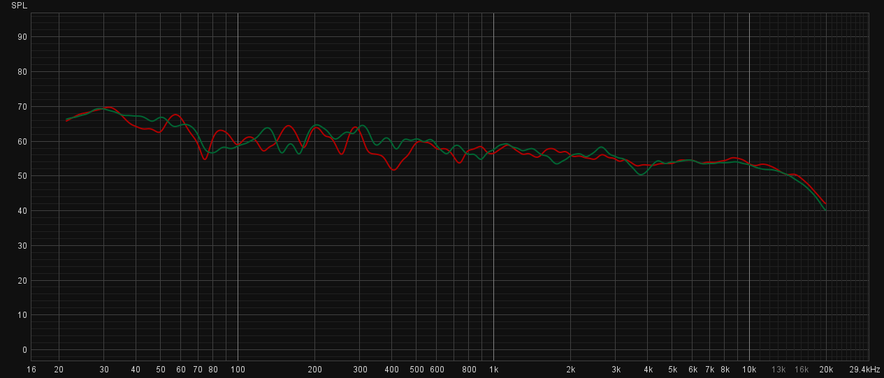

This is what I'm getting with some filters. 2.5khz xover point.

Higher order slopes sometimes have a strange tendency to make it easier to create mistakes like this when you do a without measurement style crossover. I'm basing that on the way you're not simulating with the measurements or using them to sculpt the filters.
How far out of phase are they at the cross.. since this will give you some clue as to the problem? and we can go from there..
You said you got a null when inverting the driver polarity - that's good! Do that, then adjust delay until you can maximise the depth of the null. Then flip the polarity back to 'correct' and the dip should have filled in a bit. The delay needed can be very small, like 0.1ms.

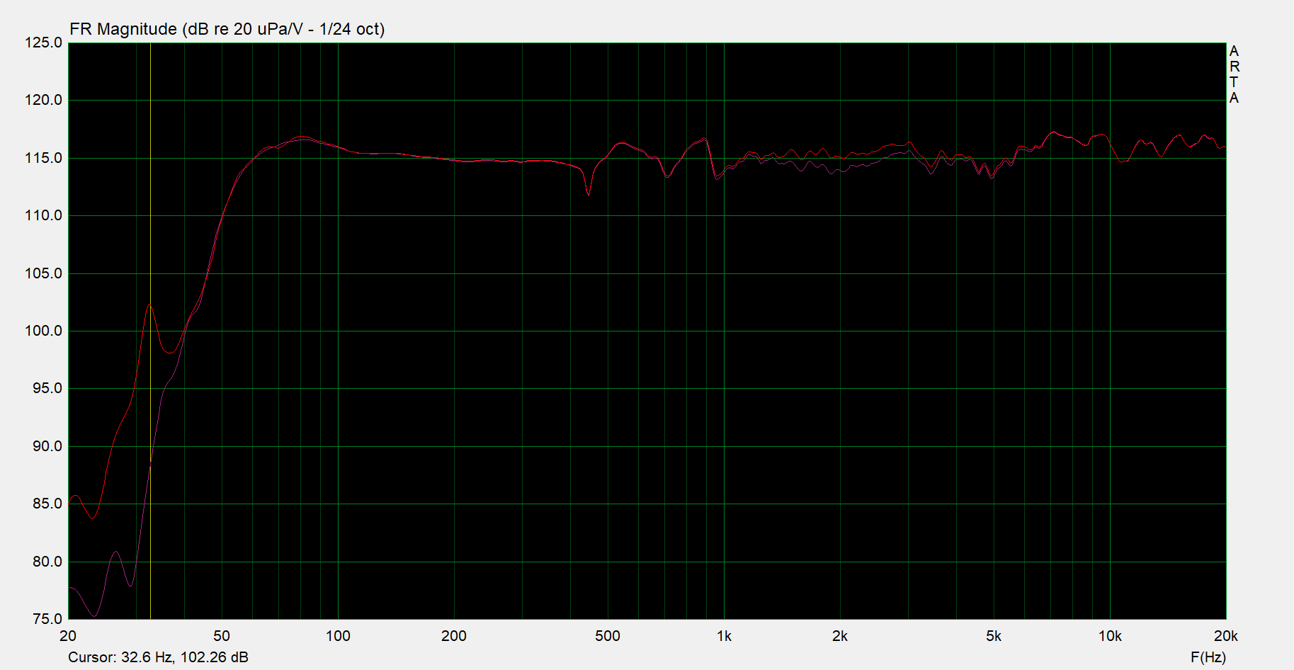

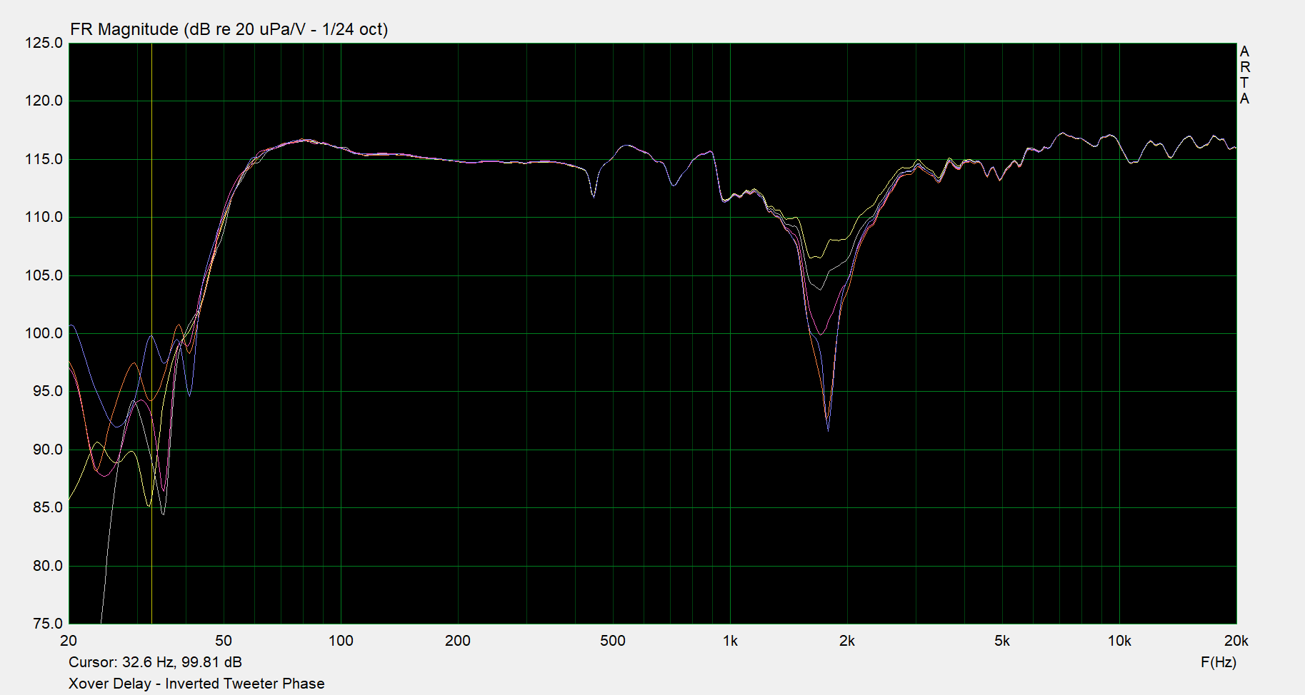

I was working on this today so thought I'd share. Here you can see the combind respose of a LR24 xover at 1.7KHz with the tweeter polarity inverted. The top yellow trace is with no delay, then going down you see added delay to the tweeter in steps of about 0.03ms (1 sample steps at 48KHz sample-rate).
Combined response with drivers "in phase" before (purple) and after (red) the delay. The offset between the drivers is rather small here and the effect can be significantly more noticeable in other designs.
