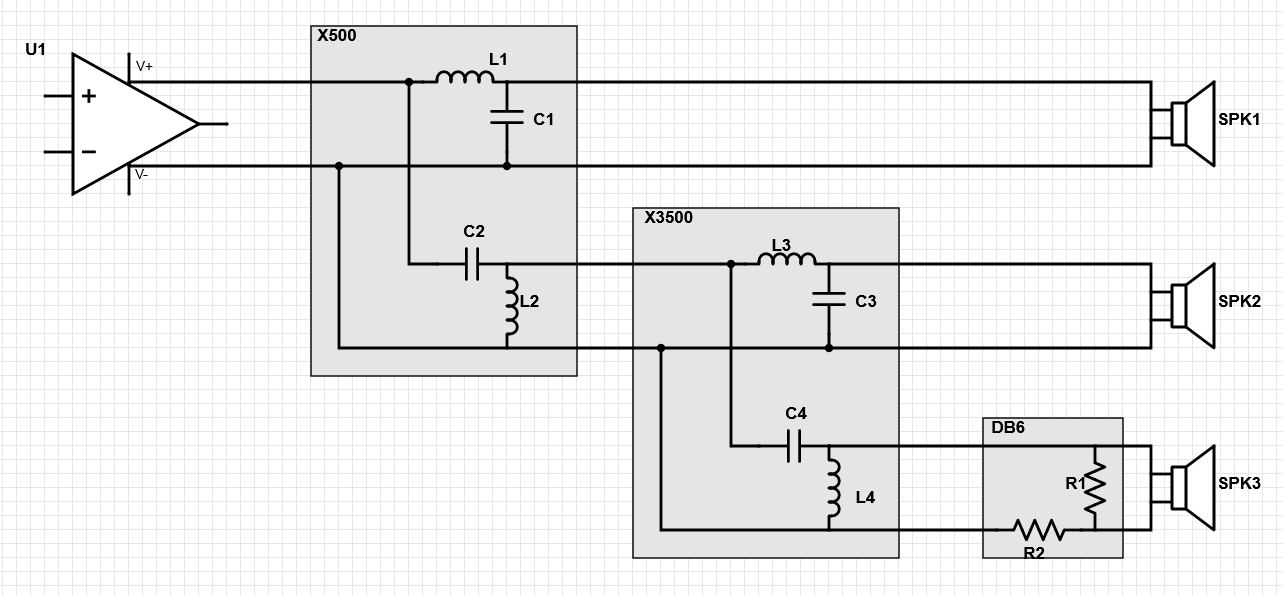

Hello guys, thanks for the response.
I think I need to clarify a bit more.
First of all, forget about the shelving question, ill take that in the full range subforum, its completely unrelated to this project.
Secondly, regarding L-Pad vs resistor I see that using serial authentication only will mess with the crossover, given the formulas for RC and RL circuitry the RC will infact increase the crossover point on a first order HPF however the parallell RL will actually lower the frequency point, so I cannot expect what to get here. Ill avoid it completely and just use a fixed LPad to match the bass driver sensitivity.
Then back to the topic of 3 way crossovers and the project itself.
The APT50 driver is a left over from a previous project.
Some time ago I bought Eminence Beta10CX and APT50 and some crossover parts calculated online only. The project never finished as I struggled with the filter design (some other thread, I gave up).
I should also say that at that time I also bought Beta12CX and ASD1001 with the Eminence 2,5X crossover above mentioned and I'm very happy with that system.

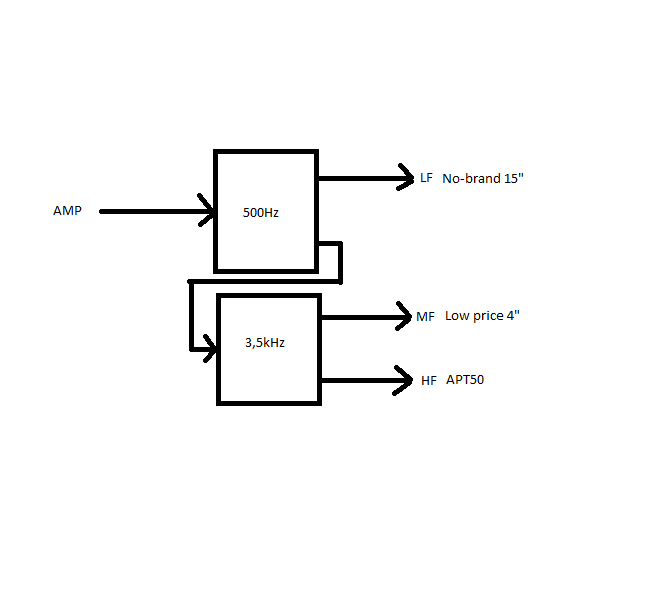

Now I want to use the APT50 leftover driver in a 3-way system with a no-brand 15" driver I have laying around. I have absolutely no information about that 15" so I'm taking a bit of risk here which is why I want to have a variable LPad on the HF. It seems like a standard rugged PA 15" so I'm assuming the sensitivity is 95-98dB. Its labeled 8 ohm. Pictures attached. I have a small bullet horn for the APT as well so I excect close to 105-110dB - a nice 10dB LPAD should be fine.
This is a low cost project using spare parts for the most but I need a cheap 4" midrange as well, and a 3 way crossover as I'm sure the bass driver have ugly mids. Now here is the question. As this project is most likely to fail I want to be able to reuse the crossover in future projects, and that's why I wonder if its possible to use 2x 2-way crossover to achieve 3-way, like we do with active PA 19" crossovers (2way stereo = 3way mono).
See drawing.
Is this possible without messing with the HPF in the 3,5kHz filter? In practicality it will be like having two filters on HF; one 500Hz and one 3,5kHz. Midrange and bass should be OK, especially if its first order I don't see any problems with this. As I dont play very loud I think first order should be OK as long as I have a protection circuit on the HF.
IF the project fails completely I can then use the 3,5kHz filter in my next project (completing the Beta 10CX or something else), or I can use the 500Hz filter in a separate cabinet for sub only (as first intended with the 15" when I bought it).
Disclaimer I am not doing HiFi, all my projects are fun-boxes primarily with some nice bass and treble to be used in the garage, basement or garden.
Hope this makes more sense.

Use a second order filter so you won't have this problem.Oops I see that the RC crossover point will half when resistance double.
Yes, it is far enough apart.500Hz and one 3,5kHz

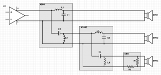

So perhaps something like this then.
Filter 1 500Hz:
Capacitors
C1 = 28.13 uF
C2 = 28.13 uF
Inductors
L1 = 3.6 mH
L2 = 3.6 mH
Filter 2 3500Hz:
Capacitors
C3 = 4.02 uF
C4 = 4.02 uF
Inductors
L3 = 0.51 mH
L4 = 0.51 mH
HF LPAD -6dB:
R1 8ohm
R2 4ohm
Will C2, C4, and L2, L4 have any conflict or issues?
Thanks for all help...

It will be OK.Will C2, C4, and L2, L4 have any conflict or issues?
You already know that using the generic crossovers is not perfect. I see you are using resistors on the tweeter. This is good, you need to work at it starting like this.
I really can't see much difference between this idea and a proper three way crossover. But I would model it in case it has some unexpected surprises, being unconventional.

You are better off using real drivers which are often 6 ohm at DC, rather than 8 ohm calculators. The impedance of a bass and a mid driver is highly inductive and this affects things.
