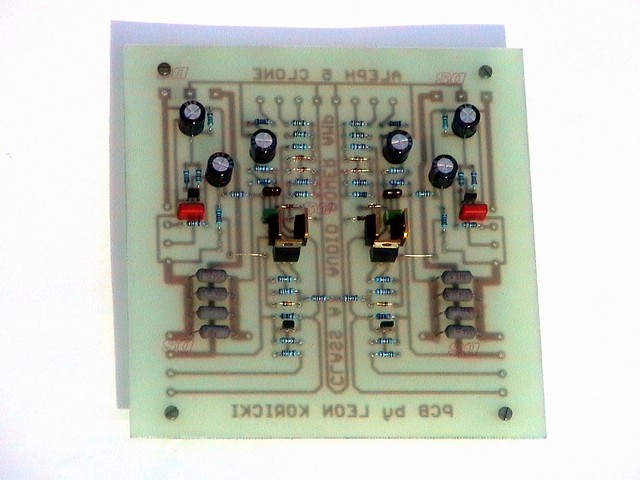

The situation is: now I have more or less everything I need for my Aleph5:
- all electronic parts;
- PCB design (made by kirc)

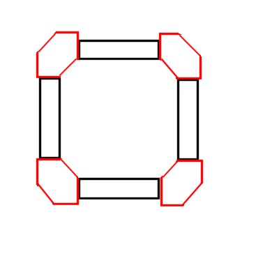

How about something like this? The black area is the heatsink and the red is a thick aluminum bar with angled corners. I doubt that you will find something exactly like the ones I tried to draw, but something similar would do to. Perhaps a square tube? Or you could make something yourselves. I once thought about doing this myself, but never got around to it.
Kermit - something like that was one of my ideas ... Except - that corners would be a bit thinner ... But - now when I see your drawing - hmm - it's worth of invest some extra money - cause it could look stunning 😀

The central pcb has 160x160
And then there will be aditional 4 pcbs: for each heatsink one - with 3 transistors each. But they are not made yet ...
