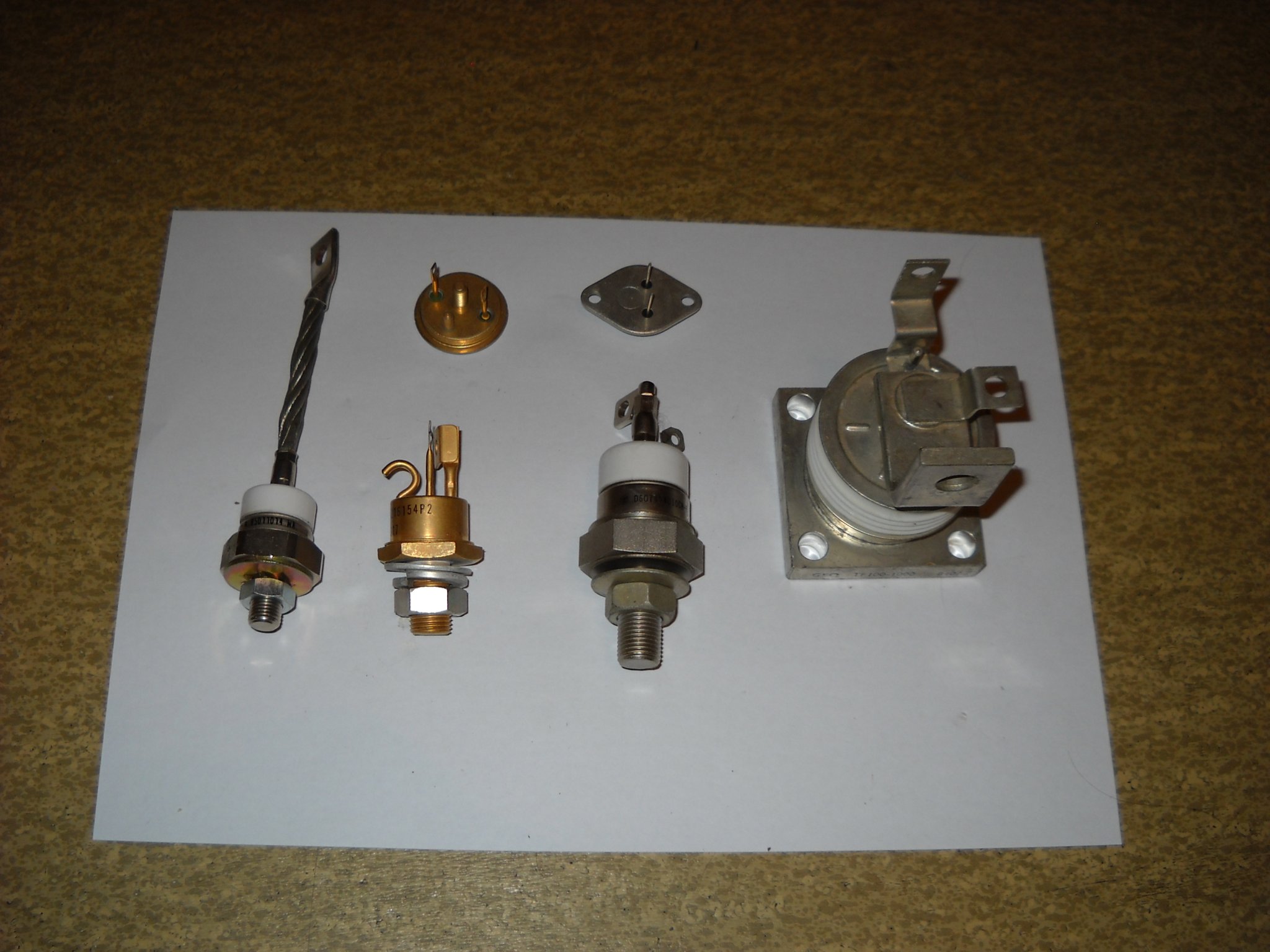

Would any of you have info about the solartron transistor 43A216154P2 ?
I have about a dozen of those and would like to put them to some use.
They are 1/2" stud mounted quite big transistors, propable high voltage switching transistors.
All i could find by searching the web was that they are obsolete aviation parts.
I really would appreciate if any of you could give me some info about them.

Naresh, the transistors are NOS, the one in question is the "golden" stud mounted type in the lower row.
That whole bottom row is more common as thryristor packages than transistors. They could be SCRs.
Thanck you wg_ski,
yes, those packages are mostly used in thyristors, but i know about the rest and they are transistors, (on the left is a rectifierdiode) the big one on the far rigth is Pd 1,5kW, 1kV 100A

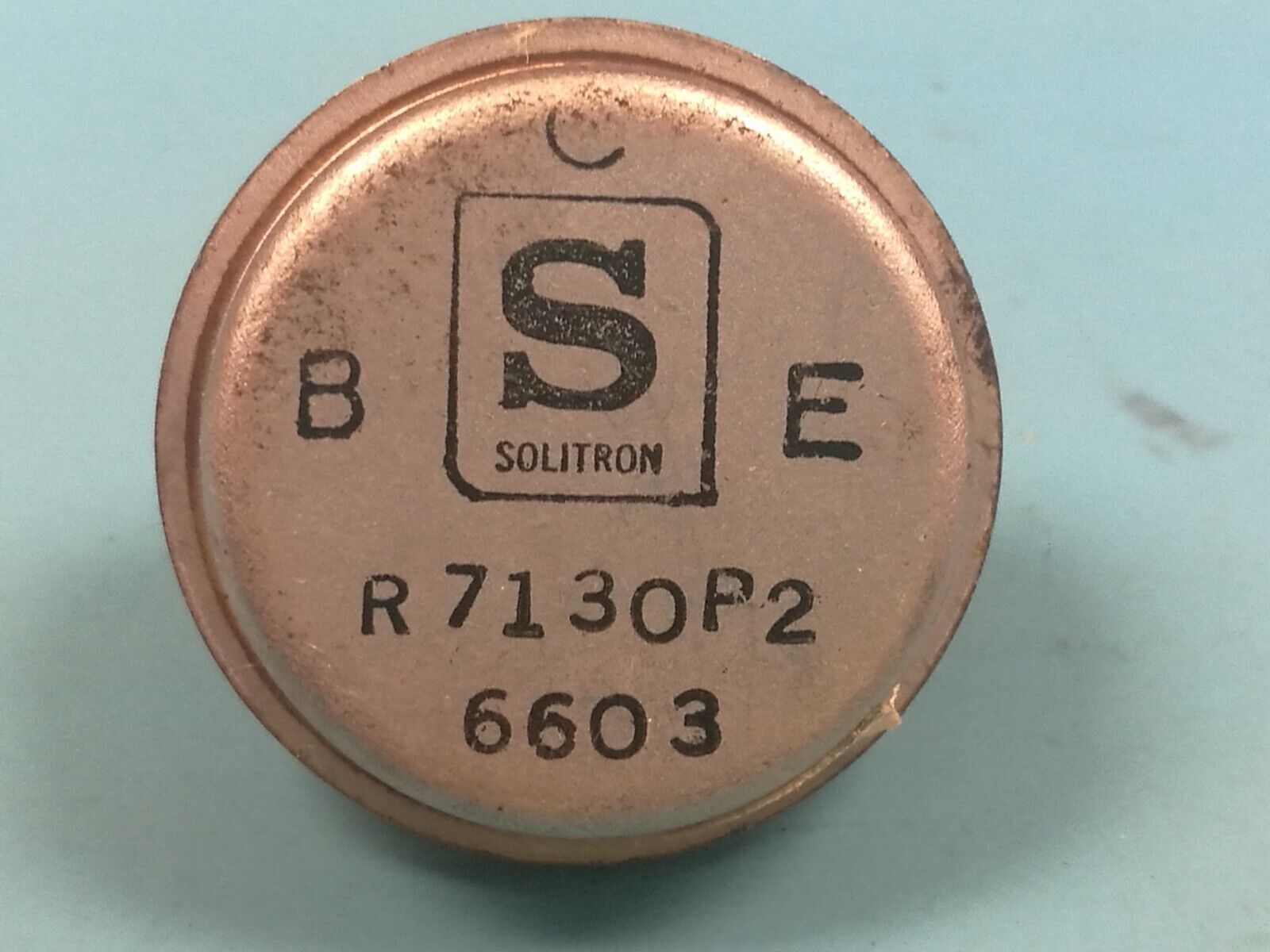

Solartron seems to be a misspelling of Solitron, maybe send an email to the company and ask.

If they are transistors they are going to be relatively low speed switching types. Maybe not much linear SOA. The predecessor of the IGBT, probably seen action in motor drives. If used in PWM, the switching frequency was probably under 10kHz. They may even have been driven by pulse transformers in half bridge, full bridge, or 3-phase.Thanck you wg_ski,

Yes, i thinck so too, switching transistors. I have some smaller ones from about the same time periond, max ft was less than 100Mhz. I got the stuff in the picture in a swap, around 1980-1990 I thinck, intended use was propable for the induction heater experiments i did in those days, cannot remember for sure...
