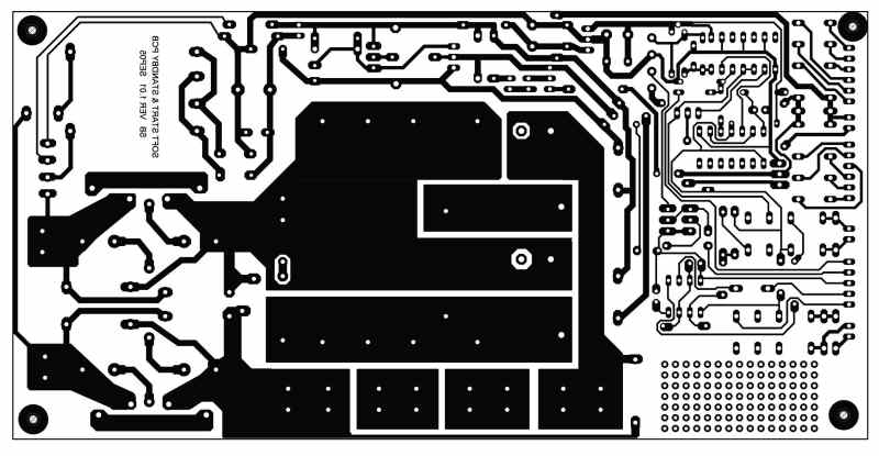

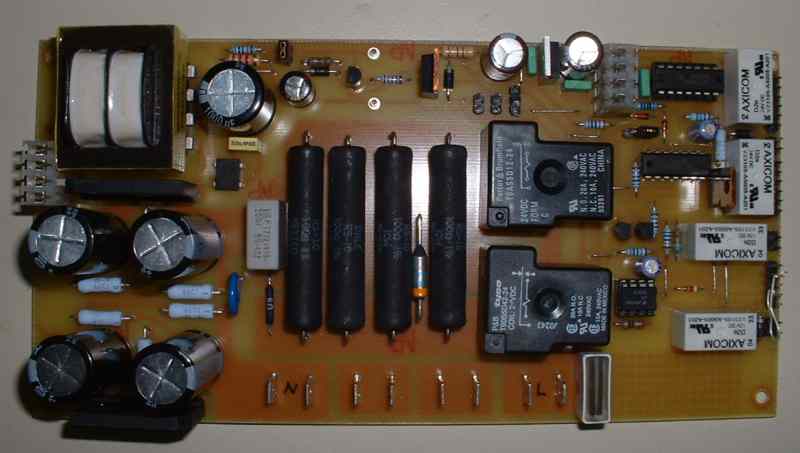

I compiled differents desings and added my own to create a nice little Soft Start and Standby circuit that can be usefull in building your Aleph.
Here the features:
The circuit is turn on by a main AC switch, possibly on the back of the amp then the softstart activate.
The softstart is the Elliot Project 39 version. A nice feature is that a small rating external switch can be used to turn on/off the amp from the front, it connects instead of a jumper on JP1.
Two nice additions are a safety feature of the soft start, a thermal cut off fuse, that will be mounted between the power resistors. It prevents any catastrophic failure.
The circuit can also power two 12Vdc fans. Their speed can be reduced by adjusting the value of R10. The Fans can be turn on/off automaticly by the standby mode or on continuously using JP2
Then working on the same 24V supply is the standby circuit. It is operated from a front mounted switch/led assembly or by remote 12V trig on the back. It provides these features:
-Auto-reset at start-up, standby mode activated, led inside power-on switch is flashing.
-Two DPDT relays can be used to provide the standby functions. I'm planning to short the inputs and select the lowest channel's bias setting in standby. The JP1 jumper can select the relays state in standby, On or Off.
-Press the SW1 switch, and the amp turn On full bias and ready. The SW1 led turn on continuously.
The momentary switch is well debounced and don't produce any false trigger.
-A 12V remote trigger on the back can activate the power-on mode remotely.
-A 12V alarm relay option. In case on an alarm inside the amp,
an external 12V will activate a rapidly flashing led.
The over-temperature cut off can be implemented using thermostat directly mounted on each channel heatsink, in serie with the main power switch and fuse, just before the soft start PCB. The digikey part number for the cut off is: 317-1085-ND
Thermostat, 75 DegC, Normally-Closed

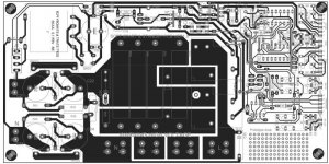

I've built the PCB (4 of them in fact) and it tested OK.
There is only a small change on the PCB. One of the AC power relays pin had to be insulated, and was not. Corrected the PCB, now version 1.01.
Corrected also a typo error on the schematic, U2 is 74LS04 and not 74LS14, it was ok in the parts list. Sorry for these errors.
Except for that, the PCB is working like a charm
Here the corrected schematic
