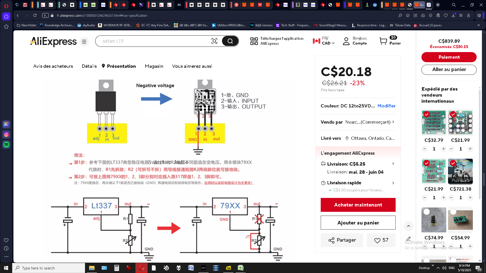

Hello, I installed that Chinese regulator and cannot get lower enough voltages. The seller don't understand because of the language barrier. It says in the add that it reaches -12 to -25 V, however I turned the trimpot and it doesn't get lower than -13.5V , I only want -12.5V max, my DC is -24V which I cannot lower.

As a master in chinglish (plus dealing with native speakers) I think some translations and meanings are not easy to understand. The regulator can be used for both LM337 and 79xx pinout (which are the same contrary to 78xx/LM317) and it is hinted to look carefully to the pinout. The LW79xx (its name!) has GND - Vin - Vout pinout and can be used in 79xx/LM337 situations but in LM337 situations R1 should be removed and a jumper for R2 should be installed. Apparently it has setting resistors onboard.

Yep, I communicated back and forth with the seller hoping he has some clue how to fix the -25V version to cover -12V, all the way it is not going further than 13.5...The aliexpress link shows -5V, -15V, and -25V versions to cover -3.3V to -45V output. However, it doesn't show the output range of each regulator. Probably, the -5V model is needed for -12V output.
It is the 79xx series where both resistors are not required... in LM337 situations R1 should be removed and a jumper for R2 should be installed. Apparently it has setting resistors onboard.
Those in the link you gave are not the same as these are non adjustable.
They are not there in true LM79xx situations 😉 and they are included on the new regulator PCB.
The clou is that the module has a confusing name. In the left picture a LM337 situation with setting resistors is pictured. At the right the “79XX” called module (yes its typenumber/name is 79XX) is used instead of the previous LM337. Then R1 must be removed and R2 replaced for a jumper. So in fact the module called “79XX” is then wired like a true LM79xx…..with LM337 or better performance (no guarantees).
In case of replacing a true LM79xx the module called “79XX” can just be soldered in. Of course someone that can apply logic would first connect it outside the device and set it to the right voltage as output voltage should not be a question mark.
It is more an IQ test/jigsaw puzzle than a regulator the way it has been advertised, called and pictured in a schematic 😀 High risk of damaging stuff when soldering in randomly.

With regards to the insufficient output range that will likely be a 1 resistor affair. Try/experiment off board with a test PSU that has a current limiter.
