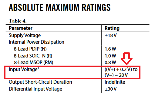

Hi,I'm still confused. If all of that is true (figure of speech - I don't doubt that it's true), how is a single supply op-amp defined; how do you differentiate between a single supply op-amp and a dual supply op-amp?

If you operate it with single supply (-V=zero and +V) the input common mode can swing from -20V to +V+0,2.
Very unusual to allow CM to go -20V below -V.

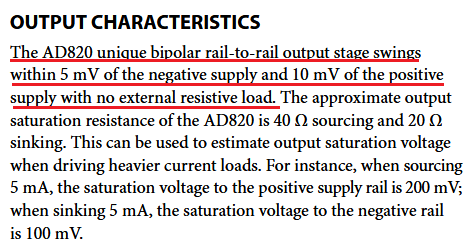

The output will be limited to the power supply. In this case, it will reach -V +5mV and +V -10mV at the output without load.
With load, the voltage drops increase a bit, but still very low drop. See specs below.
If operated with single supply, output will not swing below zero.
What you are quoting are the absolute maximum ratings, meaning it doesn't go up in smoke over this input voltage range. If you also want it to work, you have to stay between V- - 0.2 V and V+ - 1 V.
